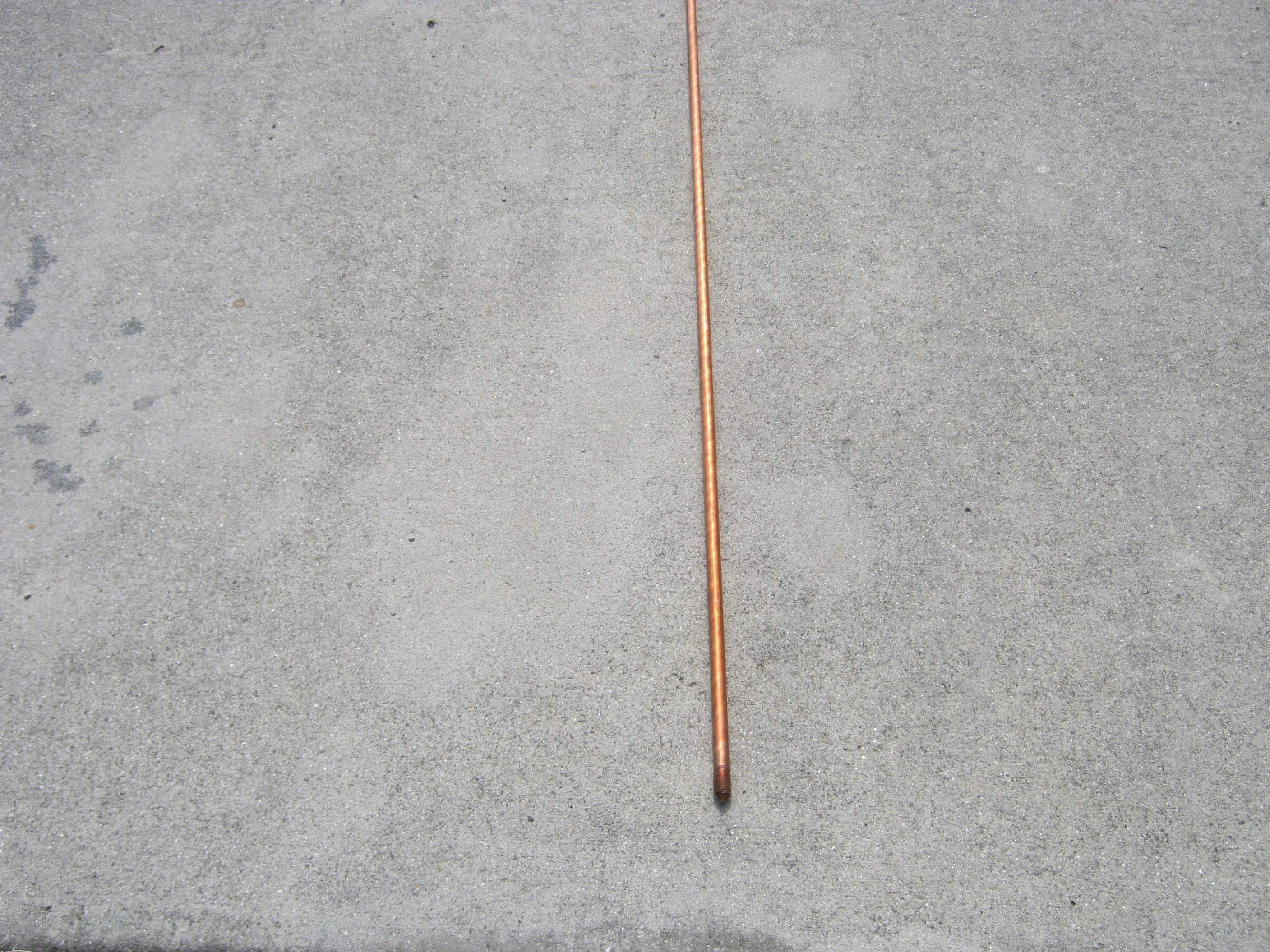

Yes Sir ! No doubt about it. I always keep a batch of 8' heavy duty copper clad rods (not from box stores) handy and might be overkill but use most of the time 3 on the charger 10' apart. Also run this type of diverter , the ceramic ones are one shot deals.
Excuse CB whips in between rod pics. Also hang warning signs in ENGLISH @ various points on fence.
