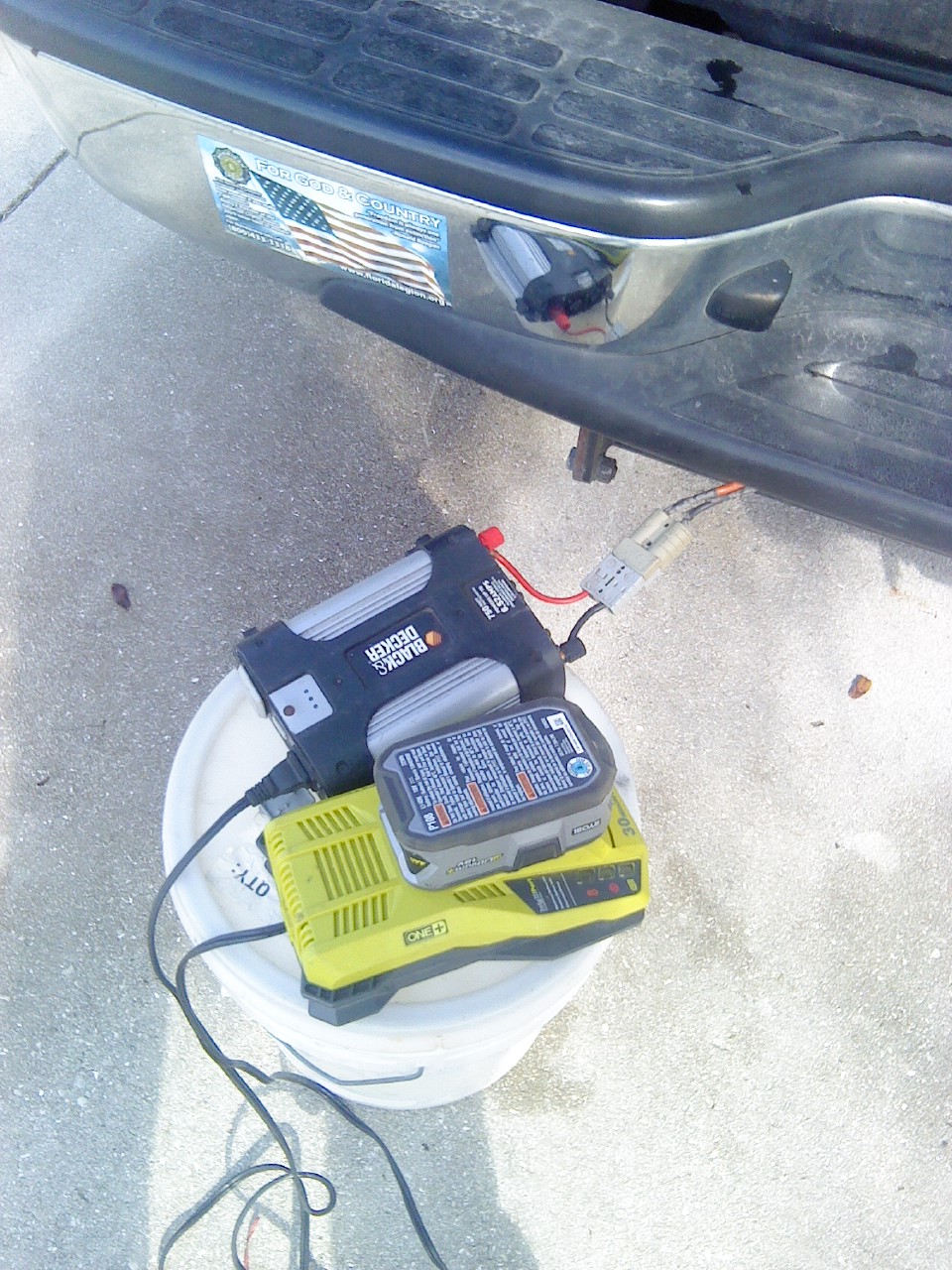

   / Electric winch on my log arch #24
I use the anderson type connectors for a couple of reasons. I have one on the rear of my truck for those times I need to charge batteries for a cordless drill or saw. Or to use the winch on my trailer.

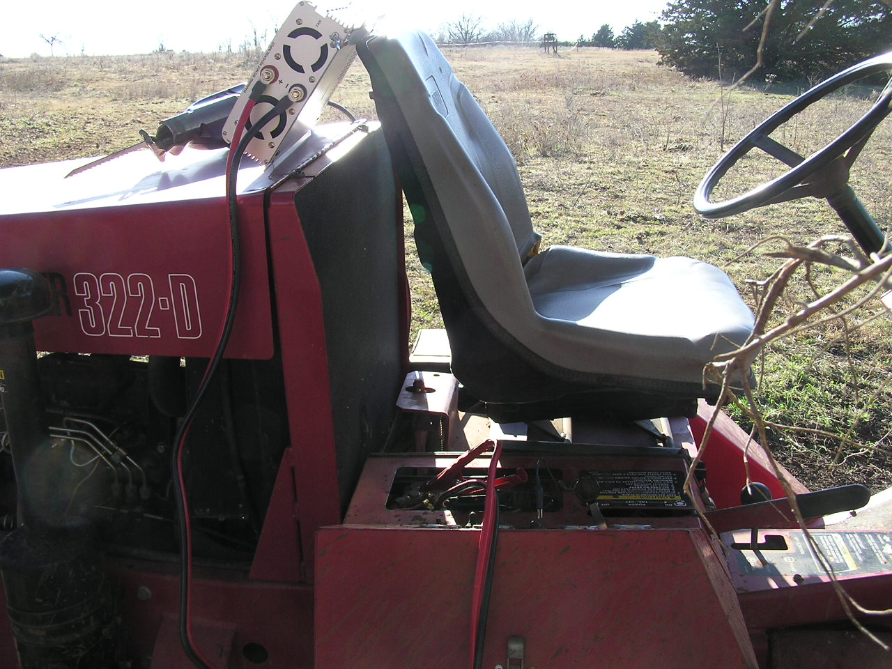

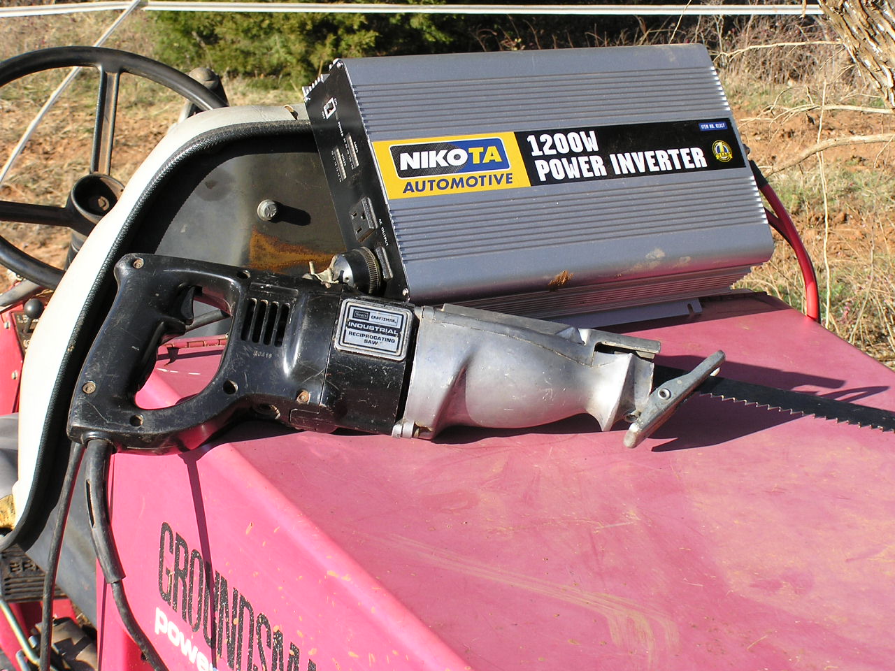

   / Electric winch on my log arch #25
Seeing your inverter brought back memories from ten years ago.

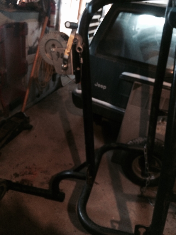

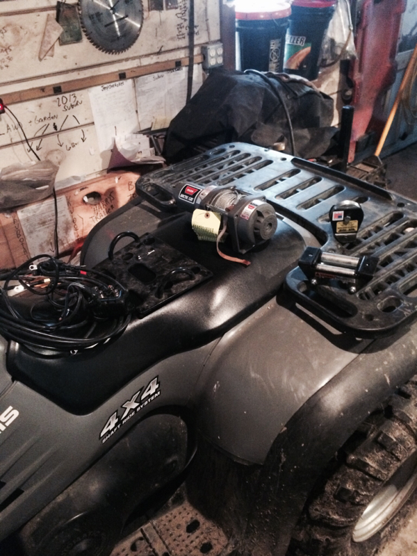

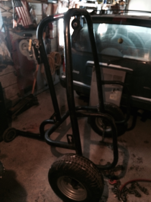

#26
Pics before i start
#27
So im building a plate to protect the winch and operator.i suppose i could put the aux batterys down low too on back side,if i did this and rolled this thing would i be ok having the batterys laying sideways until it gets back up or???
...or stick to plan and keep them on wheeler?
   / Electric winch on my log arch #28
If they are sealed batteries, you probably won't have a problem if they tip over. But as you've found, you're able to roll the arch. If you roll it with the batteries on it, will the batteries hit a log, break the cases, spill acid, etc.... you're the user and know what's best for your situation. ;)
   / Electric winch on my log arch #29
Flooded lead acid batteries (the common battery used in tractors, cars, trucks, heavy equipment, boats, etc) cannot be upside-down, they can and will leak acid.
You need a sealed battery like an AGM if you plan on rolling it. :)
   / Electric winch on my log arch #30
I got the connectors out of a large UPS for a computer system. They work great. I have half a dozen or so.
