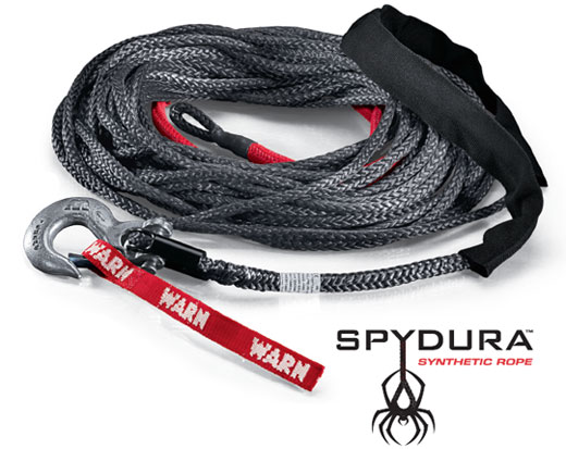

Since were talking "winches" does anyone use those nylon cable's as opposed to wire?
Are they just as good as cable?
   / Electric winch on my log arch #19
Supposed to be better, but they are not nylon.
From: https://www.warn.com/truck/accessories/warn_spydura_synthetic_rope.shtml
Spydura synthetic winch rope is constructed of a unique ultra high molecular weight polyethylene material and offers high abrasion resistance and tremendous tensile strength.
It has been on my wish list for a long time, but I don't use the winch enough to justify the high cost.
And it can't be used with a roller fairlead, it has to be this kind.
   / Electric winch on my log arch #20
I've read on the 4x4 off road forums that synthetic winch cable is also sold for marine applications. Sailboats, maybe. Anyway, it can allegedly be had from a marine supplier for considerably less $$. Now you know as much as I do.
