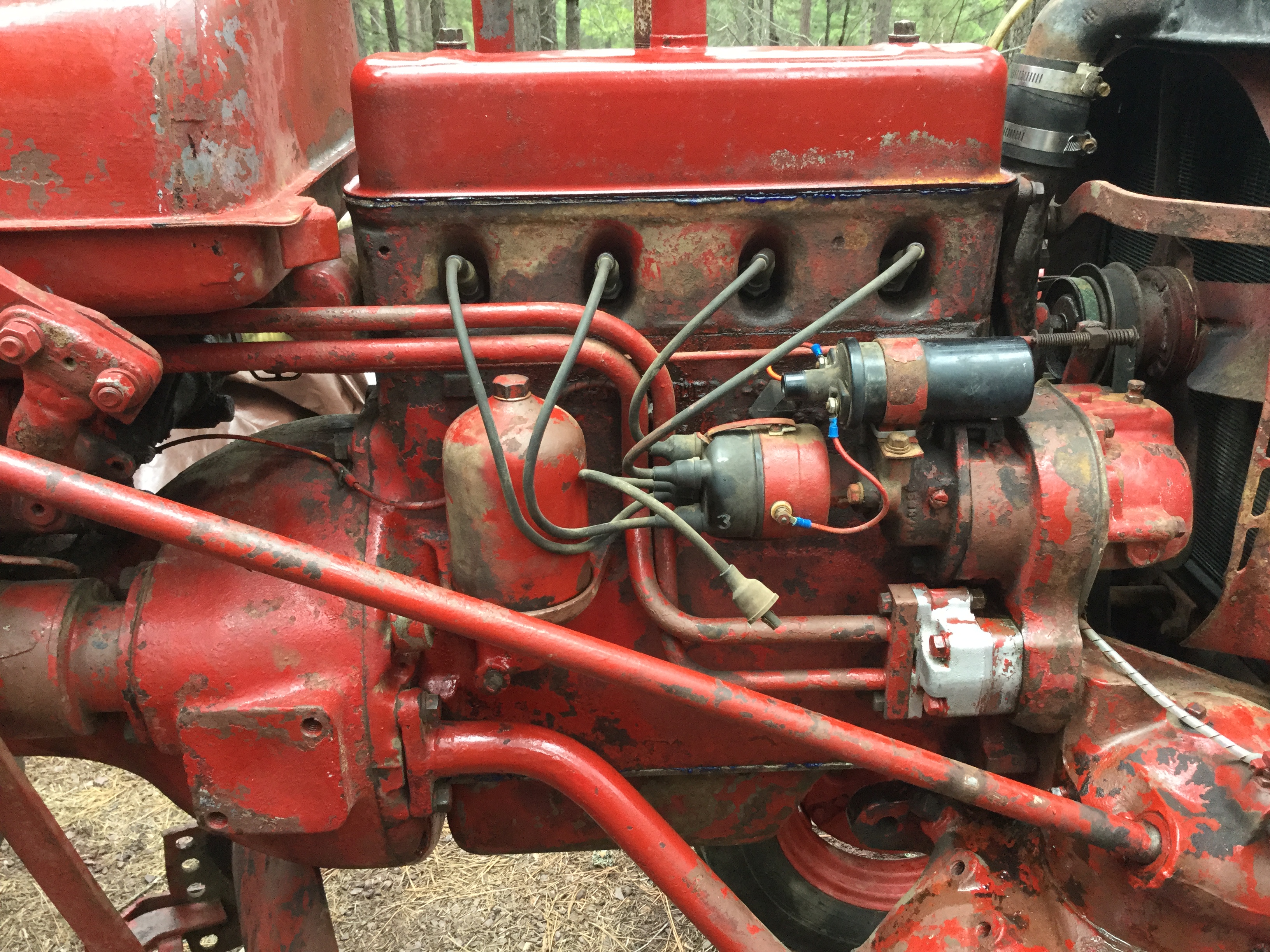

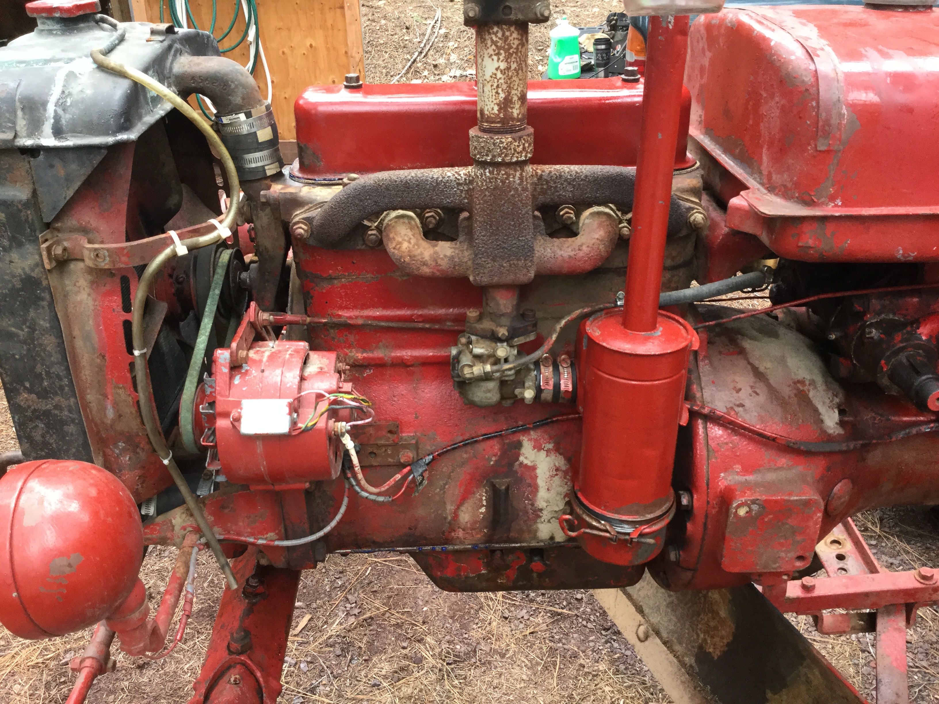

image.jpegimage.jpegimage.jpegGot an electrical problem, have no experience sleuthing DC vehicle electrical problems. I do have a volt/amp meter. This is for my 1950 Super A.
When I bought it recently, the previous owner told me that it was necessary to disconnect the battery after every use or else the battery would run down. Also, he said that he thought the starter motor was going bad because it was cranking slowly. And, I noticed that the amp meter never moves.
As you see from the pics, a 6 volt alternator was installed. I've confirmed that the battery is 6 volt.

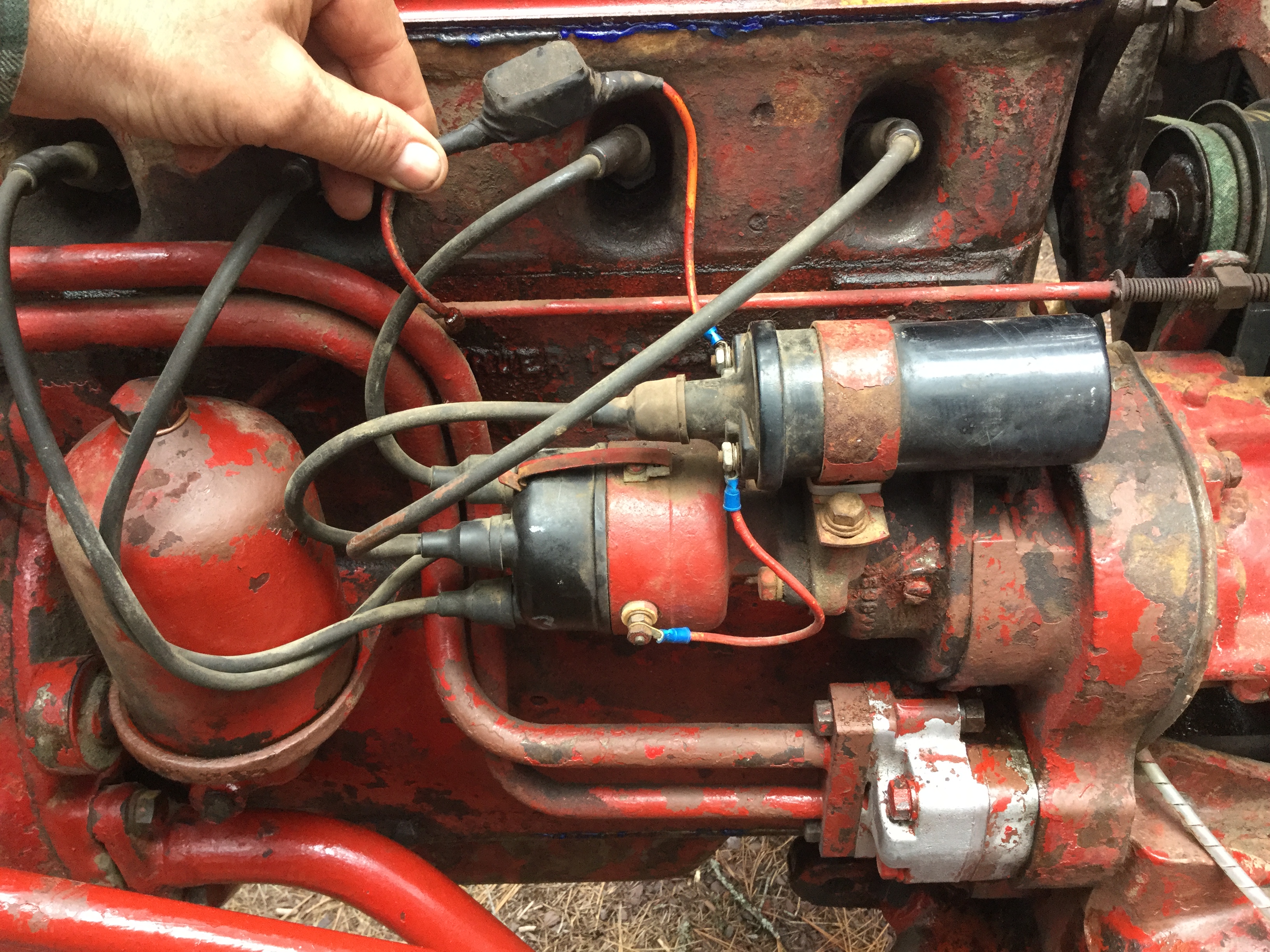

The slow cranking starter could be a low battery or it could be undersized battery cables which look to me like standard auto 12 volt sized cables.
Why would the amp meter not move at all? How do I tell if it is broken? I read somewhere that some replacement meters are, in that person's opinion, poor quality. Are there better and worse ones around?
How would you go about sleuthing the gradual discharge of the battery? I think one person suggested it may have to do with diodes in the alternator.
Got the battery on a trickle charger now, it's showing exactly 6 volts. My volt meter measures amperage and resistance.

Is you tractor positive or negative ground?
Actually, I can not really "see" from the pics that the alternator is 6v - all I see on the label is a bright square and cannot read anything it may say - and I cannot "spot" a 6v one from a 12v one just looking at the case.
That said, on many of the older systems the ammeter is connected in series with the charging circuit. You could check to see if the meter is good by connecting it directly from the battery, through the meter to a known load - it should show a "discharge". If it does not, it is probably bad - they can be bad and still allow the power to flow. Also, with the voltmeter connected to the battery it should read 6v or sightly above when the tractor is just sitting. While cranking it most likely will read under 6v and once running it should read enough above 6v that you can see if it is charging or not.
I am not sure just where the starter is, but, is it possible that the starter is 12v and that is why it runs slow?
You mention that the cables look like they are "standard auto 12 volt sized cables" - if they are, they should be heavy enough since a 12v car system needs just as suitable cables as a tractor does. When you are cranking it, does any of the wires get hot or do you smell "hot plastic"? If you do then the cables may be undersized - if not, the cables are probably sufficient and the problem is either a weak battery or a starter that needs replacing.
BTW - does the tractor run?
To locate the power drain you might try using your test meter connected to the battery. Then, disconnect whatever items/devices you have one-by-one, reconnecting each one once it has been eliminated as the problem. You should be able to read a power drain if your test meter is sensitive enough.

If you have a decent starter/generator repair shop near, they could bench test the alternator, and tell you exactly what you have, and if there are any problems. Originally, those were positive ground systems.
I'm thinking if you have a set of jumper cables, you can put them on the battery to starter, and to chassis, like the cables are, then try starting it, and see if it turns it over any faster. Kind of like a larger set of battery cables, but then not. Of course, that really depends on the battery too, whether it is up to snuff. It may show 6V, but you don't know how many cranking amps. Pretty much take a battery tester to check that.

But, the slow rolling over when it comes up against compression, is normally the tell tale sign of small cables, even with a good battery. When the 8V battery's came out, and were supposed to be the fix all for that problem, it still did it.
About 3 years ago, it was time for a new battery, and I decided to upgrade to 1/0 cables since I had inherited that tractor. All NAPA had in stock was 2/0 cable, so had them made out of that. With the new battery, and the large cables, it rolled over like my Farmall A, and my other Super C I'd done the same to 20 years ago. You'd think you were jumping it with 12 volts.
