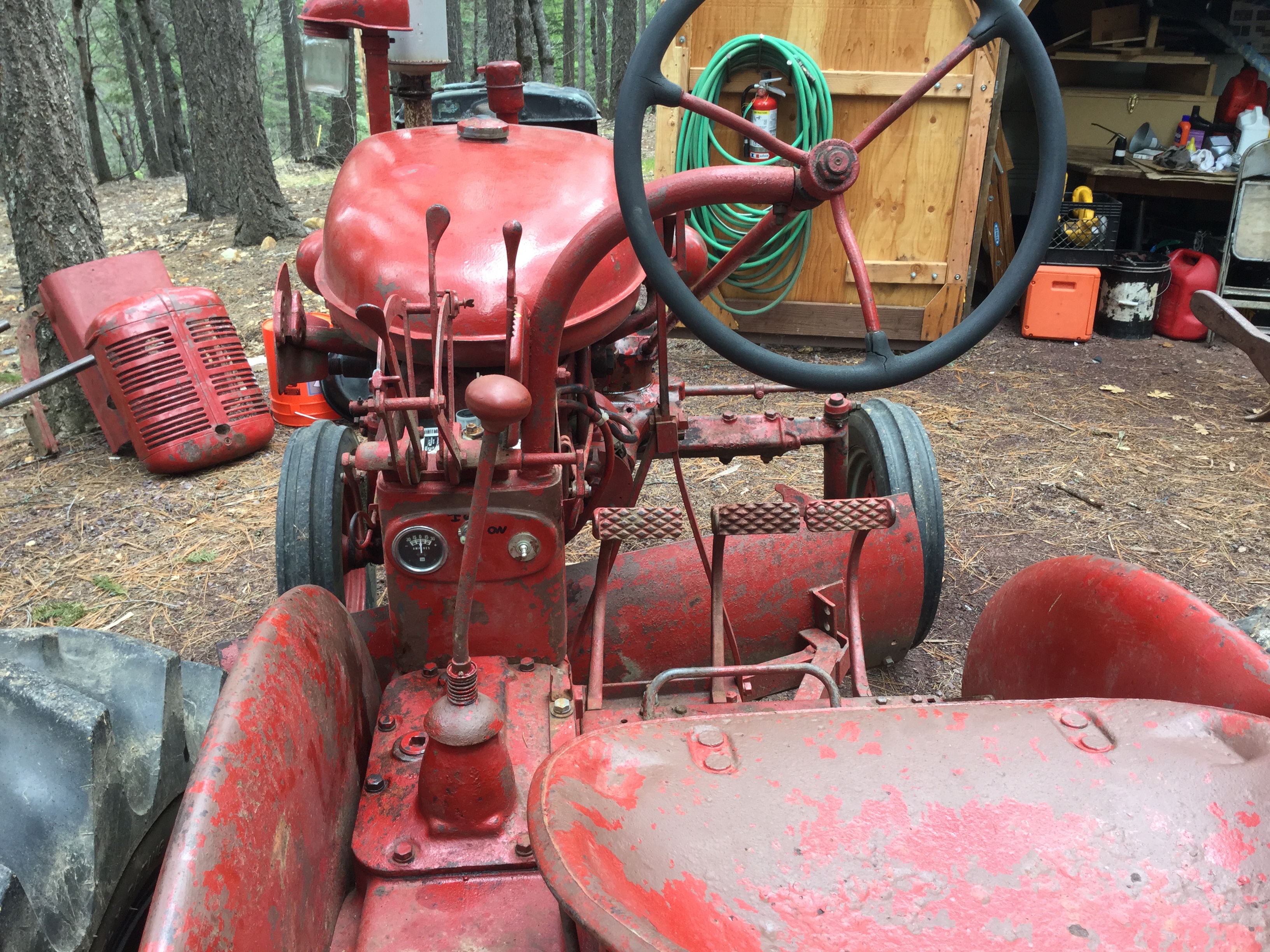

"'You mention that the cables look like they are "standard auto 12 volt sized cables" - if they are, they should be heavy enough since a 12v car system needs just as suitable cables as a tractor does.''
This above info is not correct.
'' standard 12 volt car cables'' are not fine. Undersized cables are the NUMBER ONE cause of slow cranking farmalls. The cables were undersized from the factory.
0 0/0 are what you need. Heed DJ54's words and change the cables. The smaller cables just will not flow the juice. Not saying the starter or battery is not worn, but if you are keeping the tractor and keeping 6v change the cables. I have seen cables only get slightly warm if they are not big enough.
Unless the starter was ''rebuilt'' and changed farmall did not make a 12 v starter that would fit that A. The alt if it is self exciting needs a diode in front of it or it will draw the battery down. It's a simple system so get a meter and start checking.
Disconnect everything and try a 12 volt battery see if that works
Edit I see what I think is a voltage reg on the alt. The excite field may be stuck open causing the drain. There are only a few things that draw on that machine so check them . (ignition, charging, lights)

12 volt coil with 3.5-4ohms would do the trick.

As for the resistor ahead of the coil, I'm wondering if that is already what you have on yours. All I've seen available for tractors is the porcelain type, like what was on the old Case I had to replace. Being me, I'd have to untape that rascal, and see exactly what it is.

He puts a resistor before the coil to knock down the voltage to 6v. Can you replace the coil with a 12v?

Isnt that a resistor shown in the pic?

Dont use service entrance cable for battery cables. TOO stiff. The individual strands of of wire are much larger diameter. Go with welder cable as others suggest, as it has much finer strands and a softer insulation that make it alot more flexible. Just did the battery cables on my backhoe with 3/0 welder cable and I am happy with the results.
As for whats in front of the coil, take the tape off. Could be a resistor, allthough with a 6v battery already I dont know why.
Not sure if an analog meter is sensitive enough to tell the difference between 6v and 6.2v. Personally I would get a cheapy digital. And if you can find one, a DC amp clamp is nice. Clamp it on a battery cable when attempting to start and see how many amps that starter is trying to pull.
Lots of stuff to check out. But for sure get some heavier cables. As someone mentioned earlier, if you own a good set of jumper cables, connect them as if running a second pair of battery cables and see if it makes a difference. Then continue with the rest of the stuff.

I'll unmask the mystery box ahead of my coil soon as I can, and send a photo. But why would they put one on when they were keeping 6 volt?.......
