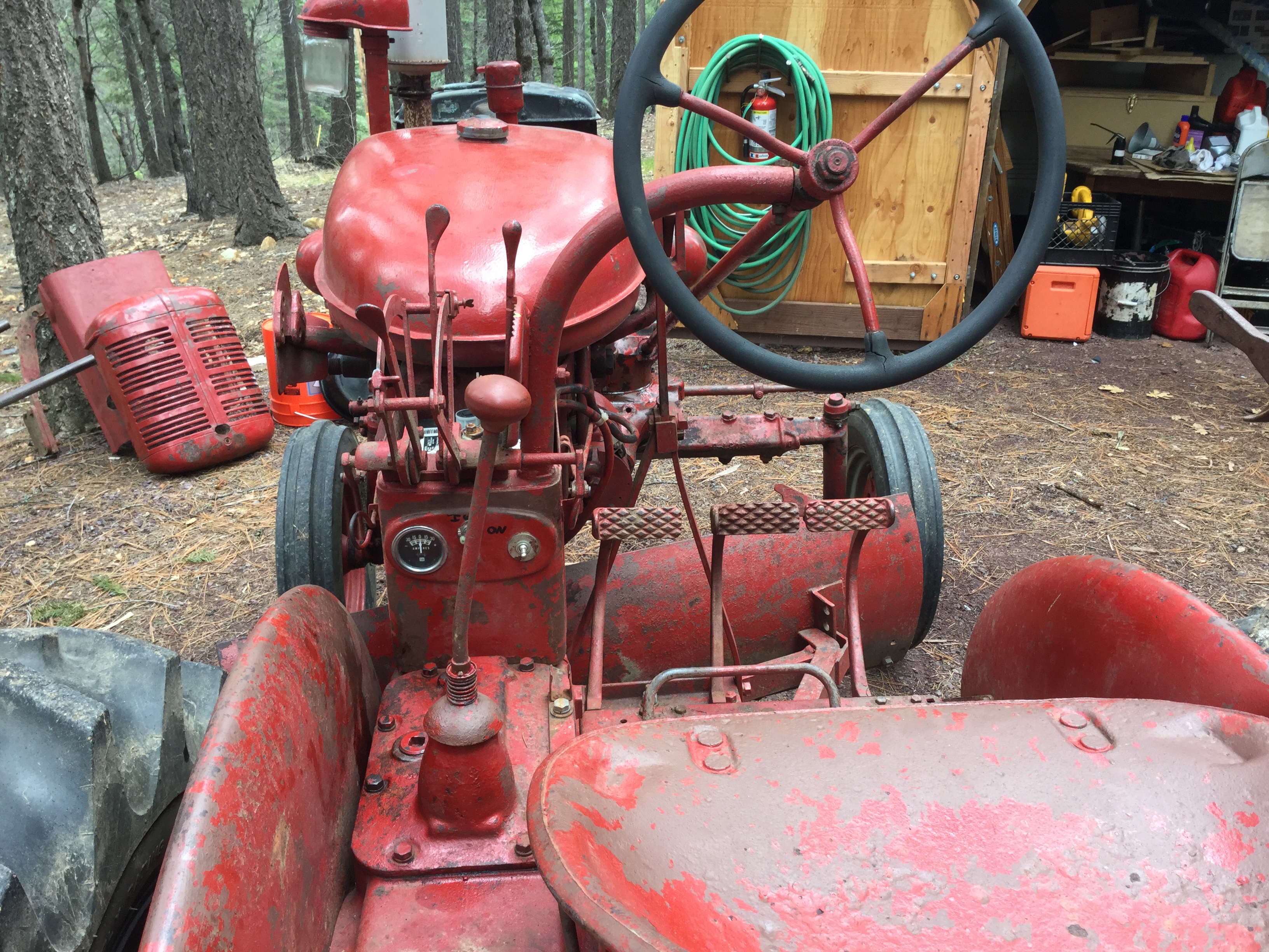

image.jpegimage.jpegDon't know what switches this tractor originally had, but here's a pic of what's there now. No decals. The picture completely hides a third single-toggle switch (behind gear shift) the function of which I don't know and haven't bothered to trace yet. Toggle on right is front lights, no other lights. No 3 or 4 position switches, just toggle for ignition on/off and toggle for lights, no switch or space for one below the ammeter.
Did these units originally have a fuse? What did it protect- lights, ignition?

Bottom right hand corner exploded view shows the mounting bracket the amp meter is in, from the back side. Official Case IH Online Parts Store and Case IH Catalog for Best Parts Search and Best Parts Look Up. Case IH Parts for Case IH Tractors, Case IH Combines, Case IH Tractors, Case IH Manuals, Case IH Parts Looks like the light switch was far right, and ignition switch, and fuse holder, was in the center holes. The fuse holders are the twist lock cap type.
There were 3 different light switches for the Super A, at different serial number breaks. Official Case IH Online Parts Store and Case IH Catalog for Best Parts Search and Best Parts Look Up. Case IH Parts for Case IH Tractors, Case IH Combines, Case IH Tractors, Case IH Manuals, Case IH Parts Note the pigtail "coil resistance" something, listed as #1 in the parts list.

I bet the coil resister is how they achieved dimming the lights.
I guess the fuse was protecting the lighting circuits, how many amps was the fuse?
   / Electrical sleuthing #27
Parts list says AGC 20 amp.
