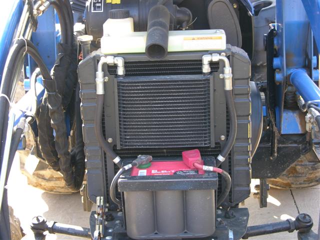

We won't know if the curved pipes with the straight hoses is a better solution until someone has had it installed for a year (that's about how long the curved hoses last). Or have the Class IIIs used the curved pipe solution all along? I'm not as familiar with the Class IIIs.
   / Eliminated The Battery Problem? #12
Mike I have no experience with Class IIIs before 2002 however this is the setup that is used on our particular run.
   / Eliminated The Battery Problem? #13
Is my 7610s the only tractor that uses what looks like 2wire or 4 wire hyd hose for the oil cooler lines? Mine are still good.. no signs of any decay / leak.. unit is a 2002.
Soundguy

#14
<font color="blue">...however this is the setup that is used on our particular run. </font>
Looks like a much better solution than what's on the Class IIs.

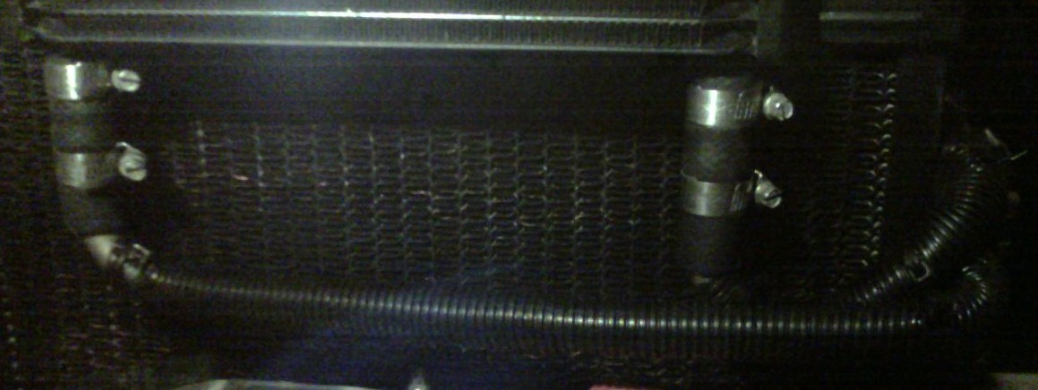

   / Eliminated The Battery Problem? #15
wonder if you could get a picture of new hose setup. My TC 29d has replaced elbows 2 twice now. Dealer knew of the problem and kept an eye on them as I have them service the unit every 100 hours. Now has 1100 hours on it. Lets see; 1100 hours ; replaced hoses 2 times; that is 366.67 hours per hose. This is a 1999 unit. I have noticed that each time the elbows were replaced they would begin to leak after getting hot a few times so it is a good idea to check tightness of clamps after running it a short time.

   / Eliminated The Battery Problem? #18
The larger frames have a much better setup. The curve is metal and it looks like the hoses are real hydralic lines, not ballons. Be real interested in seeing a picture of the new setup. I would think straight lines could handle all the movement and vibration, just wouldn't generate extra cash income.....

   / Eliminated The Battery Problem? #20
</font><font color="blue" class="small">( wonder if you could get a picture of new hose setup.)</font>
Here's what it looks like. The metal lines are covered with wire loom. There are two straight rubber hoses running between the metal lines and the cooler.
