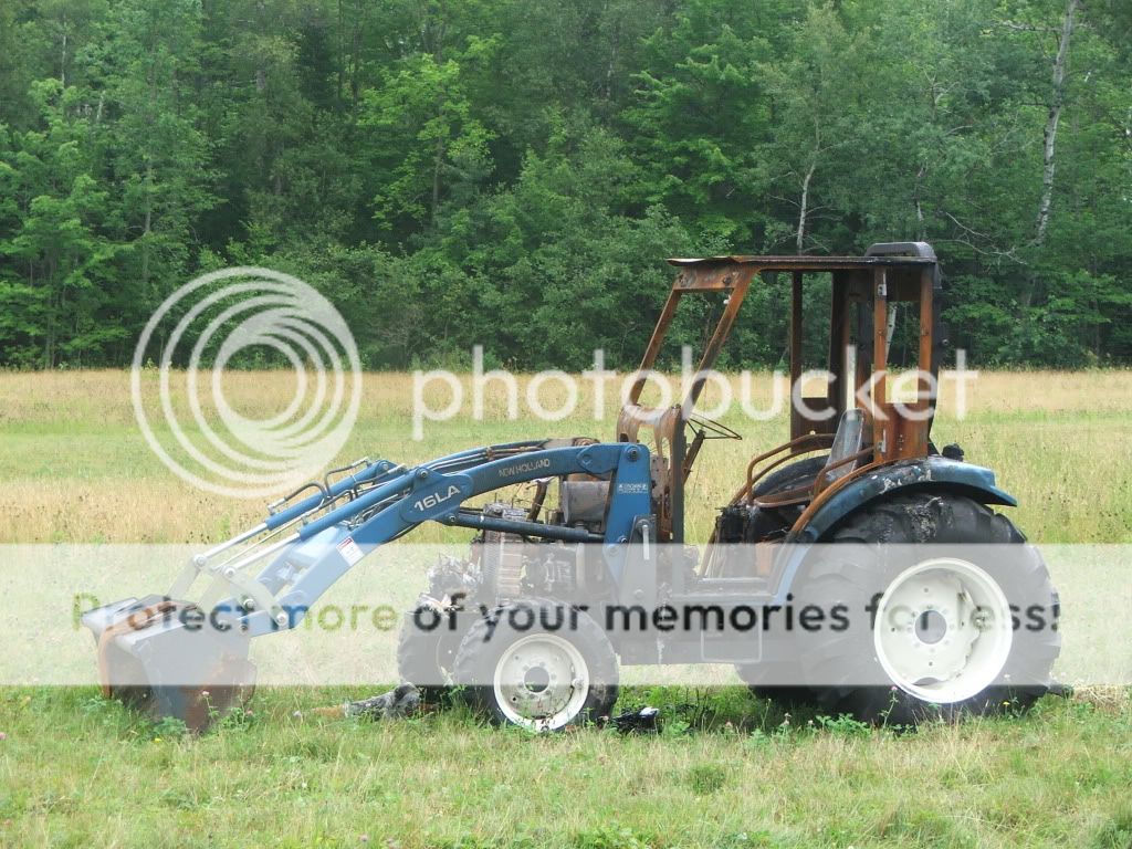

Where did you get this sad picture?
Downtown Lincoln Center, Maine. Luckily they got the two townsfolk, goat, and one horse out of the cab so there was still a dance friday night. :p
I took this picture last fall, I believe, on my way through town. Scary part is I sent the picture to my dealer with a sarcastic "2009 models come equipped with a fire extinguisher", and he said someone bought the thing and was in the process of restoring it.
