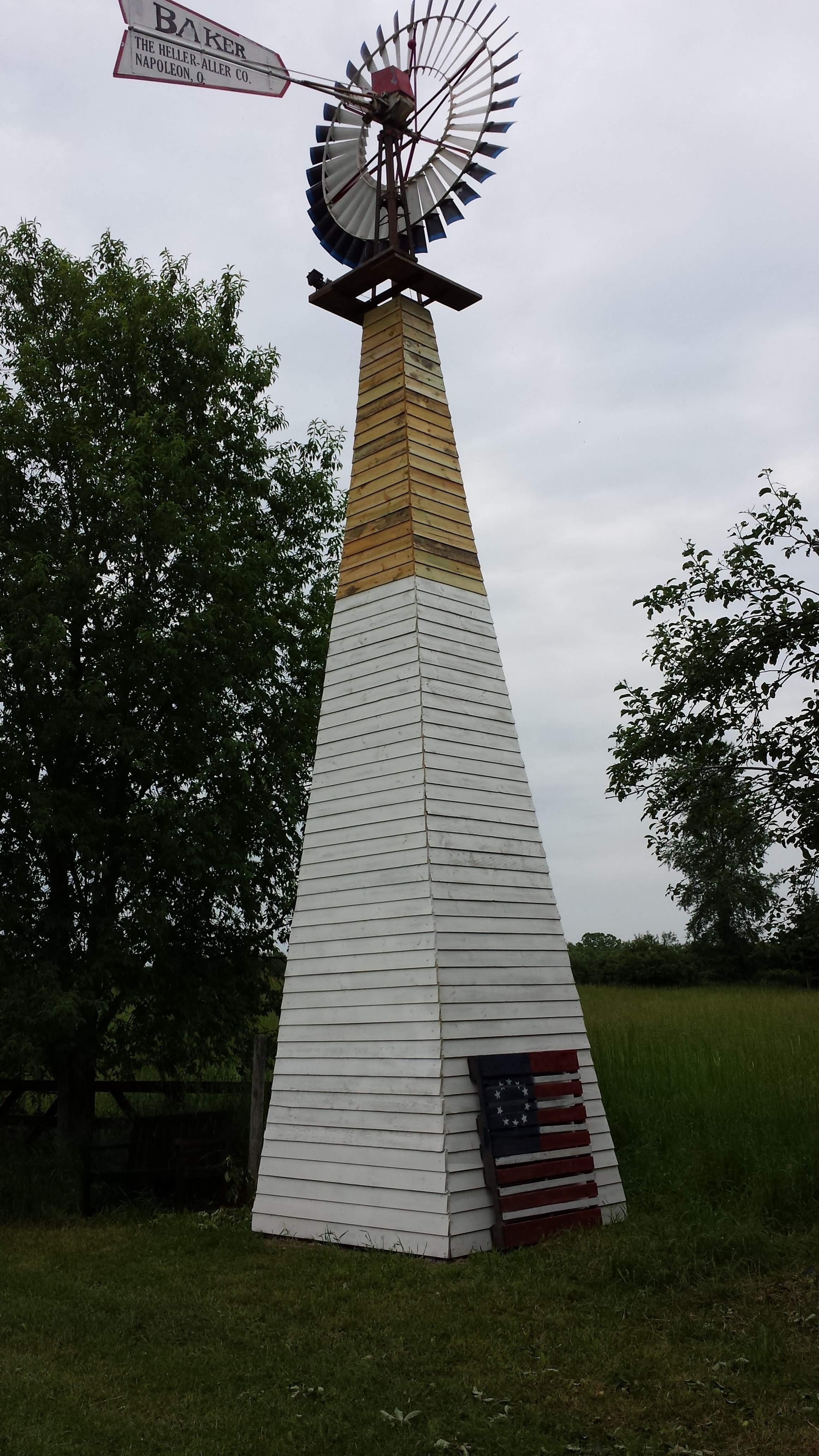

How high is your water table at the moment ? I have a bunch of these one with a 115v motor driven pump jack when the wind is low. This particular one doesn't usually freeze out here. These run around the clock so to speak. A few IBC 300 gal containers would fill up quickly.

I know of ranchers that have cylinders and sucker rod and have gas engines on pump jacks, on there wells, there method is on these seasonal wells (cattle rotated in and out of the pastures), they will measure out X amount of gas pour in the engine start it and it will run just a little longer to fill the stock tanks and then runs out and stops, some prefer this method,
one can put a cylinder on top of a submersible, so one can use both types of pumps on one well with out two pipes, there are few different methods, of setting them up,
I have both in one well on my farm and use the windmill as a primary and the submersible if the wind does not blow, or mill is down, I just pump in to a 9000 gallon tank, and boost the pressure out of the tank with small jet pump, (which could run on 115 volts) if wanted, my tank is 20 foot tall and will gravity feed (very low pressure) but will supply water to all the farm with out electricity,
