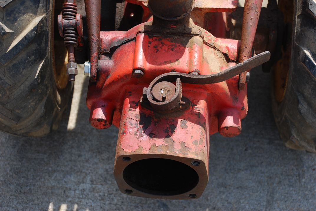

Yes, if the output is 1.5" long, then I can see how that would work. Is the Gravely engine output bearing a sleeve bearing or was this fit in by oldmech?
A related subject: I noticed that someone on eBay had a Robin OHV 9HP engine available for $275 including shipping. I looked up the torque specs and it was something around 13.8 ft/lbs at 2500rpm. It looks like a good fit for an L repower. It is not up there with the Gravely engine which is somewhere around 18 ft/lbs I think. Anyway, on an L model, if the (Robin) engine speed is limited to 2800rpm or so, is the lack of torque very noticable in running implements like the 30" mower or the rotary plow? I sure am itching to find all this out in a practical way. Spring fever, I guess!!

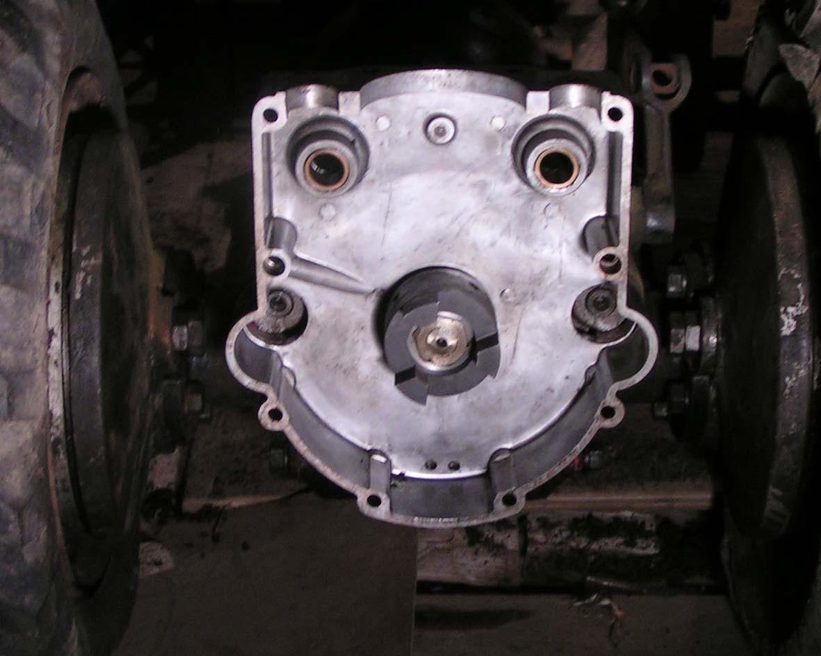

Look at the bottom of page 4 on this thread. Oldmech published a chart showing the torque and HP of the old L engine. Torque is generally about 13 - 15 ft-lb so the Robin engine you are talking about is right in that range. As for the bronze bearing, its a Gravely designed large sleeve bearing that is machined with some special characteristics. First it has a ridge running along its exterior lenght so it wont rotate in the L crankcase. Second, it has grooves machined around its diameter so oil can flow into the bearing as part of the pressurized lubrication system. When repowering, most folks do away with the pressurized oil system and go to a flooded system in which more oil is added to the tranny. Thats what Oldmech did. But notice he also added some oil galleries to allow oil to flow into the bearing by splash. Hope this helps.
   / Engine ideas #332

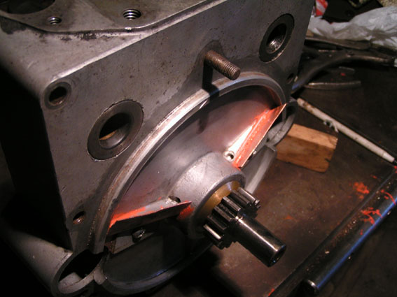

Having never seen the output I did not know what those pictures show. Now I see the "duct" and holes for lubrication. Your right, he did a great job. Thanks again for your input, One.
   / Engine ideas #333
Hi! All Thanks Oneaxepony ! Your infos are right. I use the original input planetary shaft. I dont cut ! I dismantle it from the Gravely crankshaft. The end is taper with a flat nut also a keyway.
I take the Shaft with gear, the brass bushing and a L100 5/8 flex joint bushing and go to machine shop I ask him for fit . The Young machinist make a very good job in his spare time and charge me only $80. Machine shop work are very expensive here . As $70. hour. note the flat nut is inside the flex joint bushing . I joint picts. Good luck! Oldmech

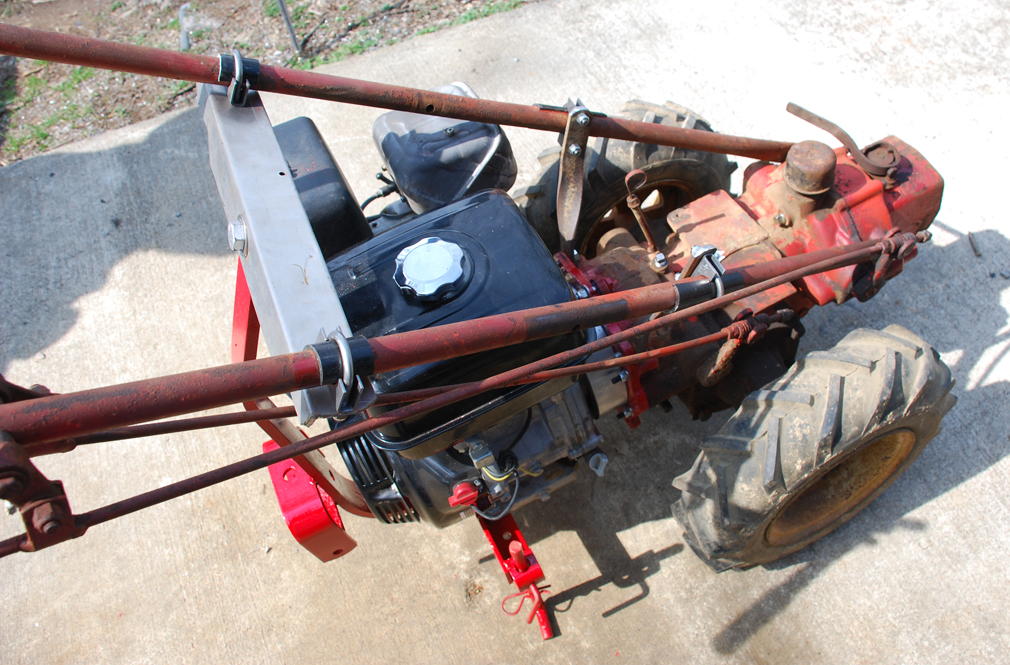

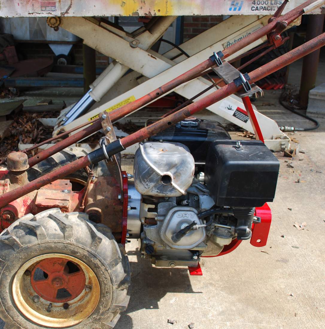

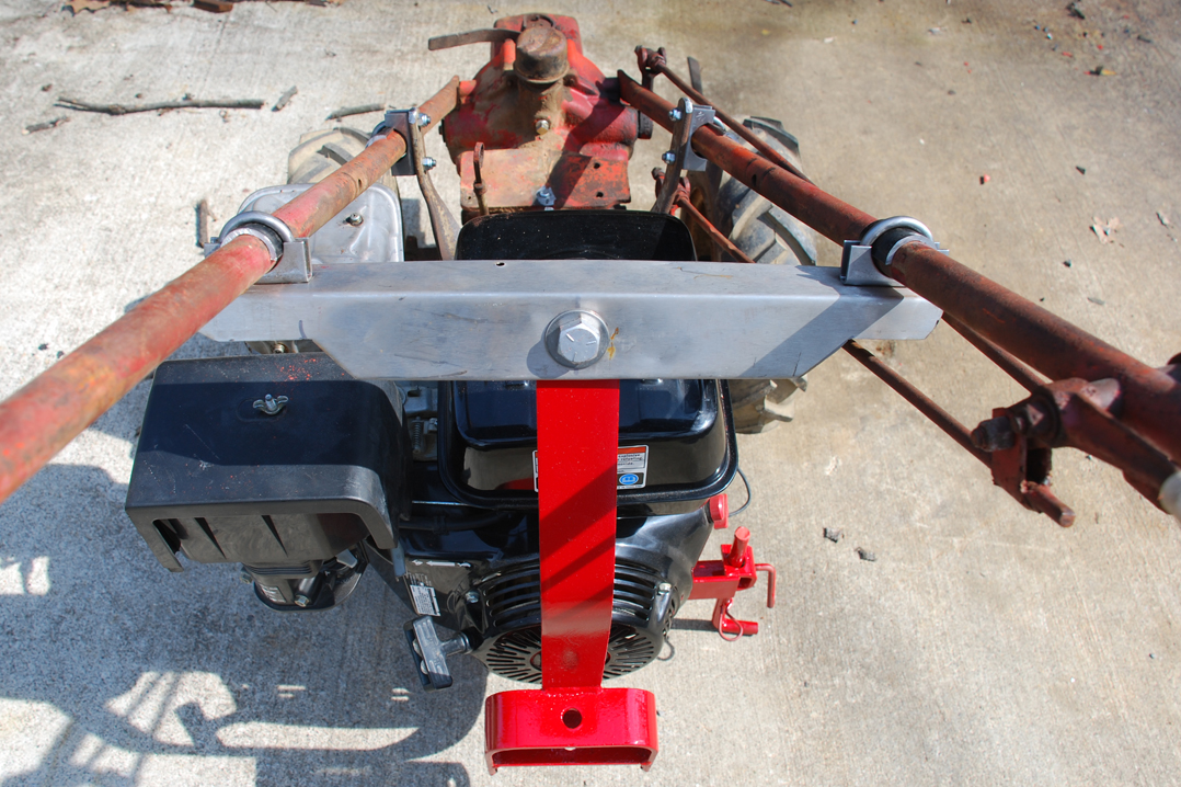

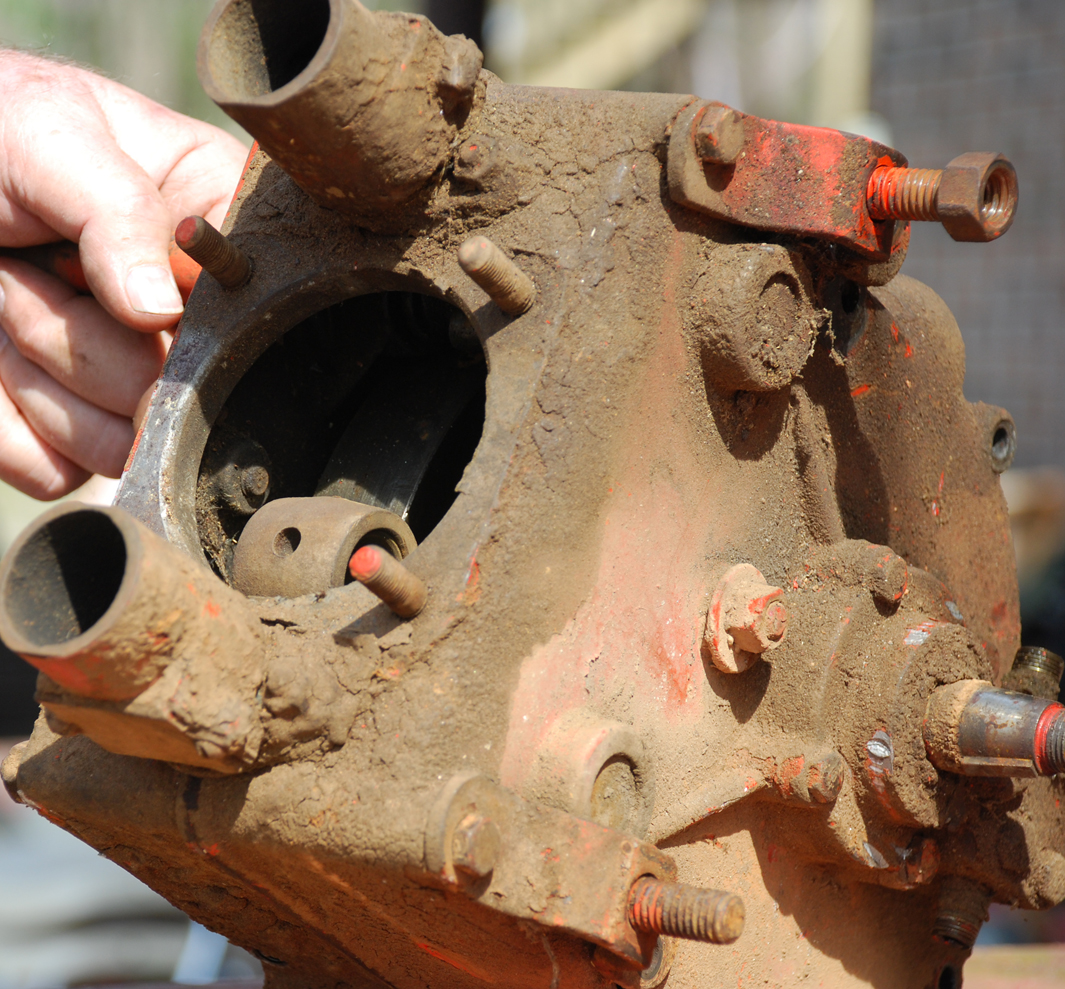

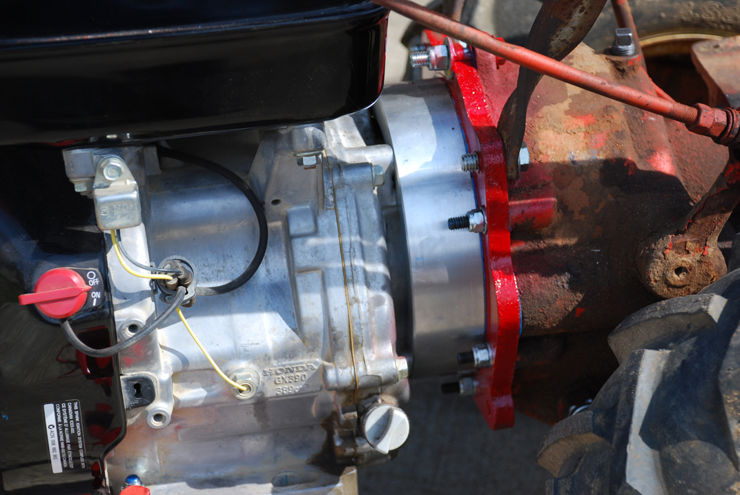

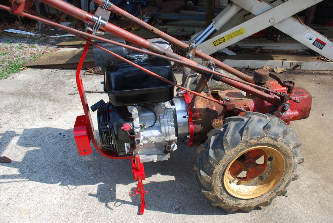

Also here are some pictures of my first a temp at repowering a model L
The old tractor needs a lot work but I though I would see what people Though about my set up on the handle bars and adapter plate.

Well I though about the muffler clamps .
They just don't look like they belong there.
I think will just drill holes use a split pipe around
the handle bar for more support.
Like I said that was my 1 st stab at it.
What do you guys think? :confused2:

Very cool, Bruce. Did you start it up? How does the gear with the top hat work? There are lots of ways to support the handle bars. What you did looks perfectly fine. Not sure what muffler clamps are???

The new engine looks huge compared to the old Gravely engine on L models.
But I'm all for seeing these older units get repowered as these tractors still have years of use left in them if we could solve the engine problem.
If the whole tractor were painted, I think the new engine would blend nicely.

I just mostly trying out how i want to latch everything down.
I have a lot of work to do to this tractor before I run it.
like clean it out and ck the forward & reverse planetary.
also pull the axle and clean out I cleaned out the back
the oil screen was stopped up.
I pulled it out and stopped all the line holes.
I will probably pull the engine back off if need be.
Then clean and paint the out side.

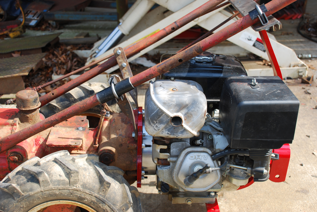

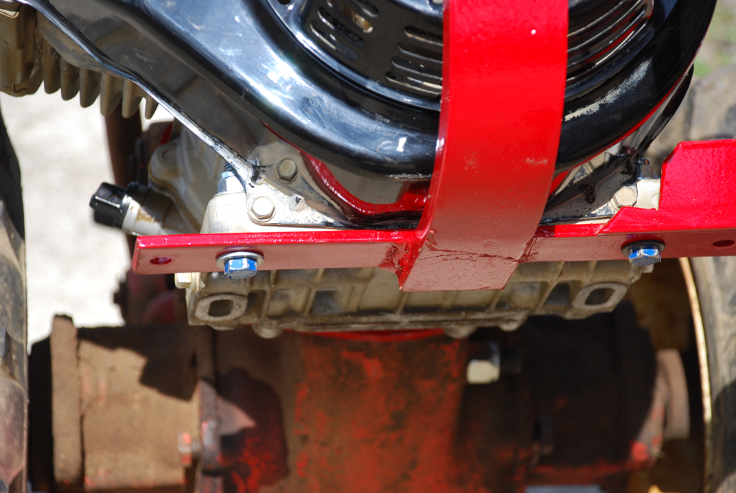

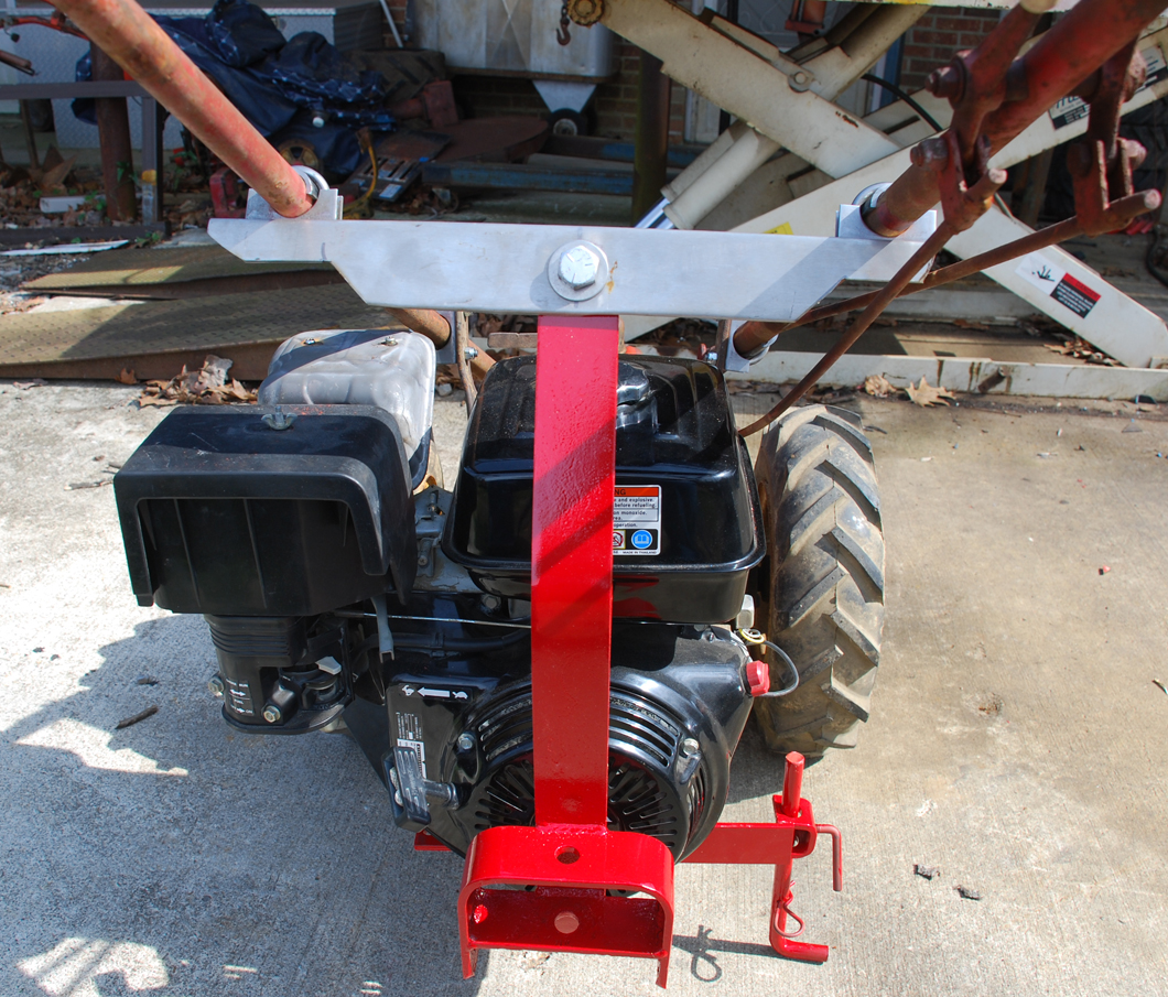

I have the gear and top hat running in a C10 sound feels good.
So I put 1 in this one but have not started it until I clean it out and put oil in it

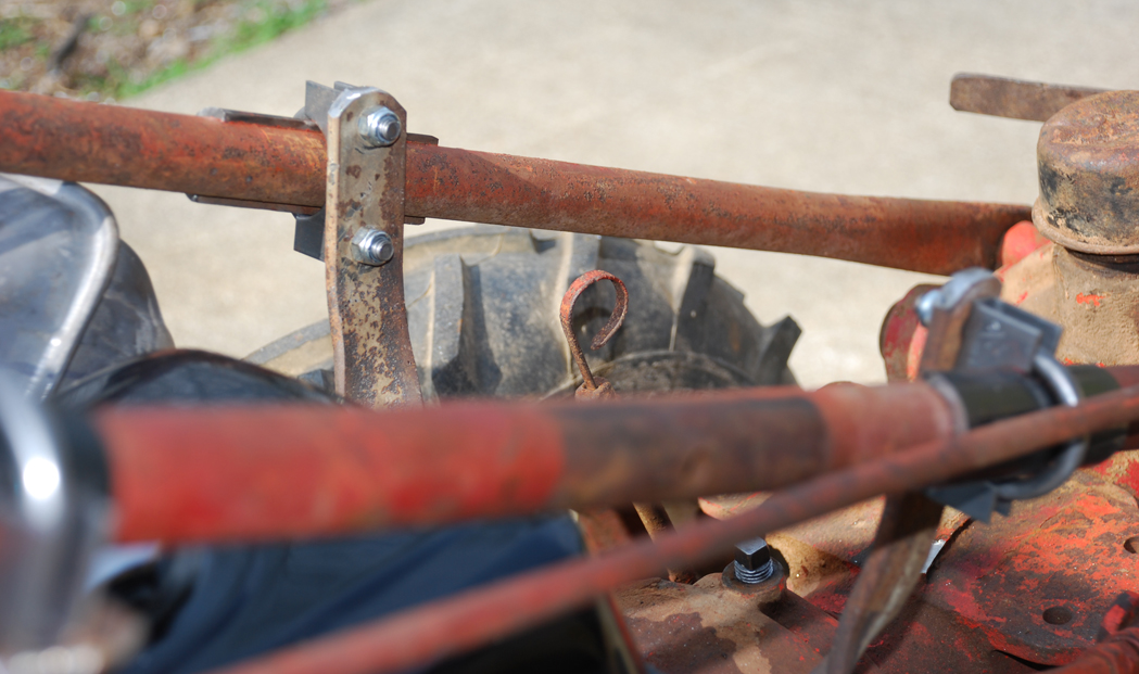

The muffler clamps are Just clamps for 1 1/4 dia pipe.
Here is a closer look at a clamp
Also the old rod had broken into and locked down.
I am trying to make up my mind if a bolt through or the clamp is stronger.:confused2:
Now I get it - the clamps are for car mufflers. You are right, they look a little like they dont belong but they do the job. If you drill holes thru the handle bars you weaken them - so putting split pipe around the holes is probably needed. As you get further along you'll have to figure a way to attach a hood. (Gravely L hoods usually rest on part of the fan housing). Nice work so far. Keep us posted!
