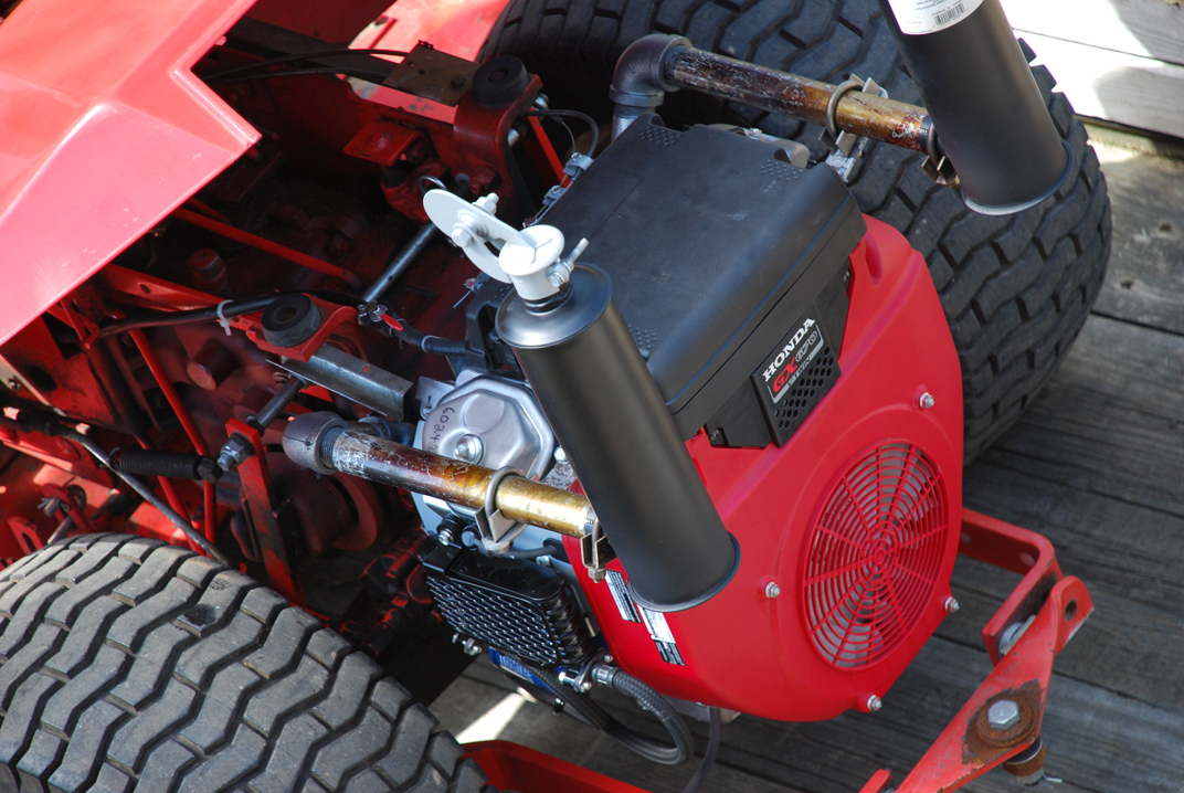

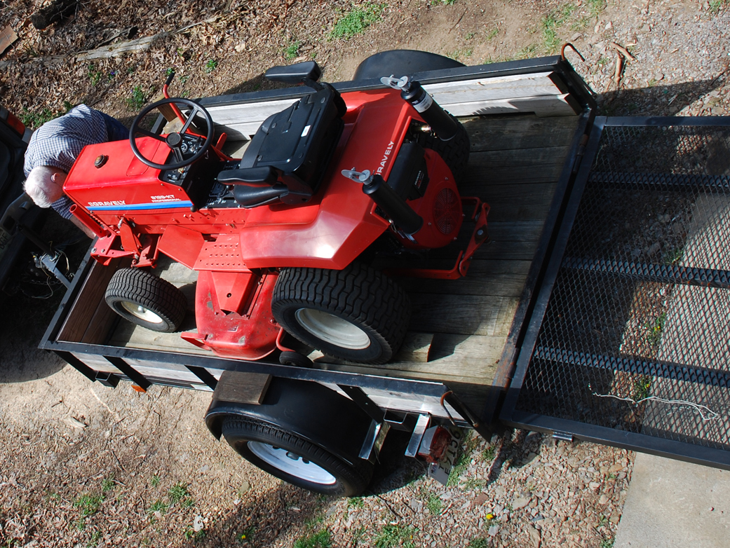

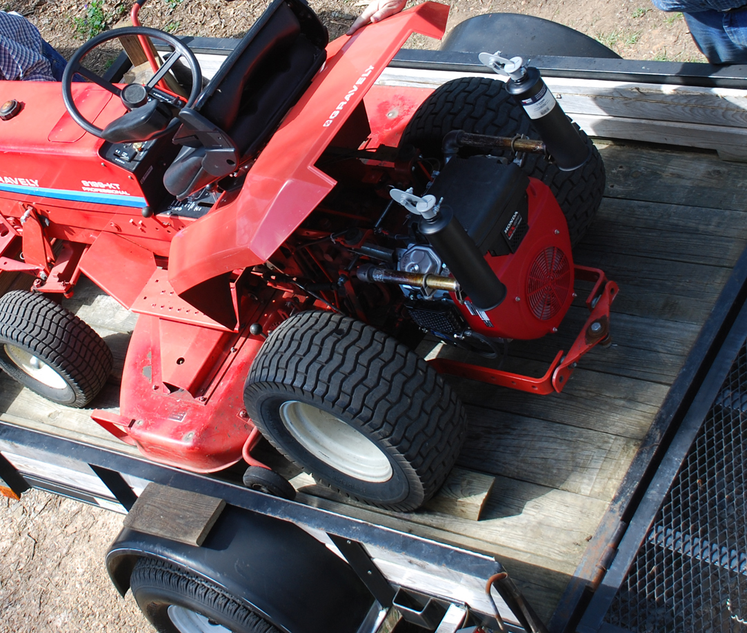

Off subject but here is what I have been doing in my spare time .
part of Monday and part of Tuesday.
Going from 19 series II Kohler to a 24 Hp Honda:thumbsup:
Is that yours or are your doing this for someone? By the way it looks very professional!

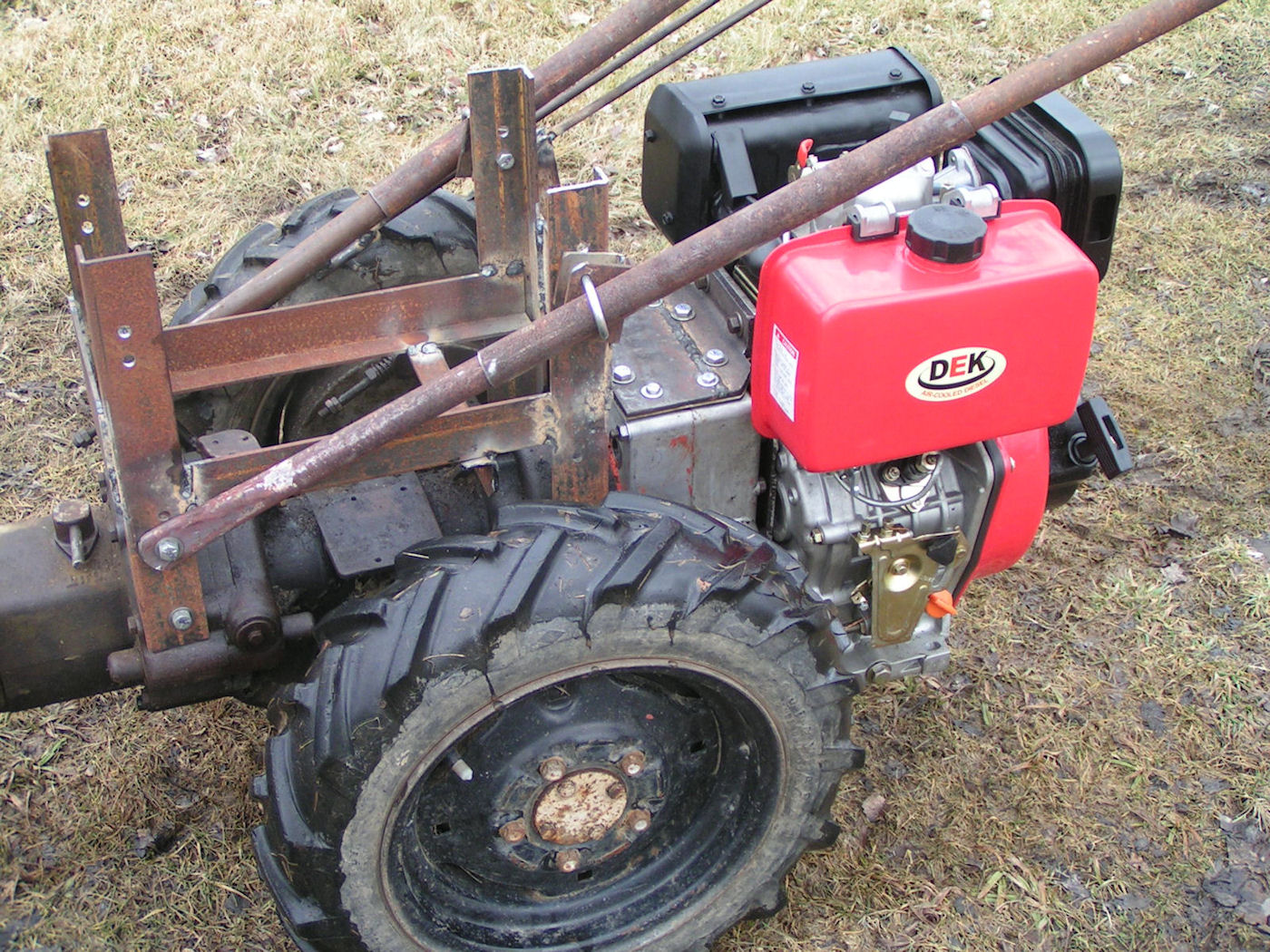

Hi! You make always very good job! For my Gravely diesel. I make a special frame for put battery and fix handlebars. The ends are 4.5 in. more high and I add a tube ( In middle) over for renforcement. I make one offset 4.5 in on one rod shifter for muffler. The Gravely diesel with reduction wheels make about 500 lbs. Very powerful tractor. I add picts . Good luck! Oldmech

Hi Oldmech
You made a good repower.:thumbsup:

I like your reinforcement of the Handle bars.
I plan to split a 1 pipe for reinforcement
I have decided to put bolts through the handle bars.
Also plan to put a rod between them
I'll use a solid round and tap the ends

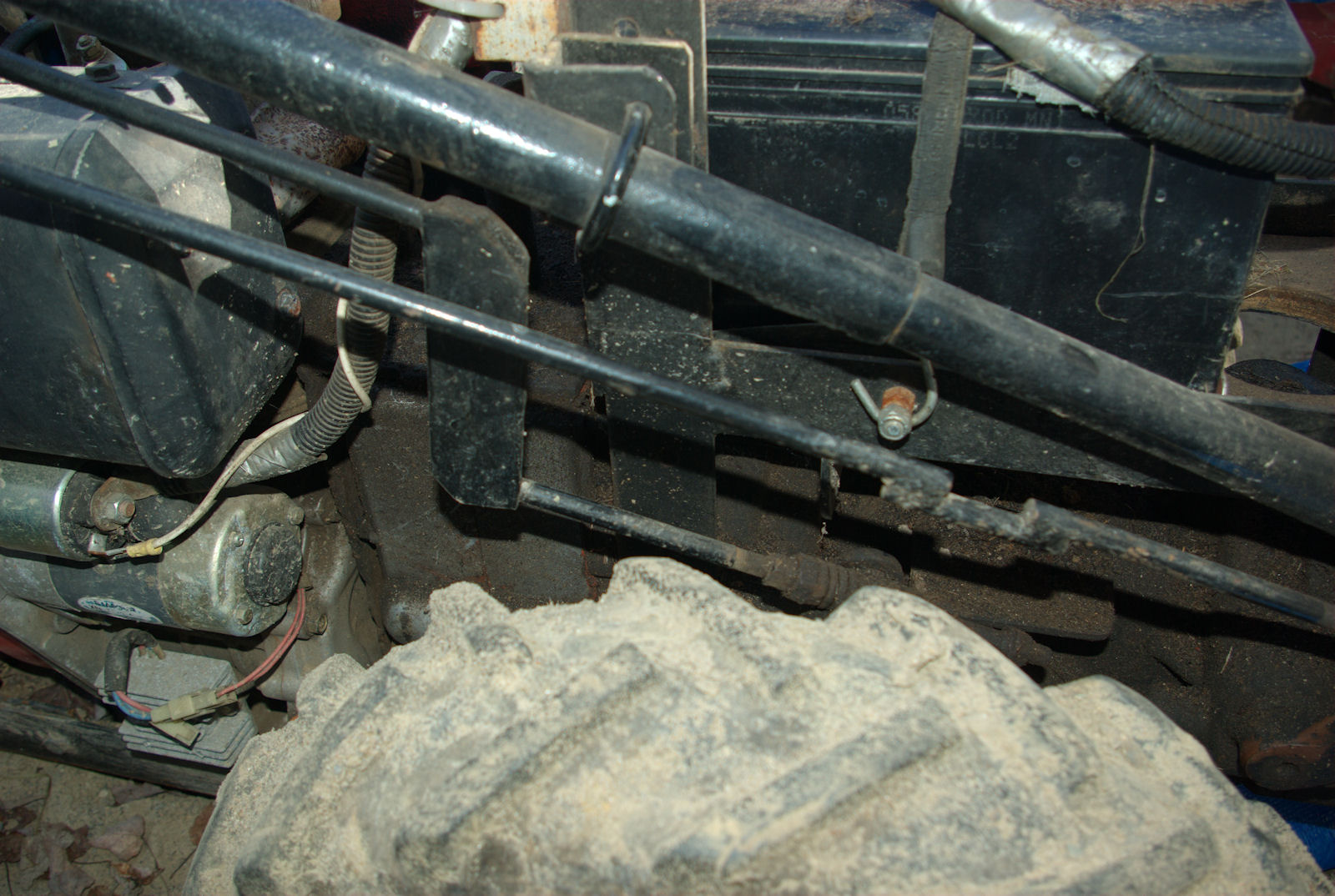

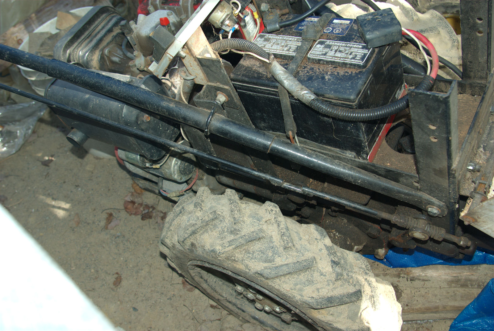

Also here are some pictures of my first a temp at repowering a model L
The old tractor needs a lot work but I though I would see what people Though about my set up on the handle bars and adapter plate.
I though it would be a ease job just clean up the old tractor inside and out
When I checked the inside and found out it was a 8 lead instead a 6 lead.:(
I changed completely I had a old LI there so cleaned it out in and out .:thumbsup:
Also drilled for a dipstick while I had it apart
So that will be the black LI tractor with a black 13 Hp Honda on it.
almost done?
Then we will see if it runs out OK.
