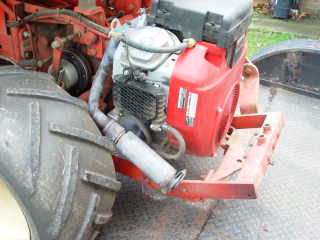

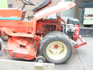

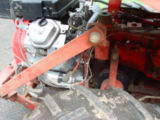

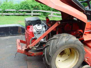

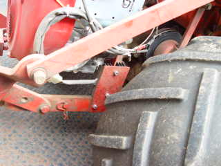

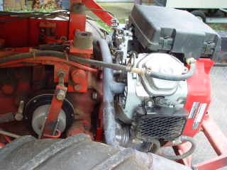

/ Engine ideas #110

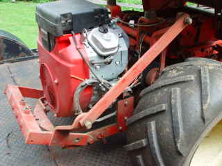

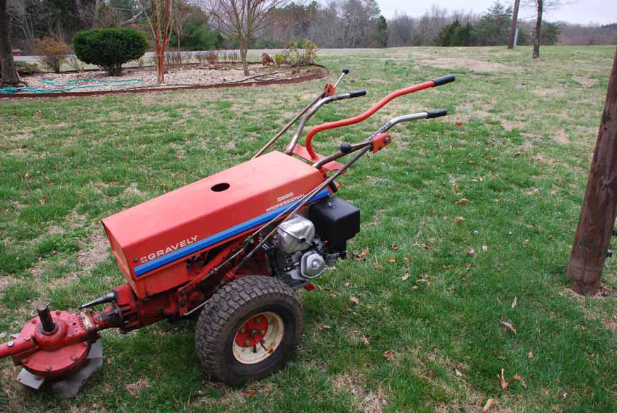

I though I would brake the ice
And show what the Honda looks like ready to be put on a gravely in place of the 12 Hp kohler.
Thanks Bruce g
P.S.
My e- mail has changed to gravelymay@yahoo.com
IF need help or if you have questions

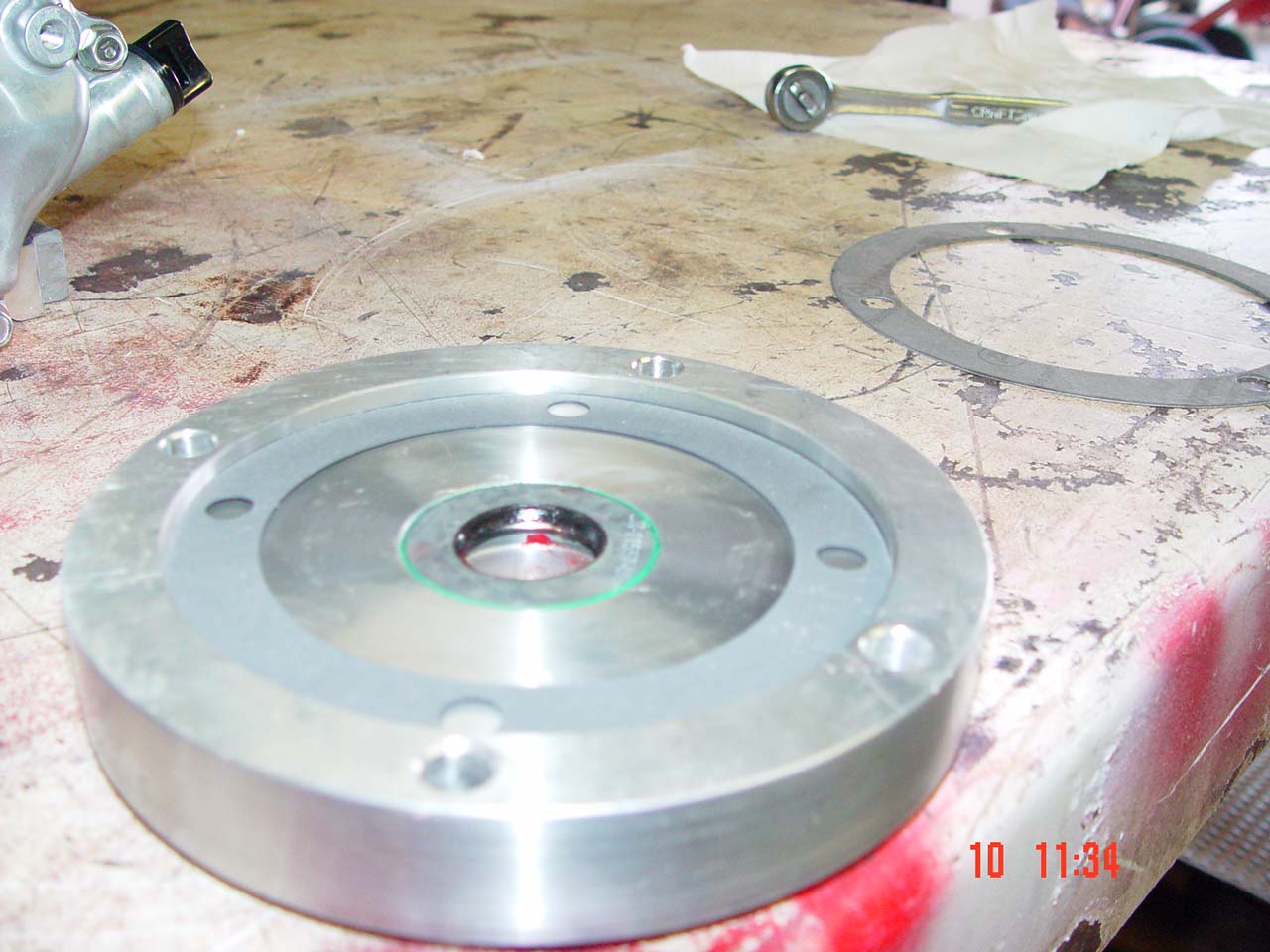

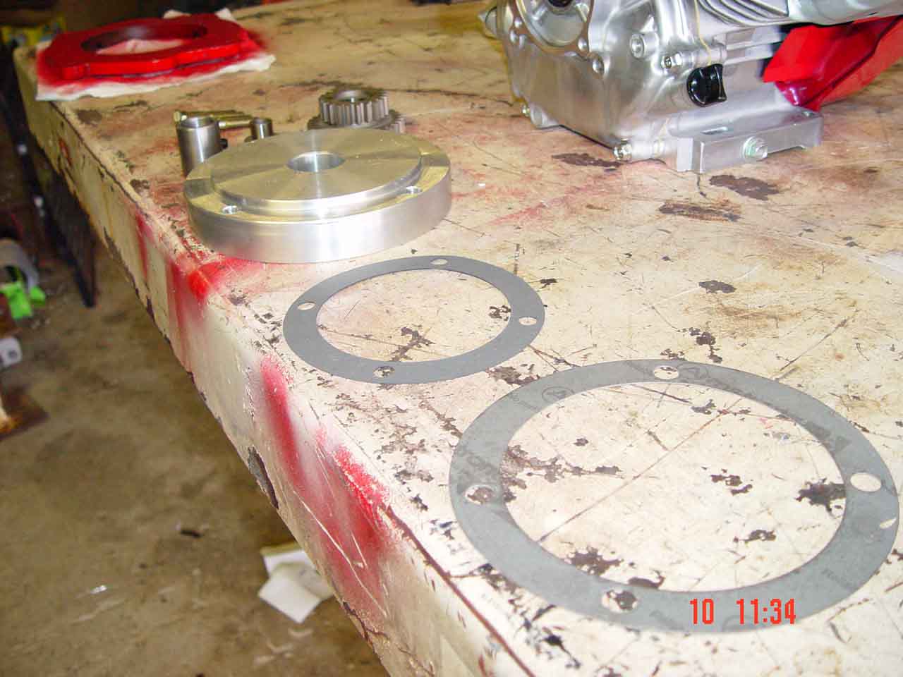

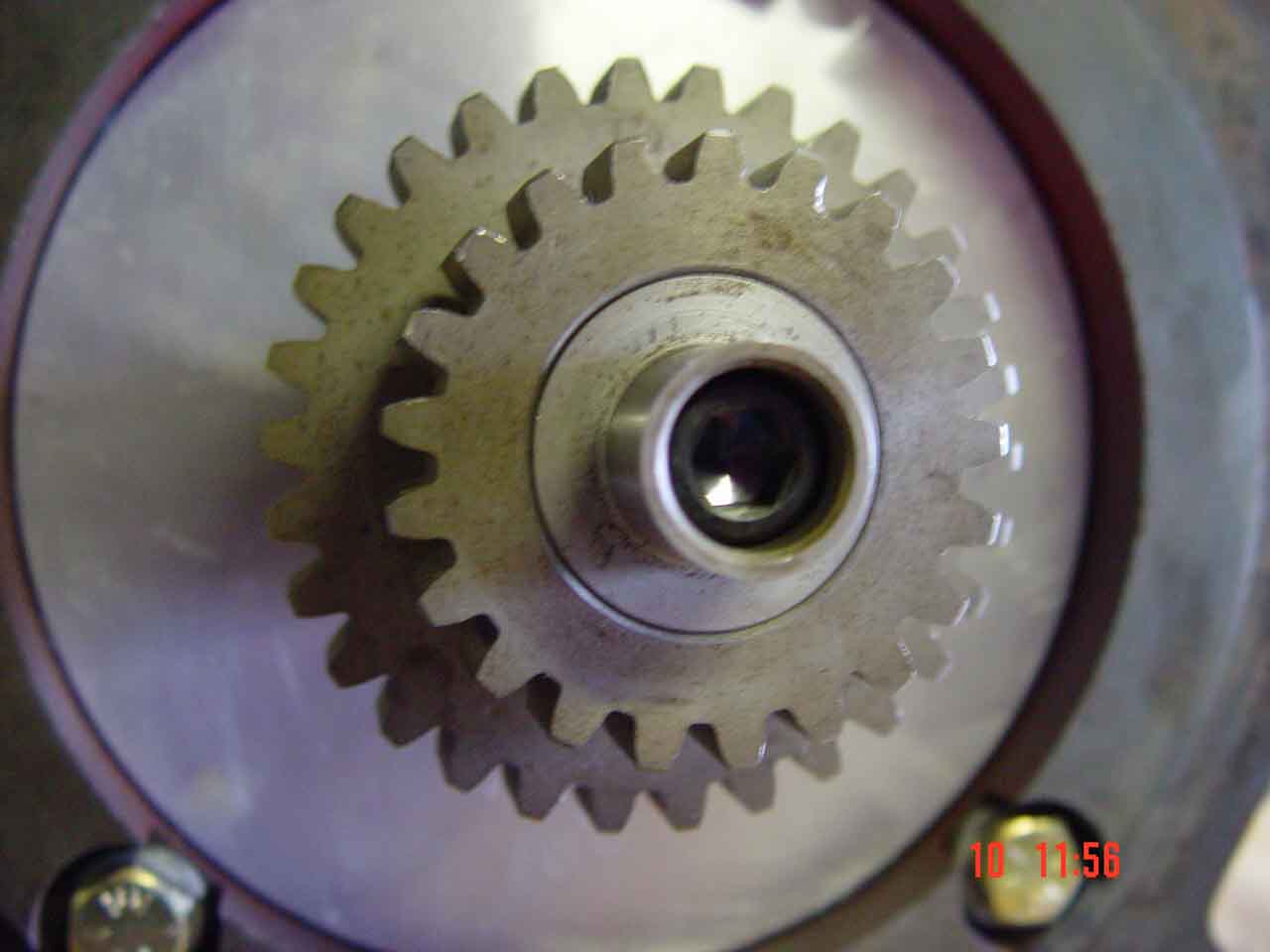

/ Engine ideas #119
Hi folks. I'm a newcomer around here. After reading this thread last week I ordered a 13HP Blue Max (Chinese clone) from Tulsa Engine Warehouse for $US 250 which included shipping. The engine just showed up tonight. I plan on putting it on my 1973 Superconvertible, which is of course a model L at heart. I wont be able to work on it until Spring but I'm trying to decide the approach I'm going to take. I've already PM'd Oldmech who filled me in on some details of his method. There are many great ideas for making adapters on this site. For now, I'm wondering if anyone has a dimensional drawing of the tranny gasket which shows the bolt pattern and the distance between the bolts. Also, if someone has such a drawing, where is the location of the drive pinion shaft relative to the bolts? If someone knows this and could post it, I'm sure many would be interested. Also, does anyone happen to know the overall length of the drive pinion bushing? The bushing i.d. is nominally 1" - does anyone know the nominal o.d.? Sorry for all the questions. I'm just just trying to gather some information so I can plan out what I want to do.
Thanks.
Rich
/ Engine ideas #120

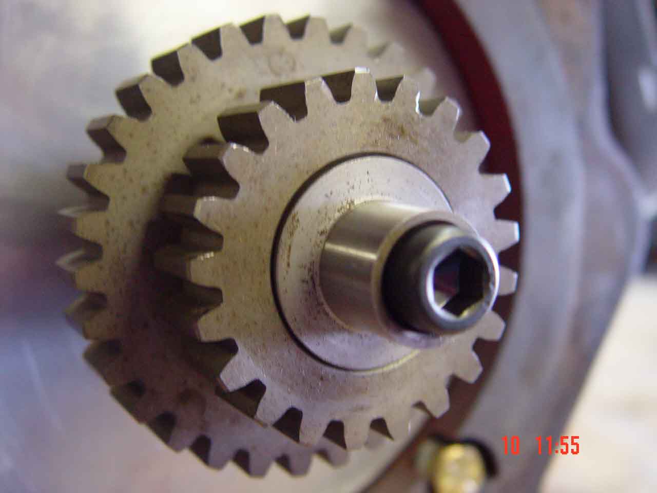

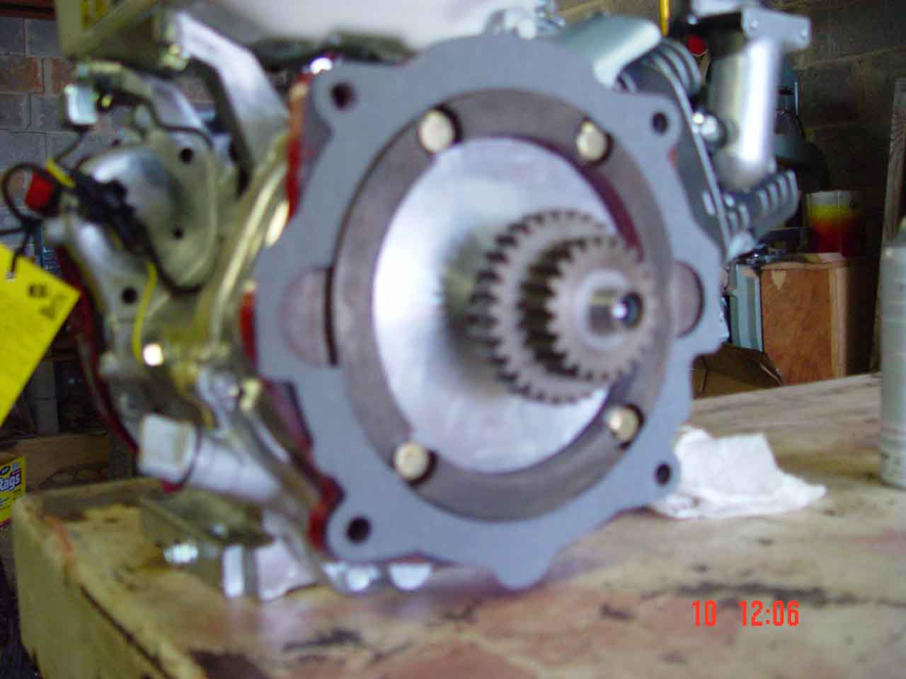

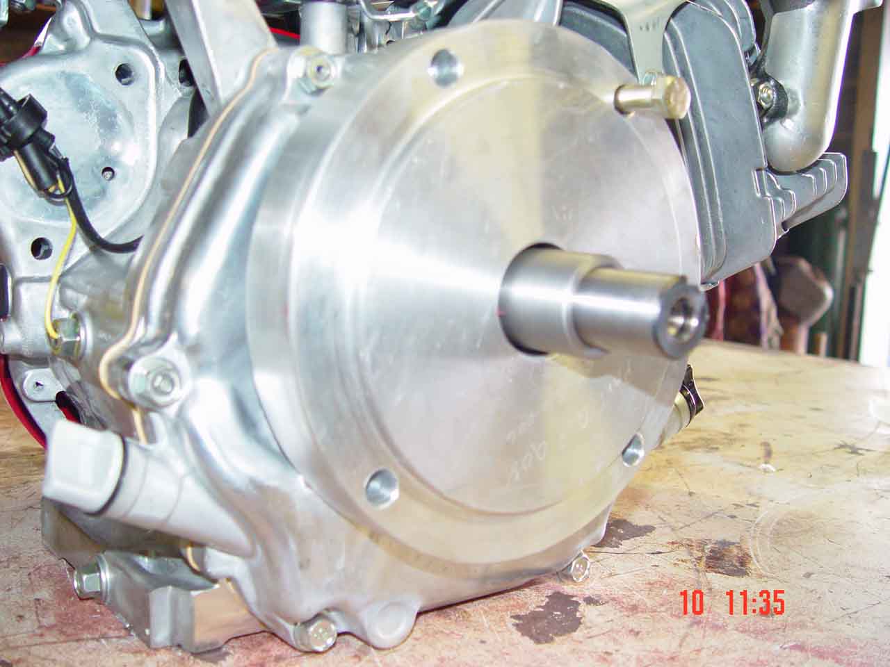

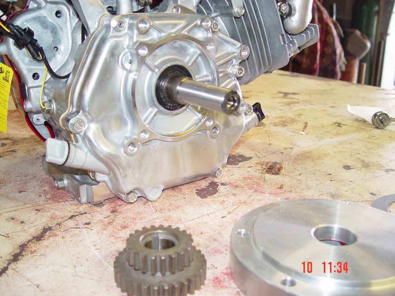

HiI The first step is the MASTER adaptor plate Pict one. Dim. about 6 1/2x12in. x 5/16 .look 3/4 pins(2) for fit in camshaft hole crankcase They are four 3/8 holes for engine bolts. pict 2 is LC100 on tranny shaft. Pic 3 is adaptor plate on engine they are four spacers between the adaptor plate and the crankcase. two steel plate was add. for renforcement. all was bolted on engine Pict 4 The oil galeries I drill two 3/16 holes. I add other pic later. Oldmech
