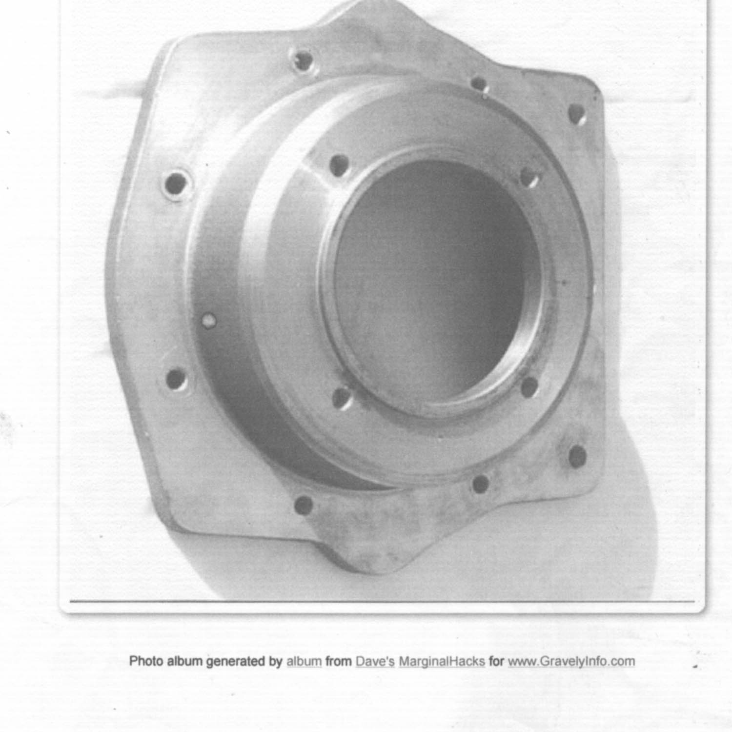

Hi! I want add new pic 1 is engine and adaptor crankcase ready to go . all parts are with silicone gasket cement. pict 2 is engine bolted on tranny look spacers between adaptor plate and crankcase. Good luck ! Oldmech

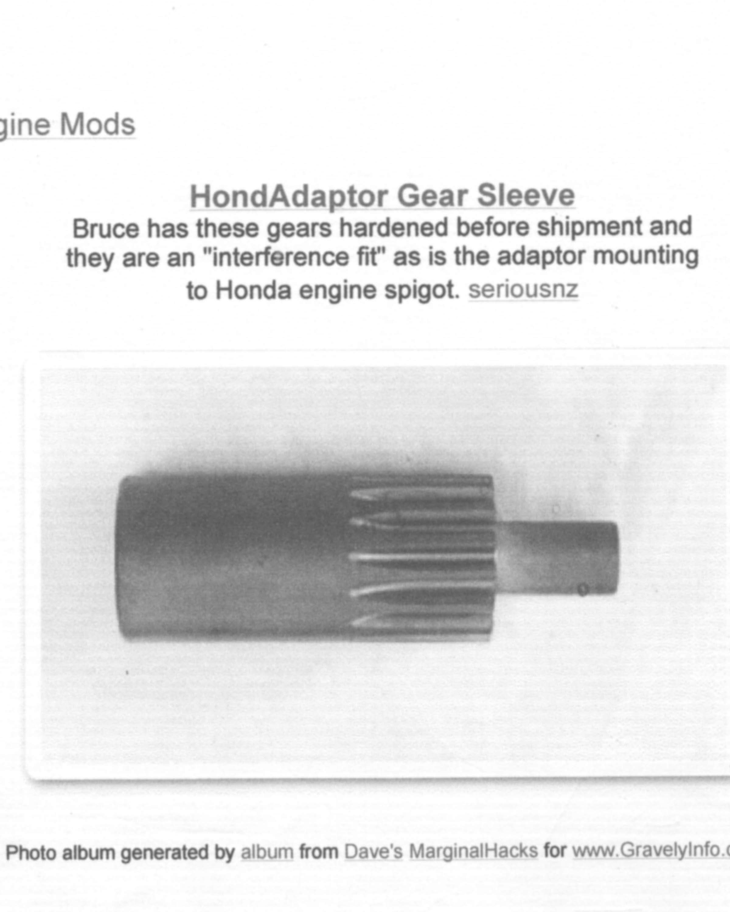

They sell a coupling 1 dia. that will fit over the
forward part of the model L crank shaft.
Cut the crank into 1in before the gear mill 1/4 key slot up to the gear.
Drill the gear though and counter bore the end.
To fit a 3/8 X 24 cap Screw.
long enough to go all through to hold it all together.

I am slowly progressing on the conversion of my L8 to a Honda clone. The approach I have chosen is to use the front half of the Gravely crankcase to connect to the tranny and use an adapter plate in place of the rear crankcase half to connect to the new engine. I am using a 1/2" thick aluminum plate to cover the crankcase with a smaller 1 1/4" plate behind it as a spacer (total thickness 1 3/4"). These plates are pretty much done. Need to get final dimensions on drive gear and get it machined. Gear will need to be cut to size, have keyway cut, and be bored to connect to crankshaft via long bolt. Am not ready to post pics yet but will do so later. I've been PMing oldmech & Gravelymay and each has given me excellent advice.

Hi! GravelyMay is a Master engineer and make very goods jobs You can trust in him.
My system is very cheap. My cost was less $200. Run very well now more 300hrs.
But I think you go to as Belos site. . The shaft adaptor gear can be very expensive and you need a 112mm spacer adaptor between engine and tranny.
Some years ago a NZ Man make a Kit for Honda to Gravely L about $400 as the Belos site . I Write him No more available. Good Luck ! Oldmech

My approach is not unique but a combination of several already used. I like the idea of using the crankcase as an adapter but I'm only using the front half (WITHOUT THE BRASS BUSHING). The rear crankcase half is replaced by aluminum plates. The gravely drive gear will be cut to length and attached to the clone crankshaft via sleeve & 1/4" key and held together via a long bolt. The sleeve and gear will easily fit through the 2" hole in the front crankcase half. I chose this approach to keep cost down. I purchased aluminum from my local scrap metal dealer and cut it to size using a circular saw. I drilled holes with my cheap drill press. Even though I am not a mechanic I believe I've got the tolerances close enough that it will work. Cutting the drive gear is something I cannot do myself so I am looking for help on that. I mounted the engine on the tranny briefly yesterday (without the drive gear, of course) just to see if the handlebars would clear the muffler and fuel tank. They did. Am still working out how to attach handle bars but I have a few ideas for this. I am in no particular hurry - just taking my time and having some fun. I appreciate all the comments and suggestions given by others on this site. Thanks.
