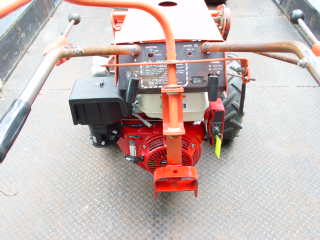

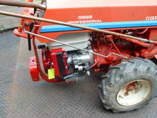

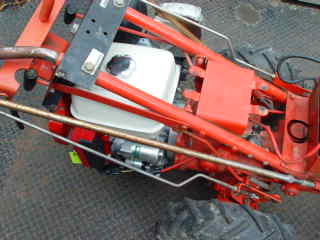

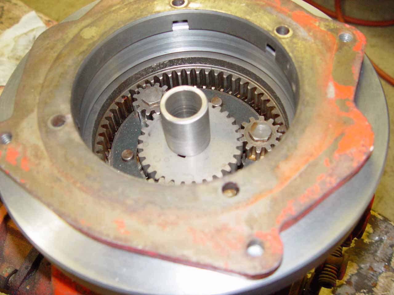

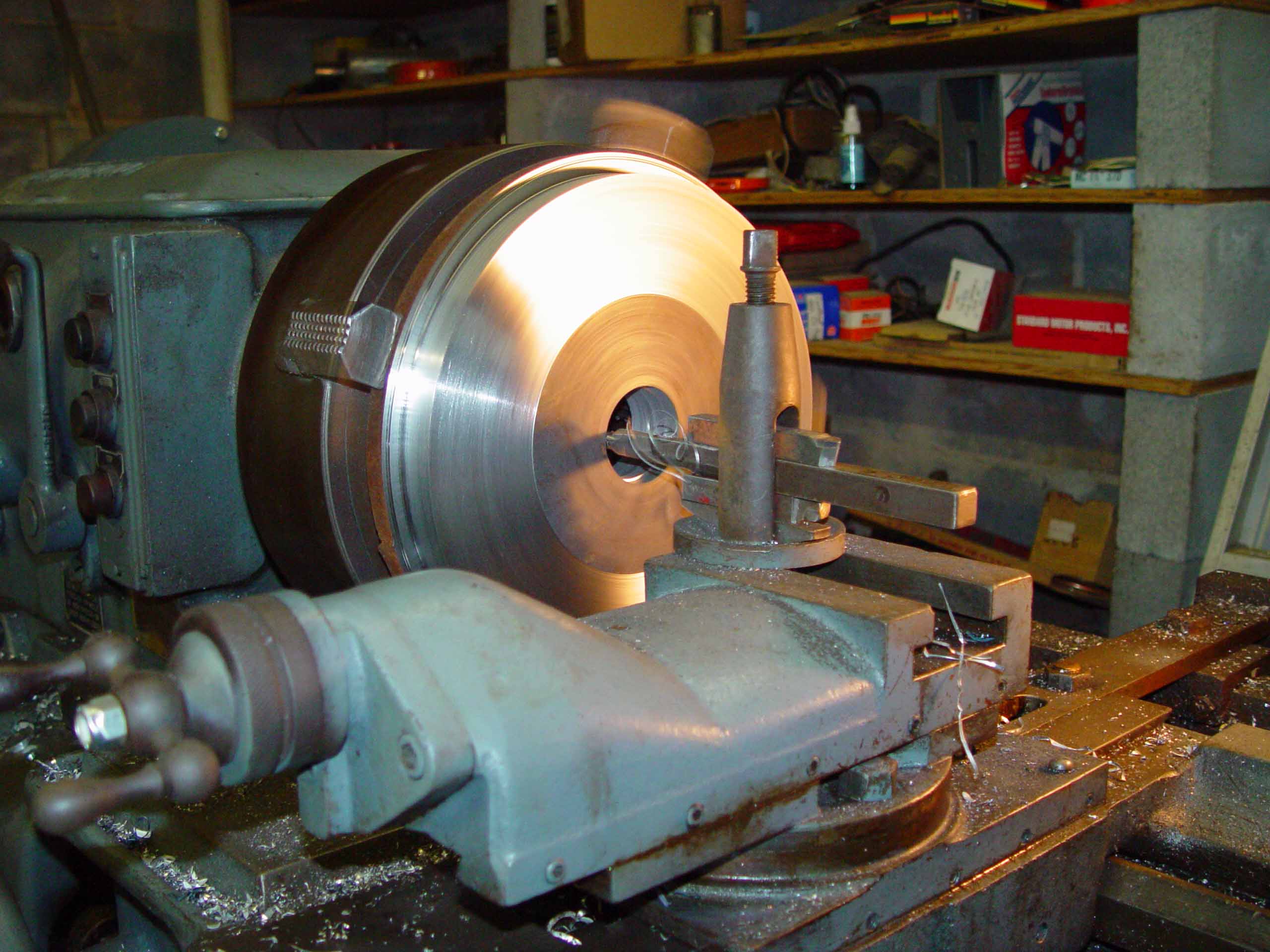

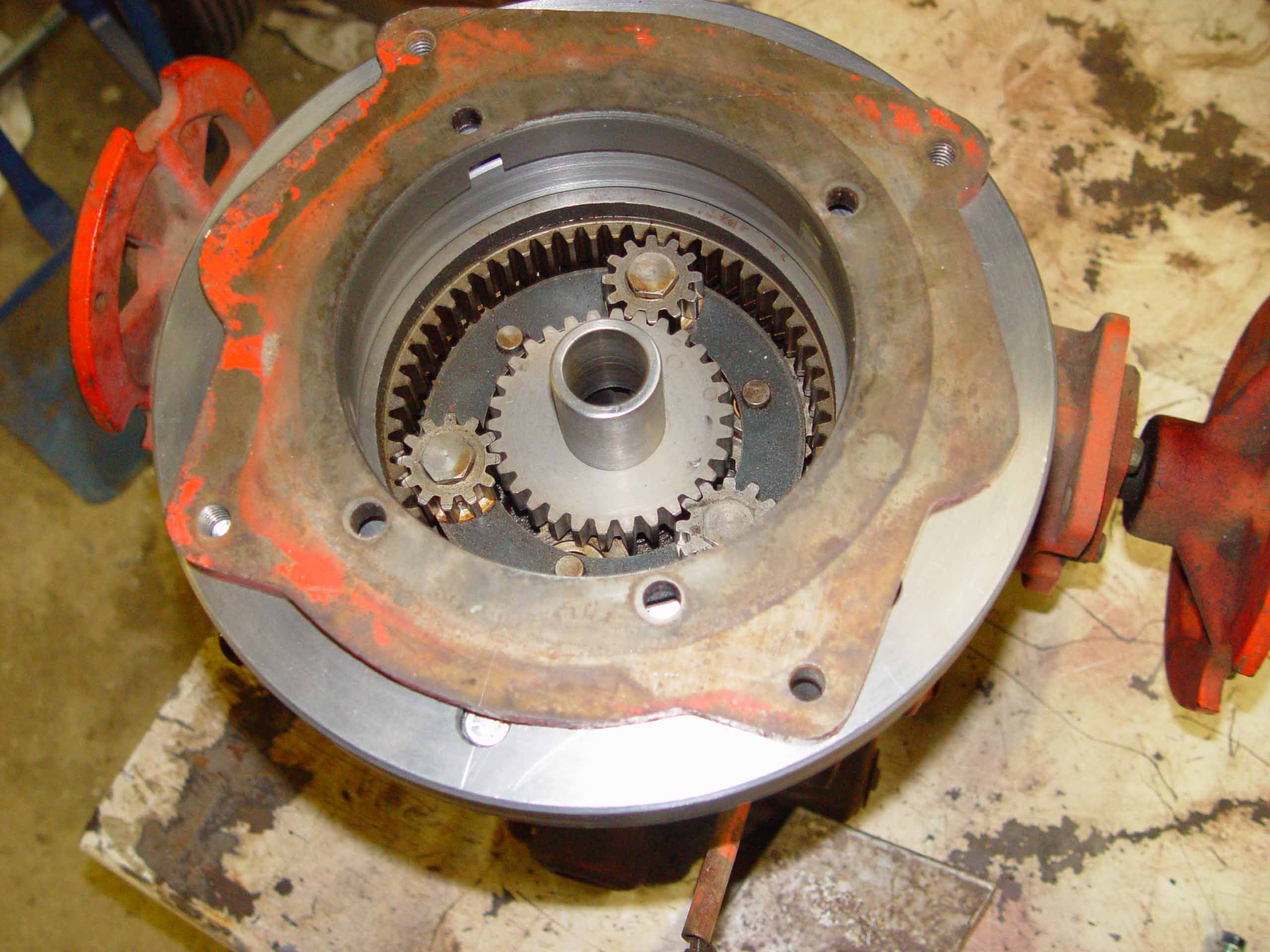

/ Engine ideas #88
Well I have been off for a while.
I made my first adapter to put a Honda clone on a old Model L Gravely
By using a Kohler adapter and the adapter I made.
Plus use the whole planetary from a newer model including the cross over
and side actuator arms.
In order to slow the tractor down.
Also use the Gravely Double Gear and the Gravely pilot bushing.
Thanks Bruce g
/ Engine ideas #89
I am going to try one picture.
/ Engine ideas #90
I am going to try two pictures this time.
Bruce g

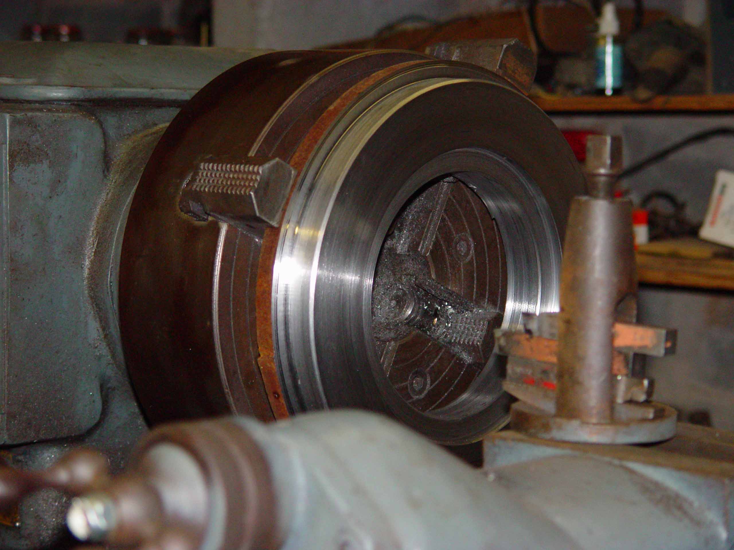

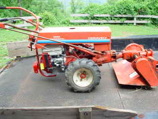

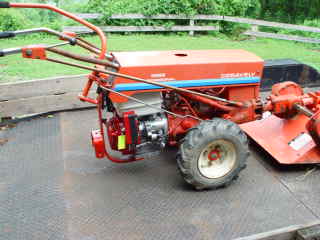

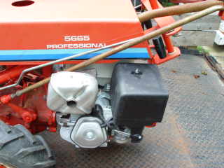

How did you make your adaptor? I have an intermediate geared Gravely that I wish had a Honda engine.
/ Engine ideas #92
I turned it out on a lathe.
This set up uses the Double gear like the late models use.
You have to change the whole plantary. out to the newer style.
Including the cross arm
But this gives you back the speed you want.

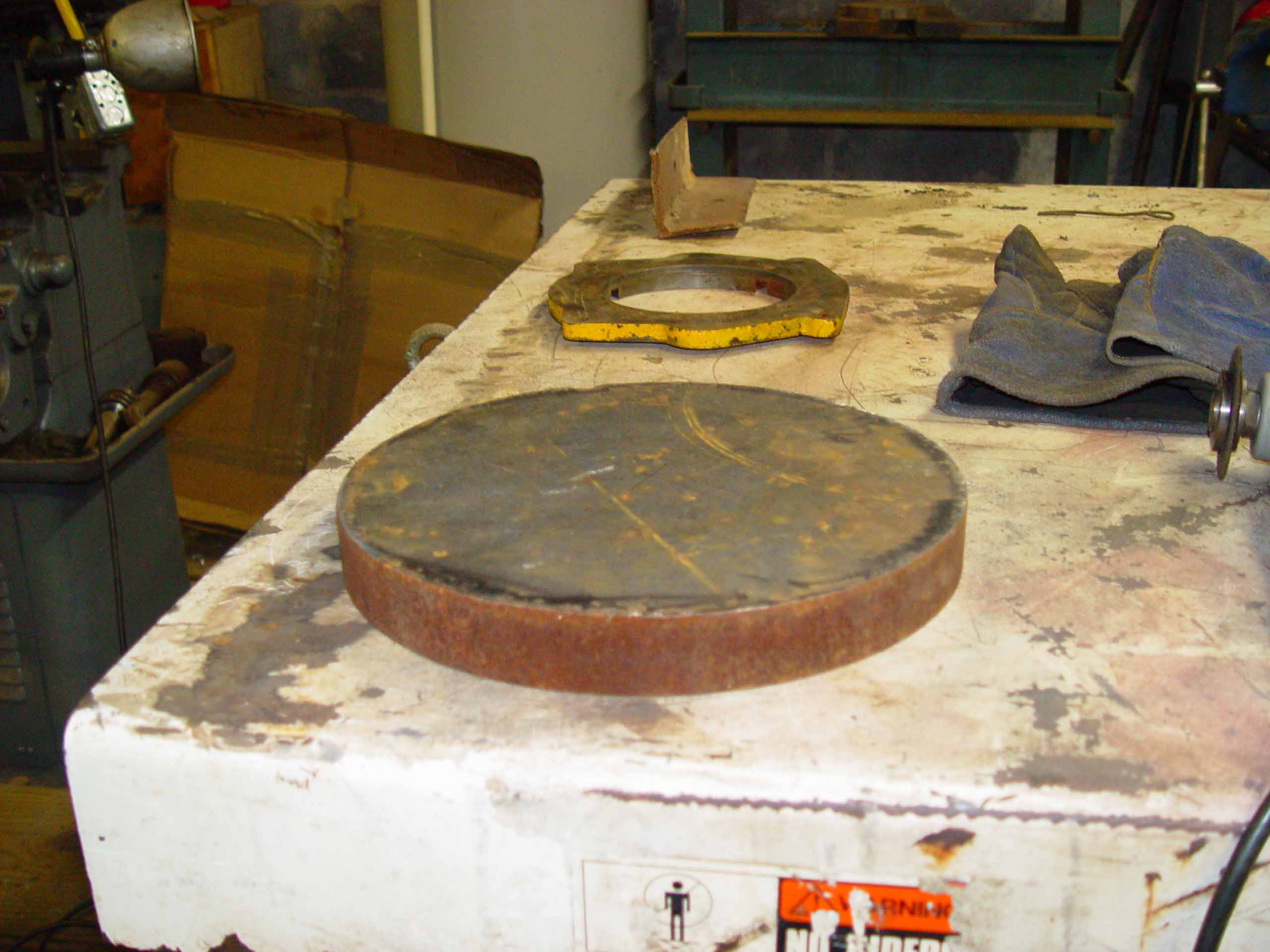

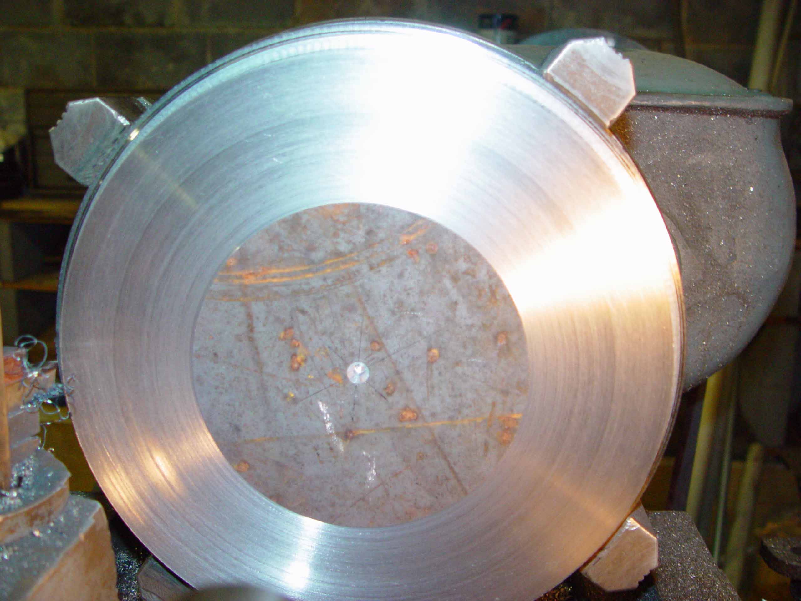

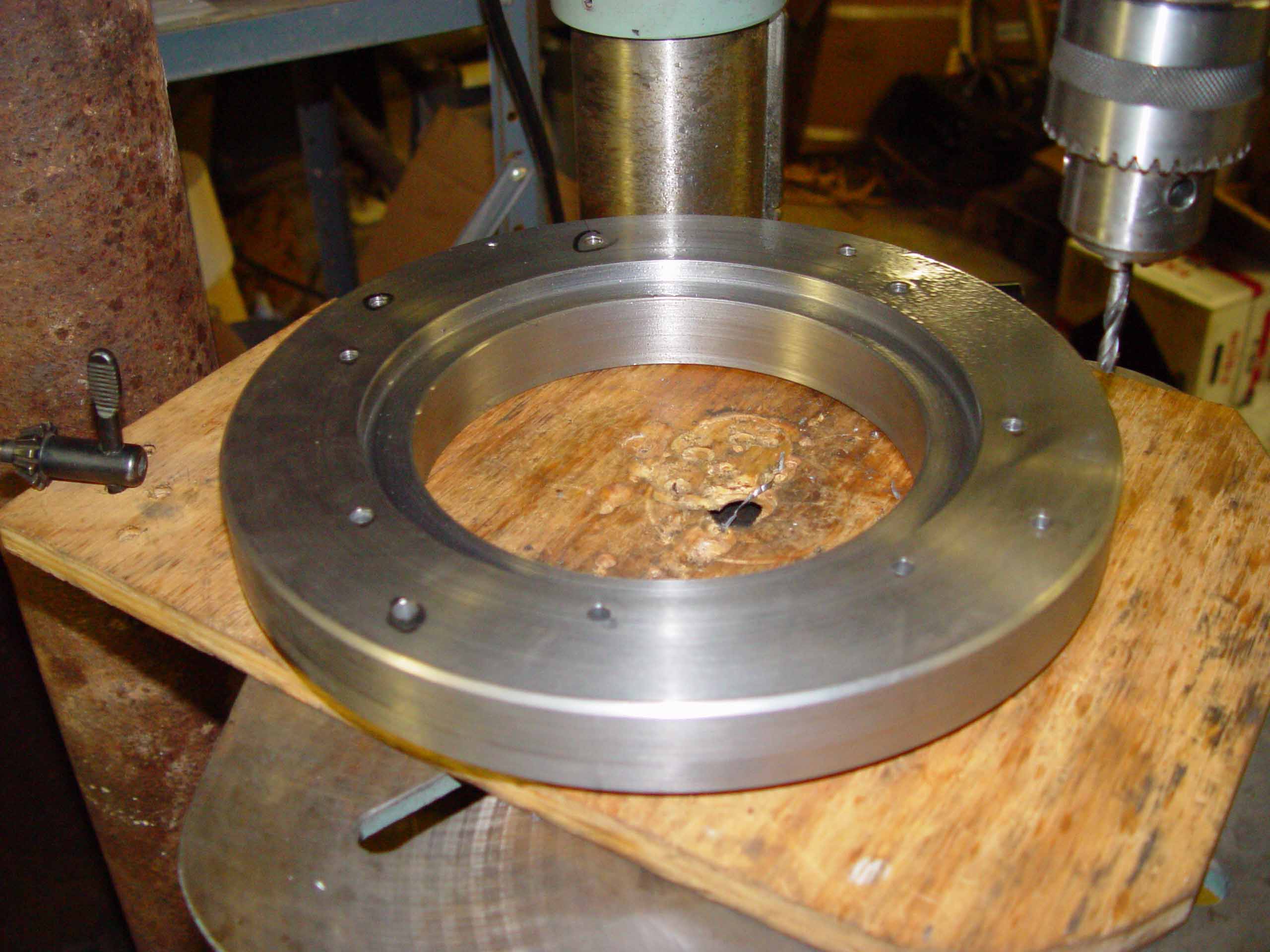

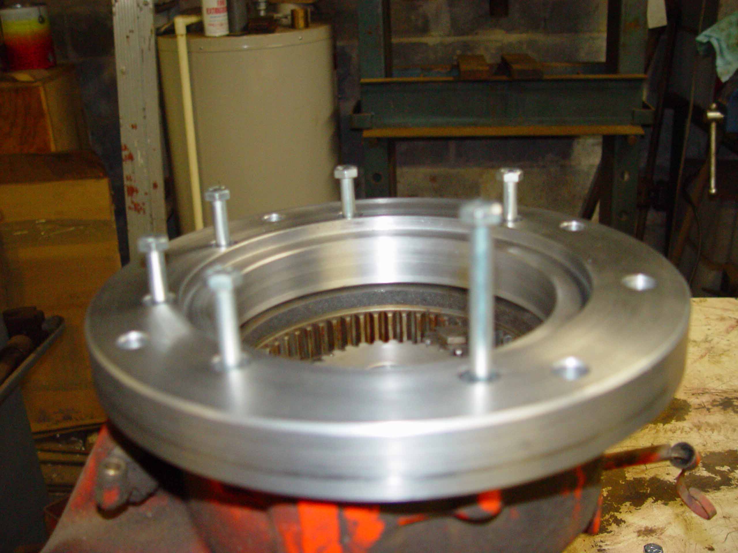

/ Engine ideas #93
Looks like you started out with a circle of solid steel, turned it on the lathe, and then bored the holes on a drill press?
I met a guy who got some kind of heavy wall aluminum pipe from a lab and then made his adaptor out of it.
/ Engine ideas #94
Yes that is right.
Alum is half the weight.
I like to work alum and this adapter can be made from alum.
The steel was about 18 lbs.
Alum maybe 7-8 lbs
But alum is high price.
Thanks Bruce g
/ Engine ideas #95
This adapter is used where you use the late model or Kohler gears in the rear to slow the Tractor down to normal speeds .
You Need to use the Kohler 8 Hp adapter also in order to stop the oil from leaking out.
Can use a 13 Hp Honda, Robin, or Diesel, and the clones that have a 1.00 dia crank shaft
Use Gravely Part # 46410 new part # 08564700 Gear $134.05
Gravely Part # 46411 new part # 08564800 pilot bushing $27.05
Gravely gear set ??? E-bay
GR 002 shaft spacer,and GR 019 model L adapter $150.00
this gives a high lite of the cost of the project
NOT FOR THE REG GEAR SET WITH THE SMALL GEAR
Thanks I hope this helps
Bruce g

/ Engine ideas #97
It depends on what you can get the late model gears for?
I got a set off e-bay a while back for about $60.00
You need a 8 Hp kohler adapter about $40.00
The Reason for the 8 hp adapter is close off the oil.
The 10-16 hp adapter fits around the boss on 4 pedestals.
But does not block the oil from the transmission.
The small one set over the boss and seals up .
So the one in the picture won't work
