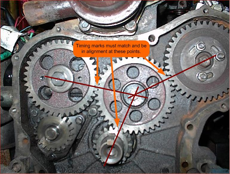

The small gear on the left drives the hydraulic pump via the big idler above it. It rotates at engine speed on a sleeve bearing. It has a stub shaft with a seal that connects to the pump shaft, so engine oil will not migrate to the hydraulics. Virtually impossible. Yeah, I know we're discussing the transmission.
/ Engine oil pumping into hydrolics #40
Bob not saying you are not right. How can hyd oil get into engine from the hyd pump? This is going be interesting when we find out for sure.
