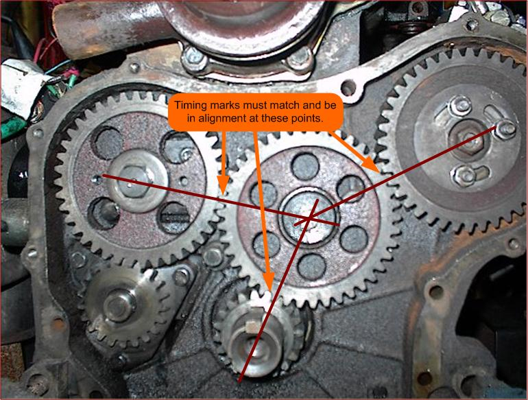

Yes I know the pump input shaft isn't submersed, but the timing, idle, cam, crank, and pump gears are throwing engine oil all over front of the pump. Also most tractors do use the same oil and true his might not. I'm just saying it's something to think about and maybe check. As said about the rear main seal leaking and getting into the trans I just can't buy that.

The small gear on the left drives the hydraulic pump via the big idler above it. It rotates at engine speed on a sleeve bearing. It has a stub shaft with a seal that connects to the pump shaft, so engine oil will not migrate to the hydraulics. Virtually impossible. Yeah, I know we're discussing the transmission.
   / Engine oil pumping into hydrolics #40
Bob not saying you are not right. How can hyd oil get into engine from the hyd pump? This is going be interesting when we find out for sure.
