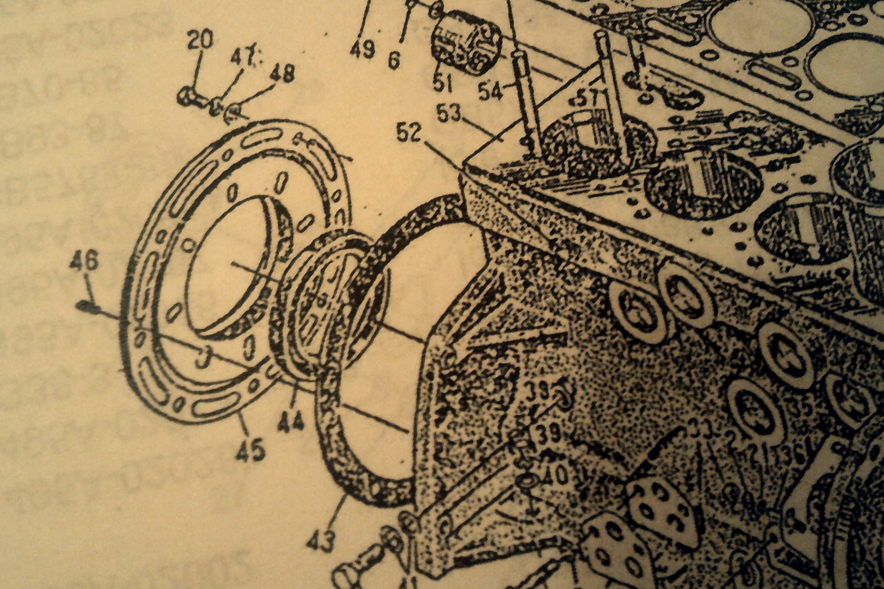

a pic of the rear seal of the Shanghai 495A engine block both an outer seal #43 and the actual crankshaft seal #44 assuming the 552 is the same as my 554 which i am not convinced yet

Oil pushing from a bad rear main seal would also have to push past the transmission input shaft seal, all the while not leaking onto the ground from the clutch area. I'm just thinking several of the TBN sleuths would like to have 1 hour looking at this mystery tractor.🔎
