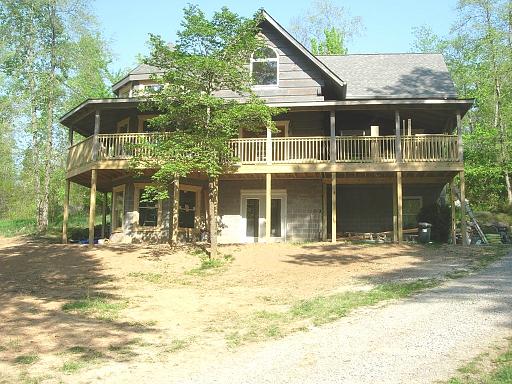

1. I do not know about the inspector... my GUESS is it's the same person but since I've never met them, I'm only speculating.
2. The wife drew a picture, that is all.. a picture on a piece of paper showing the house and her vision of the addition (she's a good artist) besides, the addition wasn't TOO complicated. The architect or draftsman (I do not really know his full credentials) then took her vision, as well as the ORIGINAL blueprints for when the house was first built (giving him the structure of it) and he then drew plans up for the addition. I might add that he also thinks the beam is unnecessary however, I must say again, I do not know his full credentials.
I'll attach some pictures to at least put a vision on it.
One picture is the basic framing so you can see the existing walls and the 4 angled walls that were added. The lower half are LOGS to match the rest of the house, the top half is stick built and given a 1x12 facade on the front (and inside) to give the look of a log.
The second picture is of the inside, showing what it looks like now. The peak to the ceiling is about 19 1/2'. My camera isn't good enough to show this wide angle.
I do not know if the inspector wants a beam from left to right or front to back. My HONEST opinion is, if he wants a beam to keep a wall from falling, then he SHOULD want two beams, one tying the side wall and the second tying in the front wall. After all, if my walls are at risk of falling outward, what good is it to only anchor one side??
As for cost of engineer verses cost of beam... trust me, my wife could care less about the cost. Her take on it is she's living with the view every day and if it costs me $1,000 to have an engineer verify that it's sound and sign off on it, she's not going to quibble.
She's also not going to quibble if it costs me $1,000 to have an engineer look at it... decide we DO need the supports and then we pay another $500 for the supports.. iffen ya know what I mean. The cost of it is the last thing on her mind, she is asthetics first and dayum the rest!! :eek:

Here's more of an after picture although it's not necessarily relevant to the discussion. We are very tickled at how it turned out.
