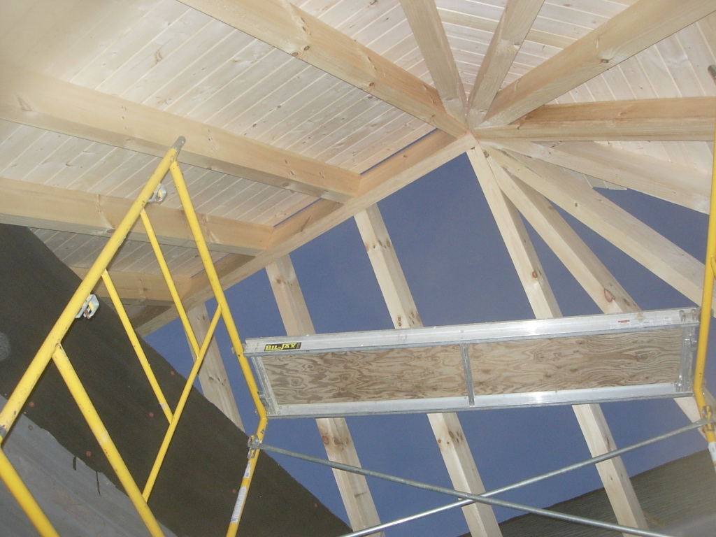

What is the beam for to tie walls to keep them from spreading?
If so a set of tie rods that would complement the design would work.
Say a piece of 2x3 rectangular tube rolled in to a circle about 1 1/2 times the chandelier diameter and 6 tie rods ( or an number that compliments the rafters) going outfrom it to the outside walls to keep them from spreading.
Sorta like a big wagon wheel with an over sized hub around the chandelier
tom
   / Engineers in Knoxville? #26
After looking at the picture again how far above the chandelier is the top plates?
You might get away with a piece of 12" heavy wall pipe around the chain with the tie rods out from there paint them flat black and I think it compliment the look of the room and chandelier.
tom

My speculation of what is going on here is that you have an inspector who hasn't seen this kind of framing detail before. He is probably accustomed to only seeing a rectangular framed ceiling with ceiling joists that tie the walls together. Now that he sees what it is, he's falling back on his limited experience and in effect saying, "get me a PE certificate that tells me you don't need any cross beams or joists to tie the walls together, cuz I don't know myself and I'm not going to stick my neck out on something I don't know about."
Somebody here may be able to explain why you don't need cross beams to keep the walls or ceiling joists from spreading out with this kind of framing. Small Gambrel roofs, for example, would not necessarily have cross beams. There may be other examples of framing that don't require cross beams.
It's beyond my personal knowledge to say even if you need cross beams for this particular framing. Maybe you do and maybe you don't. I'd suggest checking into it further. There may be something on the internet that might help him understand that it's okay the way it is, but if not, then the PE stamp may be enough to get it approved so he can pass the buck off on the PE.

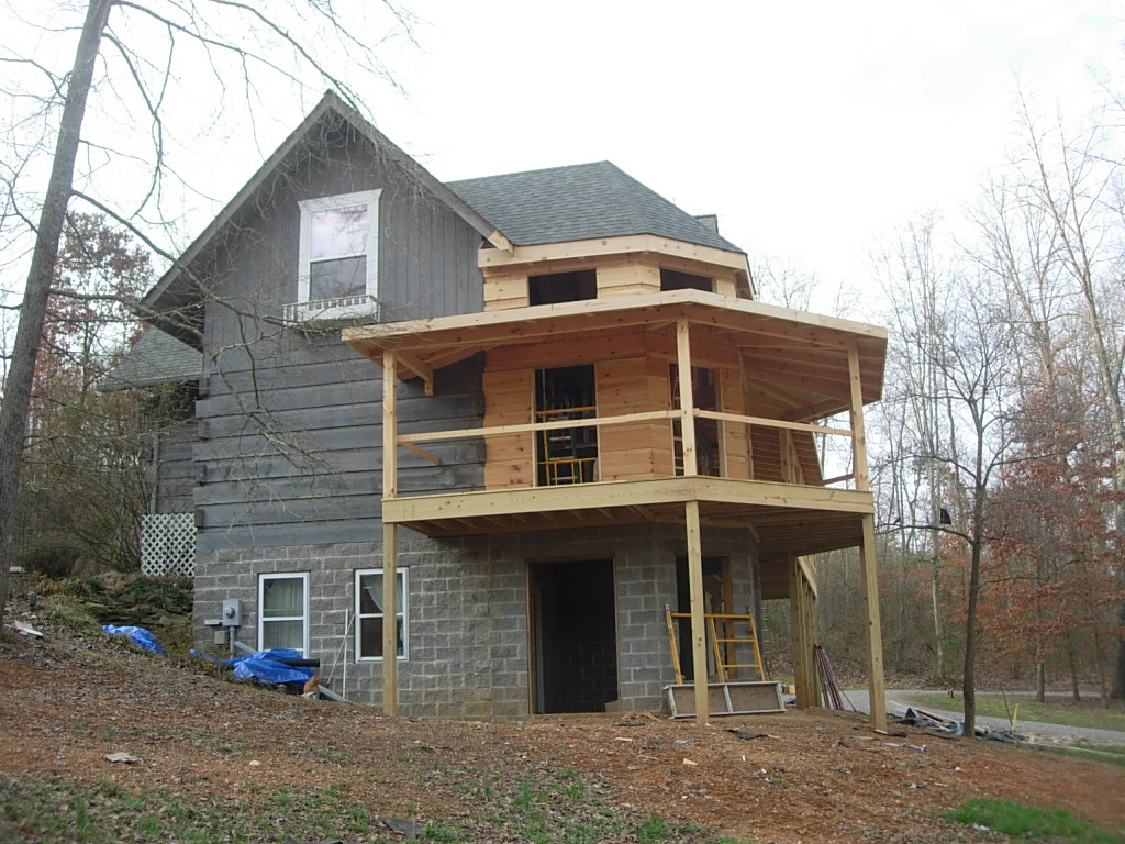

I don't know that I posted a picture (didn't look and don't remember) BUT...
This is not simply a roundish extension. Two of the walls were original house walls and aren't going anywhere. The ceiling (and I'll look to see if I have a picture showing it), anyways, the ceiling has a beam that ties back to my original roof trusses so the horizontal beam in the ceiling is also tied to the house.
I would LIKE to think in the engineering world, that would help provide some lateral and forward support (help prevent the side wall from pushing out perpindicular and the front wall from pushing out in a straight line from this bearm)
You can't really see how it ties in anywhere now that the ceiling is done and the false wall is built. (from the slant of the original roof to this new ceiling, they built a false log wall so the vertical wall would go from floor to ceiling)
Well, it doesn't look like I can find a skeleton version (without shingles covering it)
So, here's an outside picture where you can see how the roof goes back to the original roof and the inside picture, if you can follow the lines, shows the ceiling center beam that is the backbone of the ceiling. This goes back to my original roof and is tied in with my original trusses (as well as the next couple pieces)
I guess I won't know anything until I have an engineer look at this. I was hoping someone here might be in the area and find it intresting to investigate (an engineer).

Nice looking ceiling. I can see why the wife doesn't want a beam across there. Unfortunately, you can either do what the inspector wants you to do, or you can fight him and try to get him to pass it against his will. One way will be fast, easy and cheap. The other way always end up being expensive, emotionally draining and EXPENSIVE. You may or may not win the battle, it's usually up to how much money you want to spend. Did I say it can get expensive to fight with an inspector and what they want?
Like already mentioned, it doesn't matter what your plans say, who stamped them or who approved them. The inspector is all that matters.
I would install the beam just like he wants it and pass the inspection. Then if at some point in the future you want to see if you can remove that beam and hire an engineer to figure that out for you, go for it.
As for who pays for this, it's up to you and your contractor. If it's a screw up on my part, I eat it and do so with a smile and an apology. If it's one of those things that comes up during an inspection that has nothing to do with me, or the job I'm doing, but still needs to be corrected, then it's the clients dime. My most recent issue was a slide on a playground that had been there for three inspections. Then it was wrong. Awhile ago, I had to install smoke detectors in a house that didn't have any. The client paid for that.
Good luck,
Eddie
   / Engineers in Knoxville? #30
You need plans stamped with either an engineer's stamp or an architect's stamp. The building department should have caught this before issuing a permit, but may not have.
The building department always has the right to correct their mistakes. I don't think the inspector is being a hard guy, he is saying that in his opinion, you need a beam. If you can get an engineer or an architect to say you don't, then he will go along with that.
You have to understand that when a professional engineer or architect stamps a set of plans, he is accepting liability in the event they fail. A draftsman is not legally allowed to accept this liability, nor is he trained for it.
I am currently hiring an architect who will do stress calculations for floor loads, but who will not do seismic calculations, even though he is legally allowed to. He doesn't feel comfortable with the liability, and wants to hire an engineer for this part of the job. As a client I am smart enough to see that this is money well spent.
I would not guarantee that. You removed members which were resisting lateral spreading in order to create this dramatic ceiling.
I don't think this is something the GC should pay for. He agreed to build what the plans showed for a price. His expertise is not in engineering, it is in building. If the plans have to change because some vital component has been taken out and must be put back in, that is not his fault.
I think the best thing is to talk to an engineer. He may be able to devise some aesthetically-pleasing way of performing the function, or a more sophisticated analysis may say it isn't necessary.
