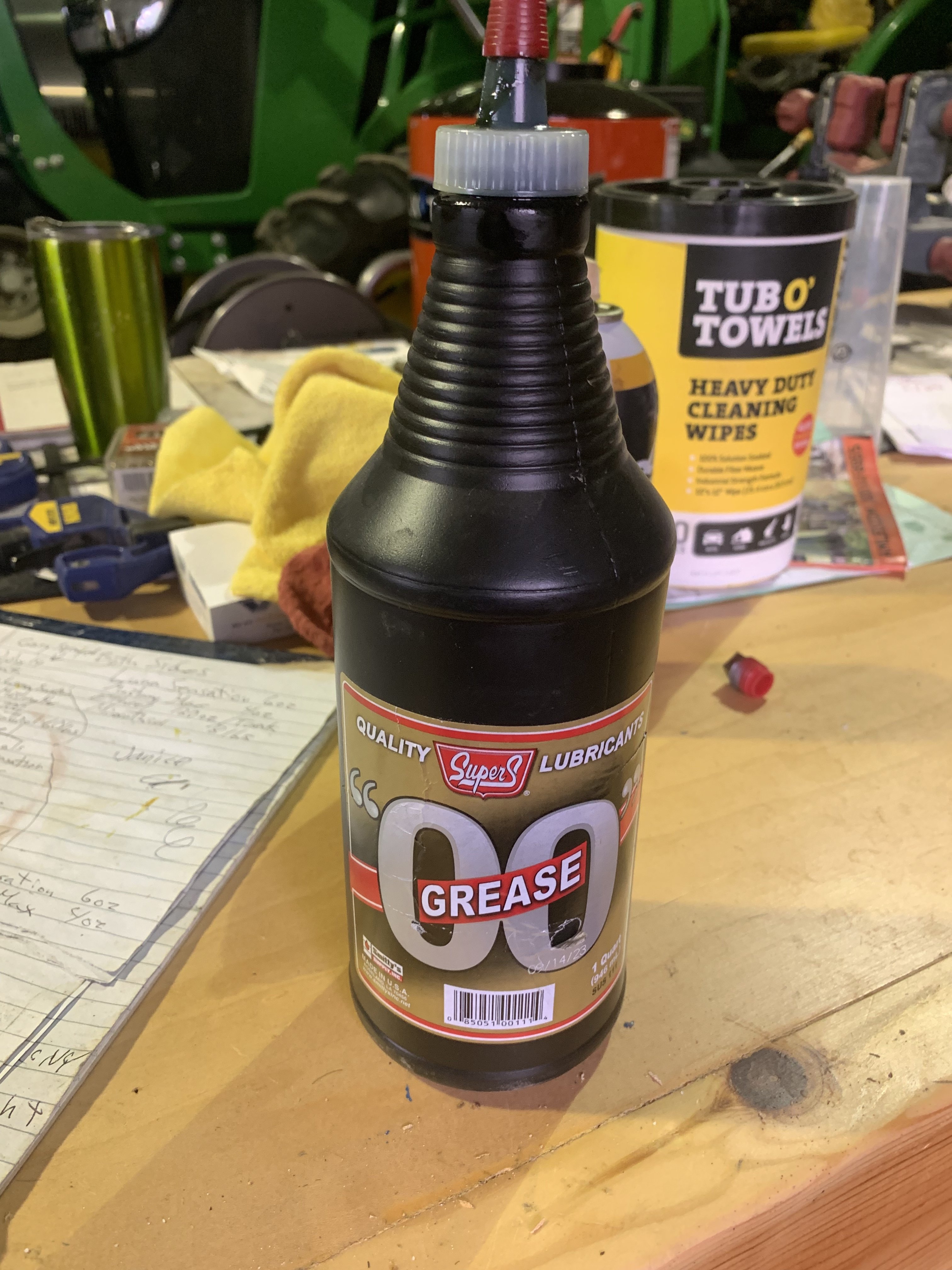

A friend has a craftsman manual transmission that specs EP 00 oil and is not finding it anywhere. I suspect this must be a very common transmission, about 25 years old.
Its always on the shelf at my TSC
