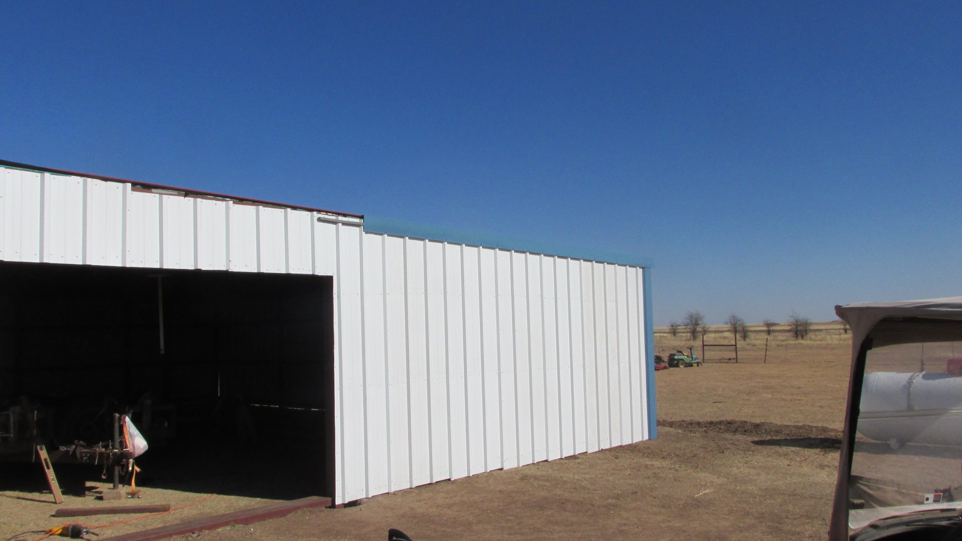

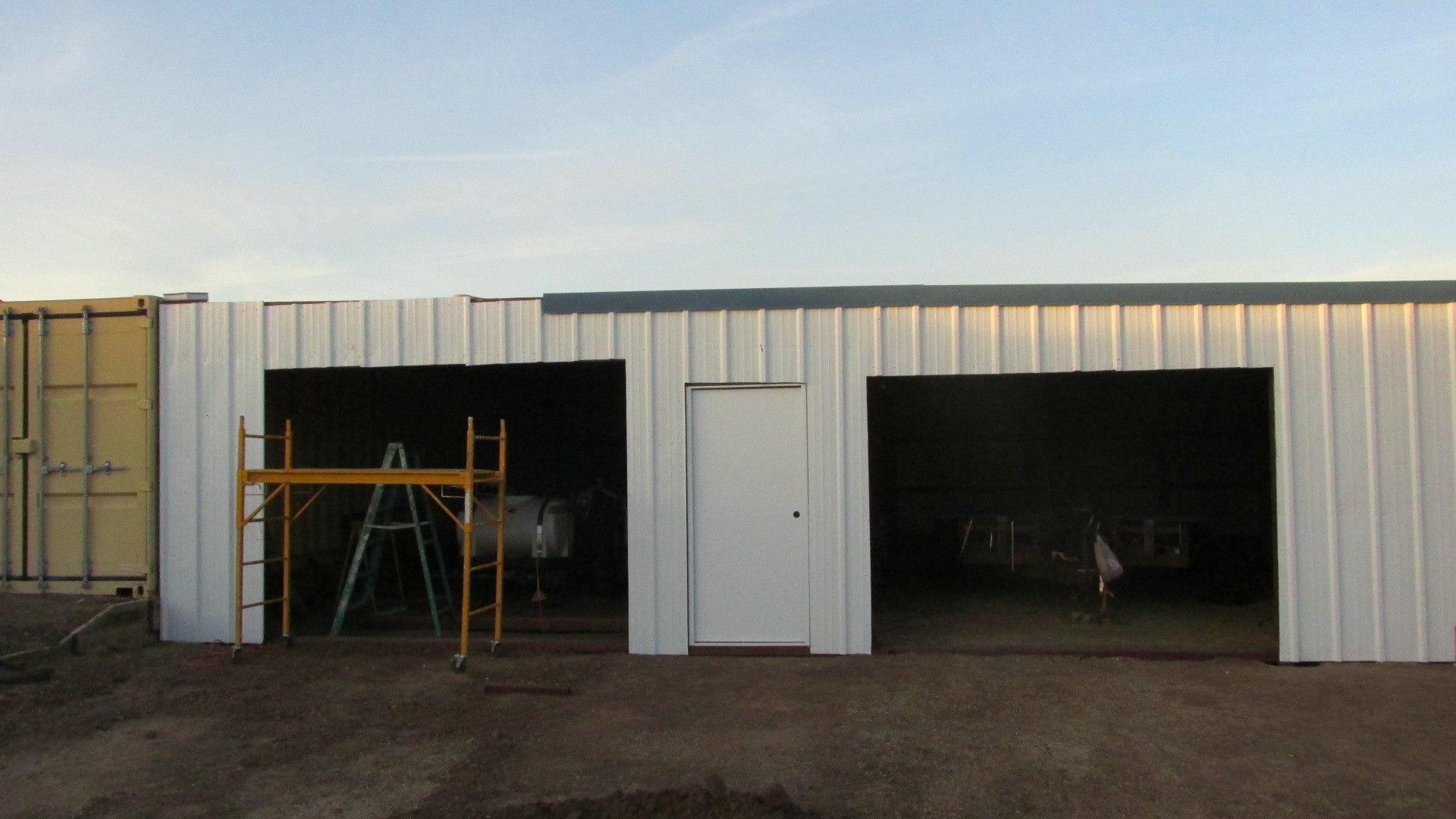

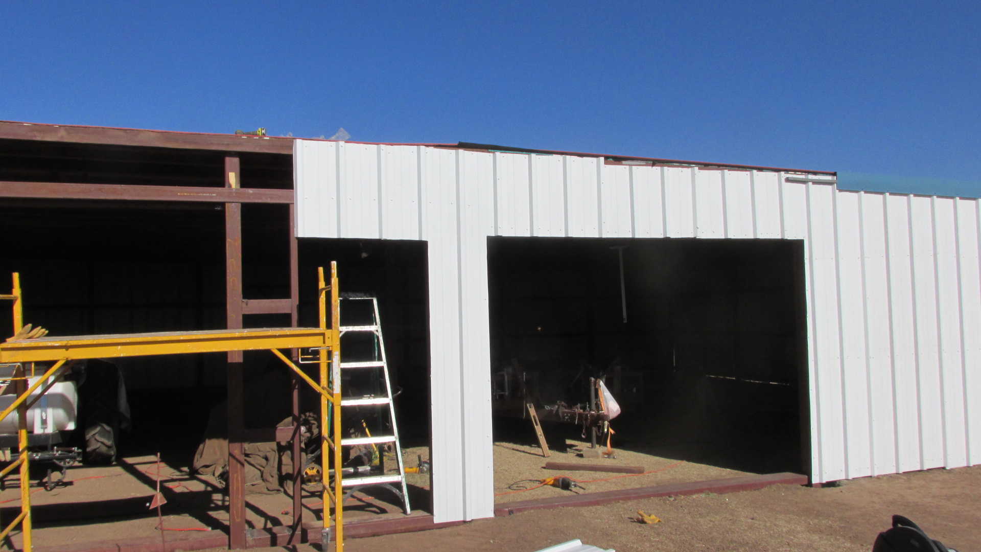

Got a little more done. Been really windy and cold the last few days. Not getting very much done.
The base the walkthrough door will set on.
Have the walk-through door installed.
Starting the metal for the front of the building.

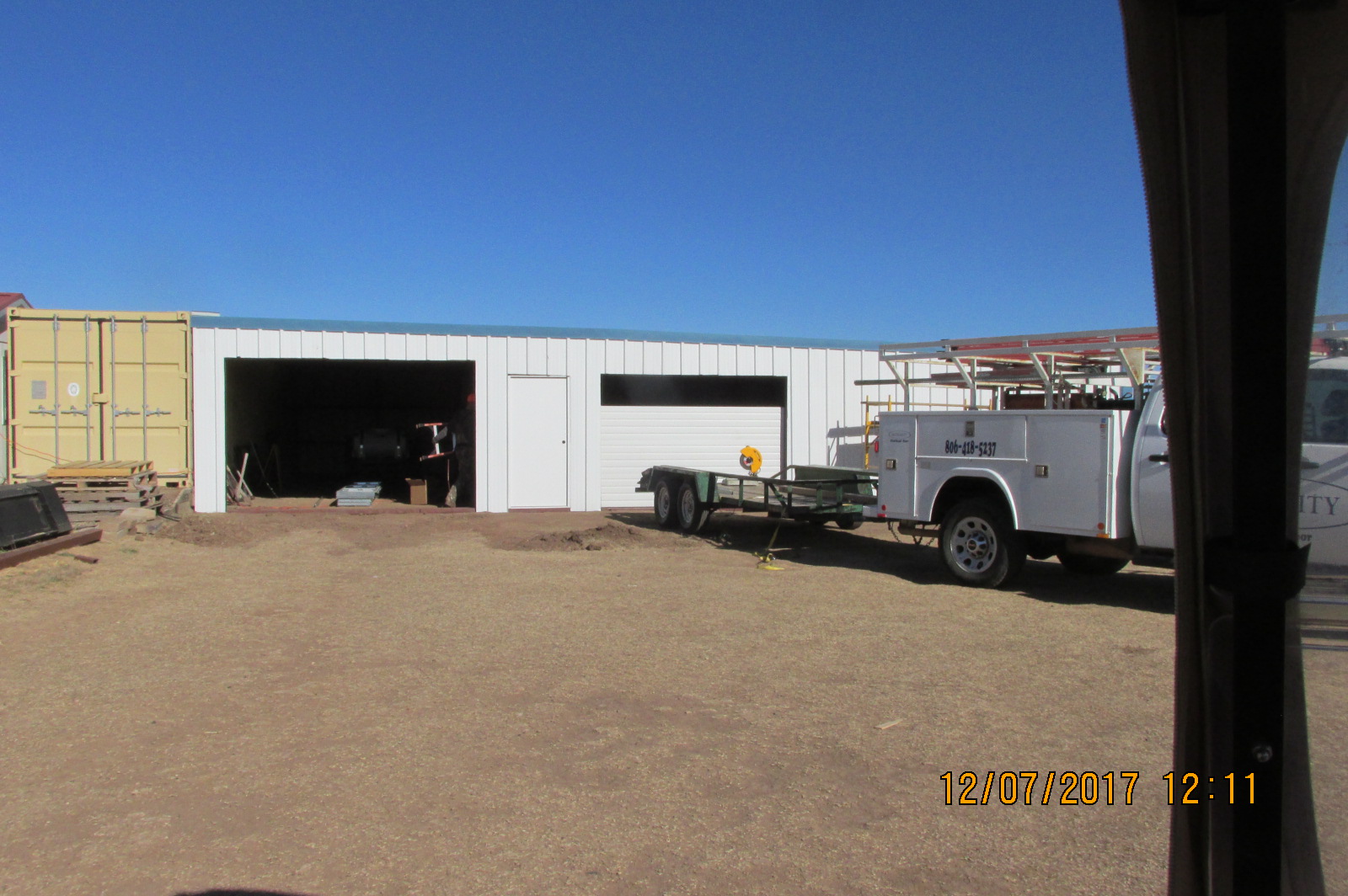

Little brain teaser question. Do you know why he parked the trailer that way??? :)
To make it easier to put sheets on the roof. Jon

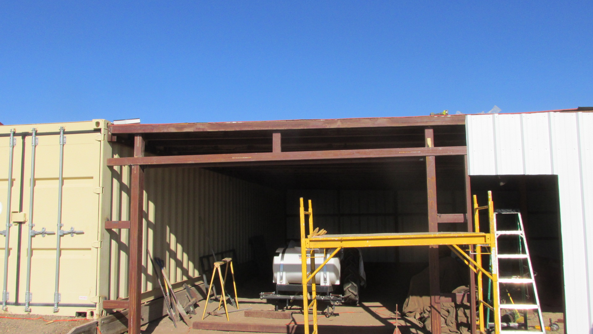

I see you bolted a ledger through the side of the shipping container. Did you have another ledger type support on the inside of the shipping container as well?

Just big flat washers.
The trailer ramps would be in the way to use the forks of the tractor if the trailer was reversed. 🏅

I am impressed. How long does red iron installed this way, last in the ground?

That would be a hard question to answer. The post I set for this project are 1/4"x 4"x4" set between 36" to 48" deep in a 1' diameter hole with 3 or 4 80# bags of sakrete per post. My guess, (baring a tornado or such) the rest of my time here and my childrens time.

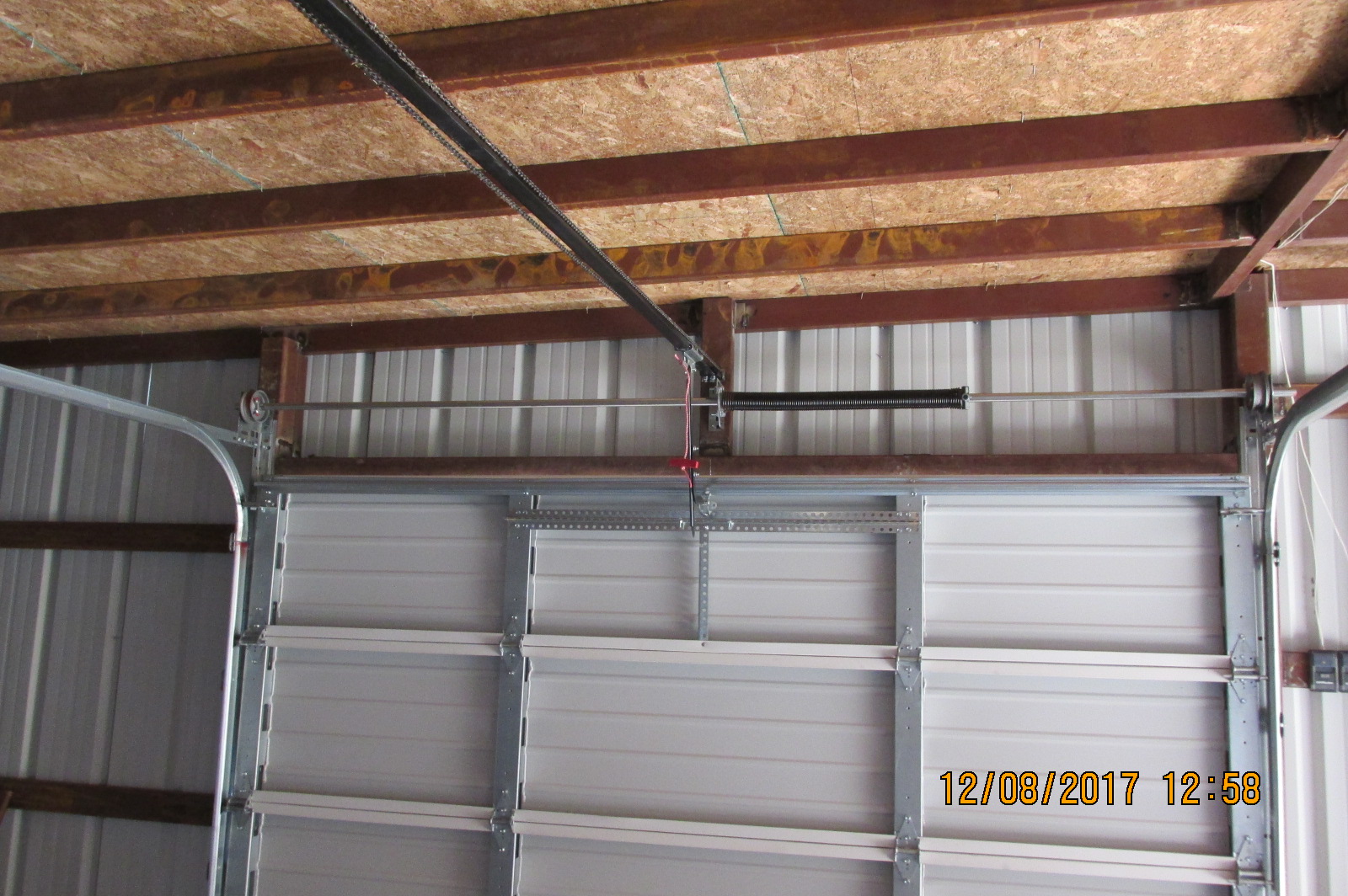

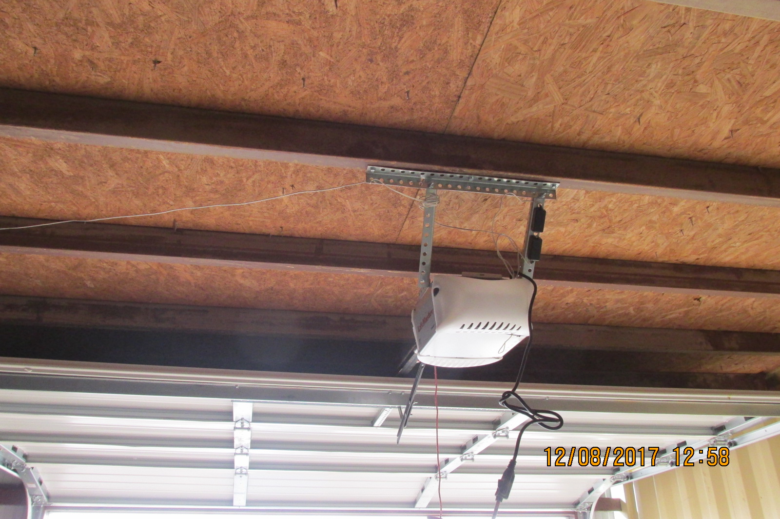

Getting the overhead doors installed today.
