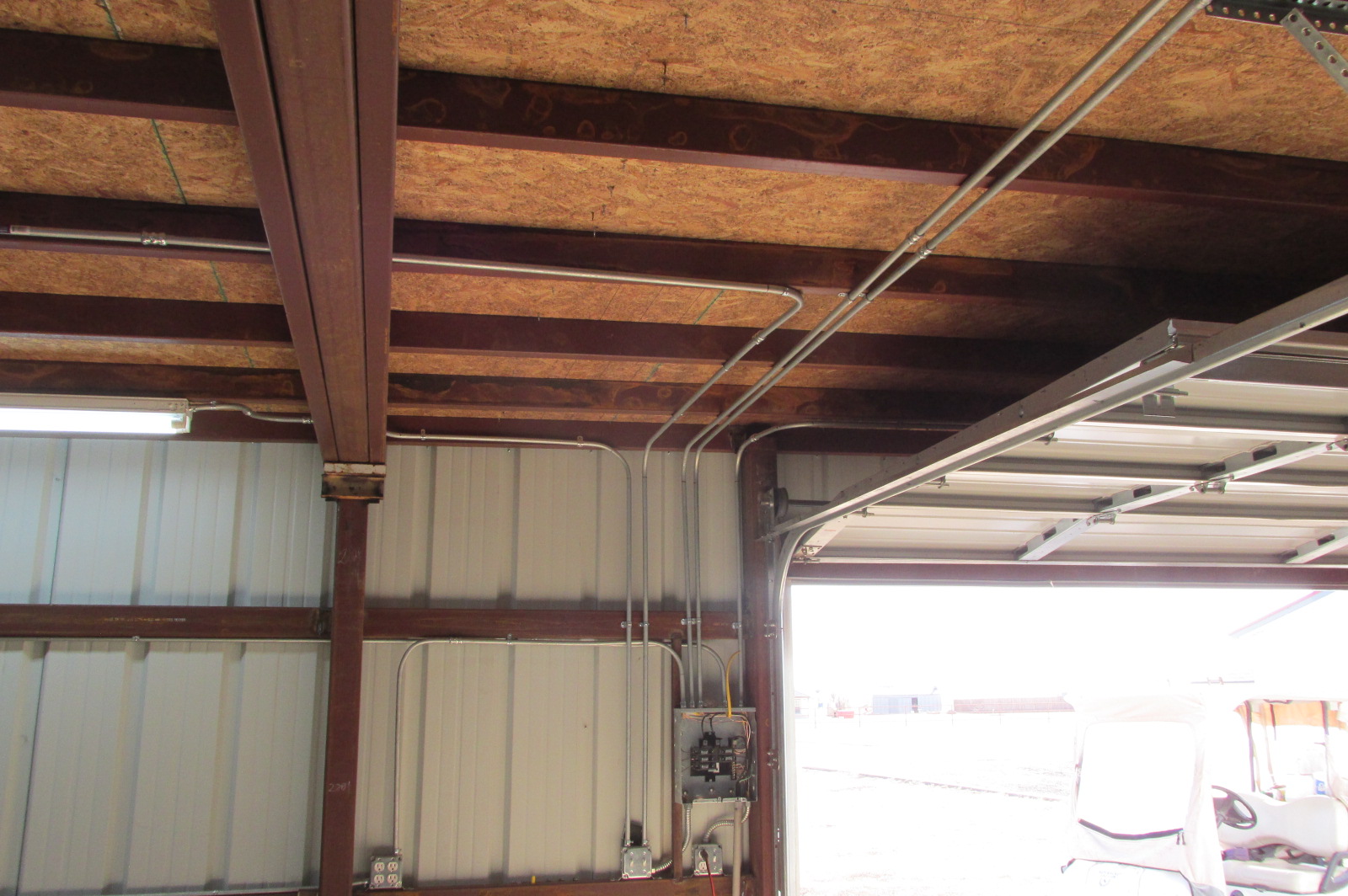

Up Date on my project
Electrical
This section has the control circuits for the 2 overhead door openers.
Circuit to the container for 1 8' LED light and 1 plug.
The rest of the pictures are of lights and plugs.
   / Equipment shed. #74
Nice job with your conduit. I only see pros doing this.

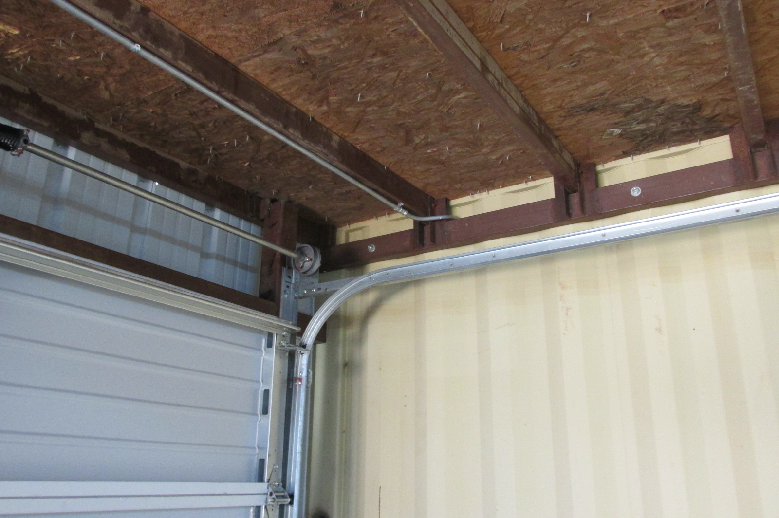

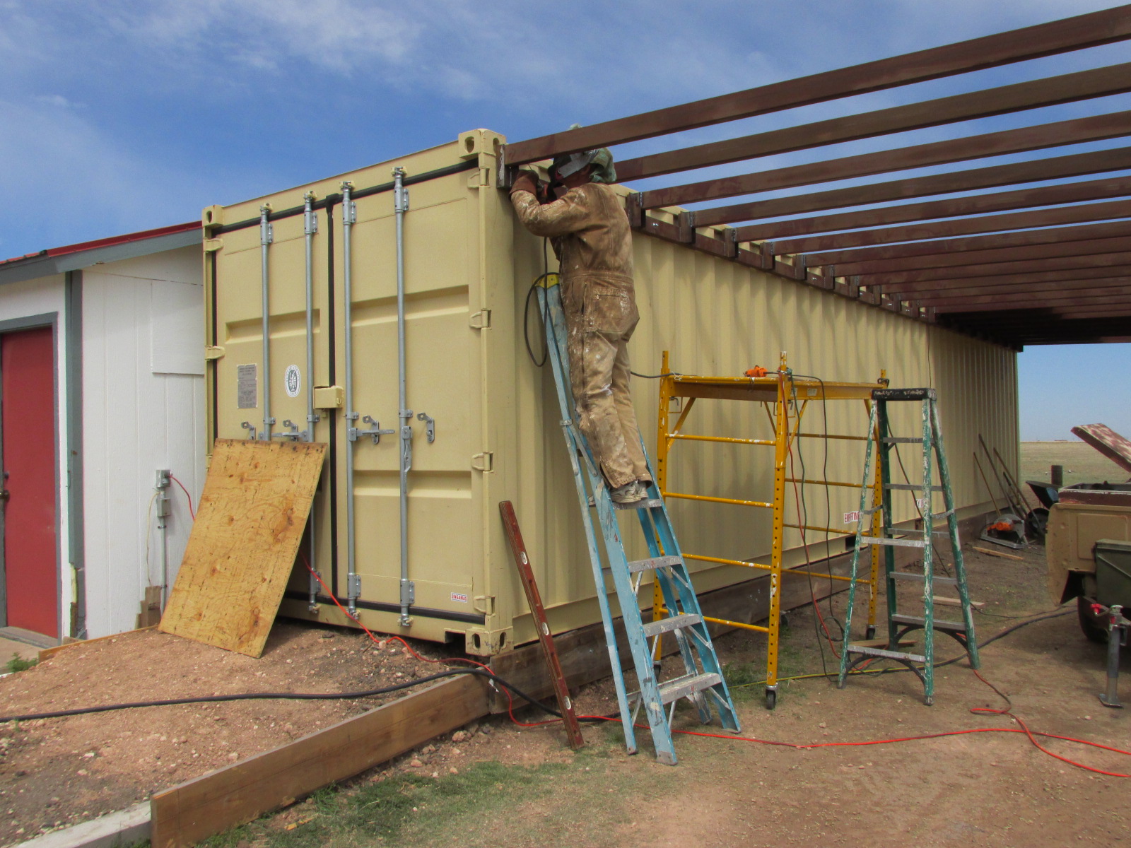

I started out with a 40 foot shipping containers. I built a shed and it was attached to the container. That shed was 20'x40' To start this addition to the existing 20'x40' shed, I had to remove the TRIM on the existing shed, 2 nd picture.
Origional shed. I removed the blue trim.
When I get all finished it will have a total of 2000 Sq. ft and be fully enclosed with 2 overhead doors and 1 walkthrough.
I have basically the same thing but 2 40 foot containers spaced 20 feet apart. My thoughts are to weld channels to both containers length wise and then insert the purlin into the channel. Is there a reason you didn稚 try to accomplish the project like that? Am I missing something.

I see no reason why that would not work for you. The way I done this is because I could build the header in the shop and then bolt it to the container.

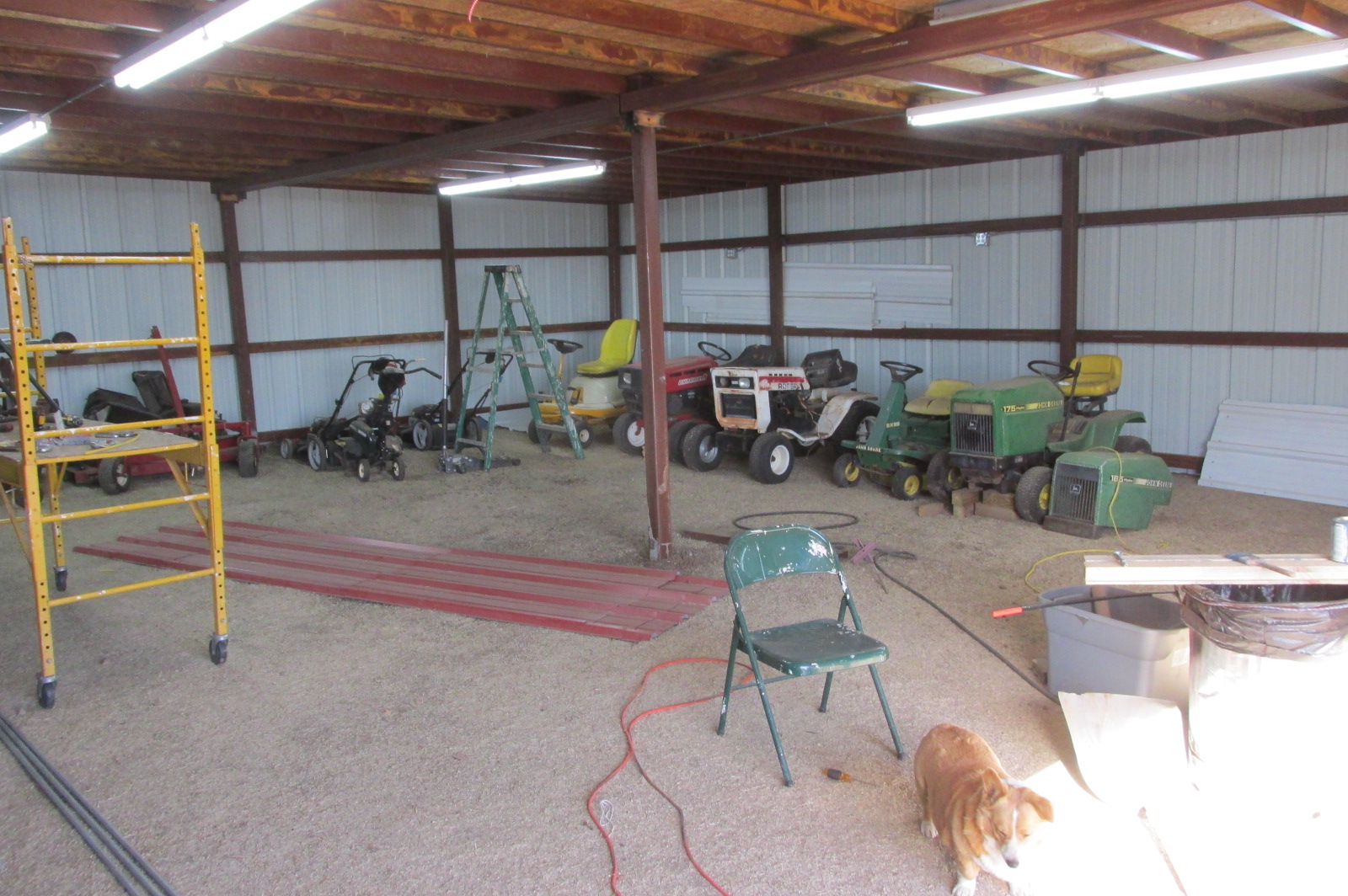

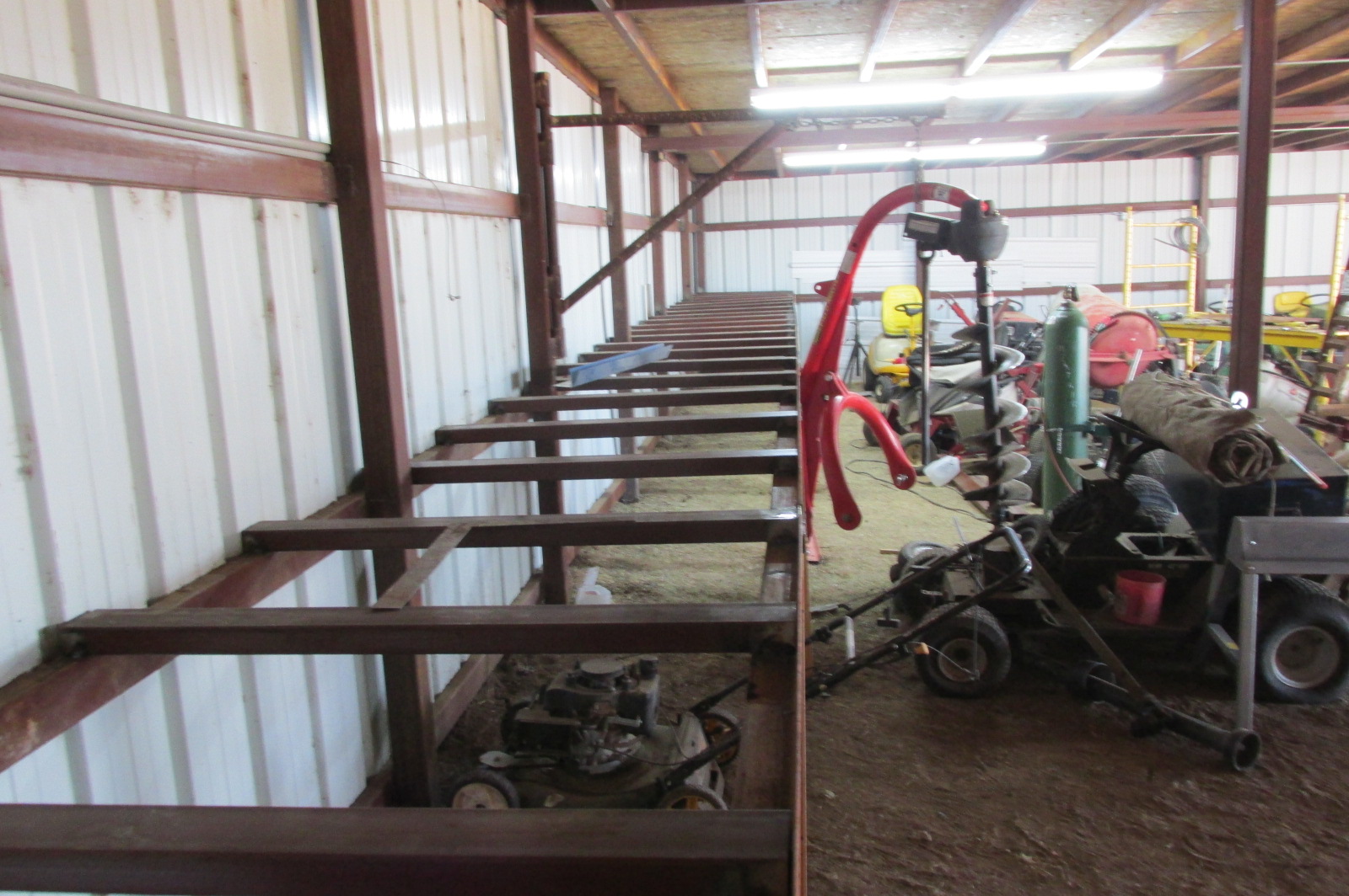

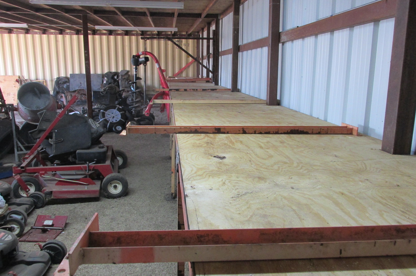

#77
Update
Building Shelves in my new shed. This shelve is 4' x 50'
These brackets will be installed as Cantilevers 3'or 4' above the shelve for storing sheet metal.

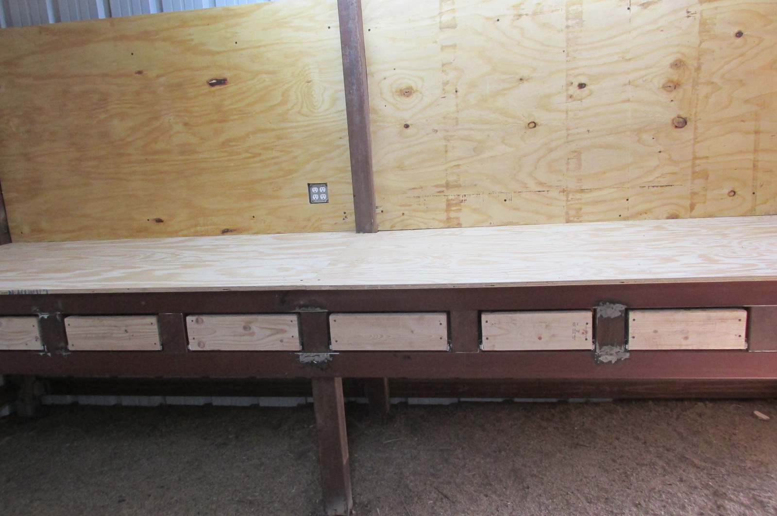

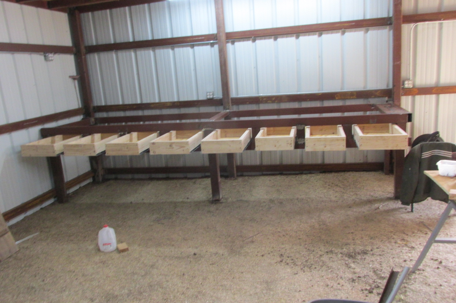

#79

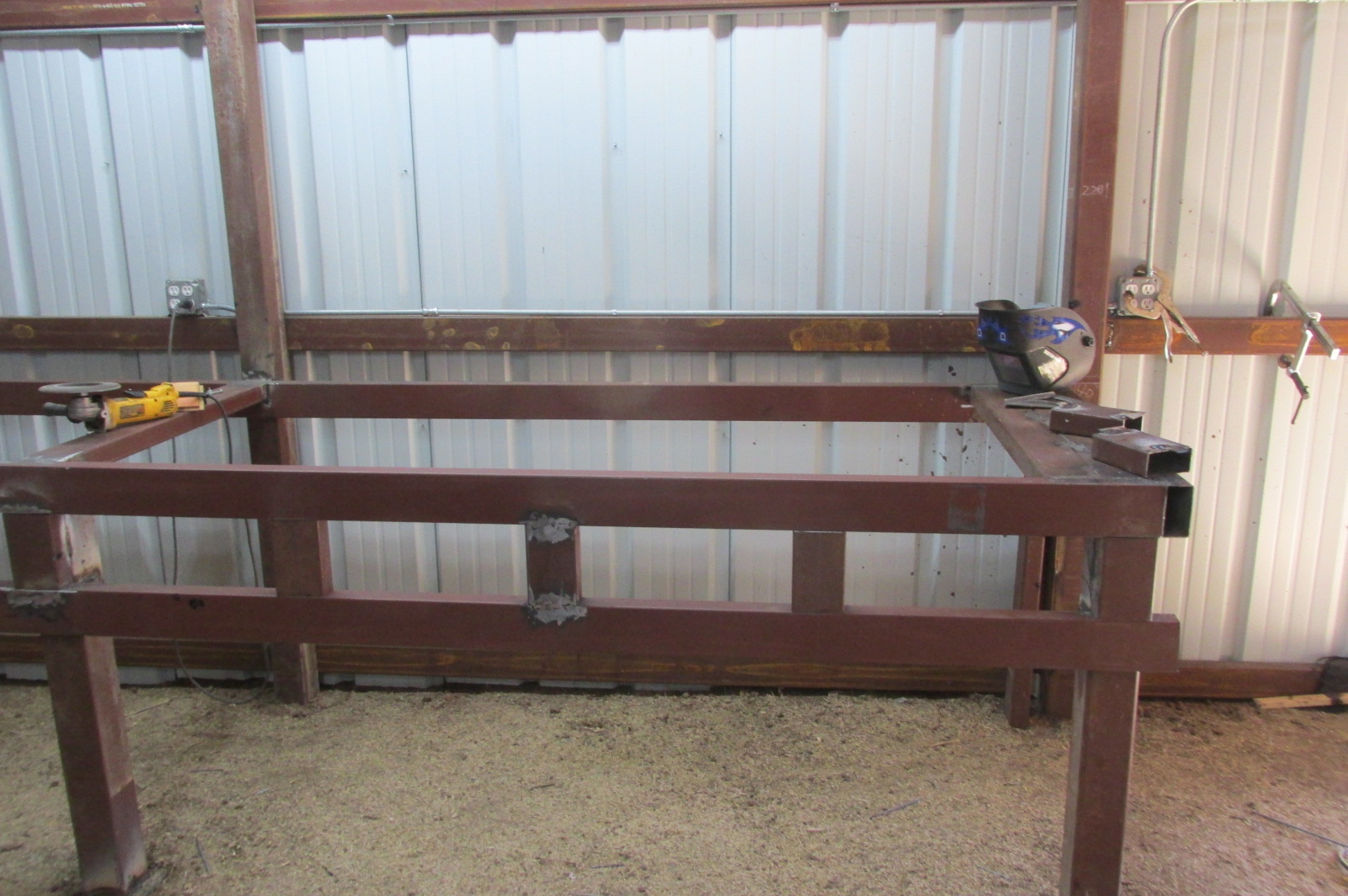

Update
Building my workbench in my new shed.
   / Equipment shed. #80
Those drawers tuned out really nice!!!!
