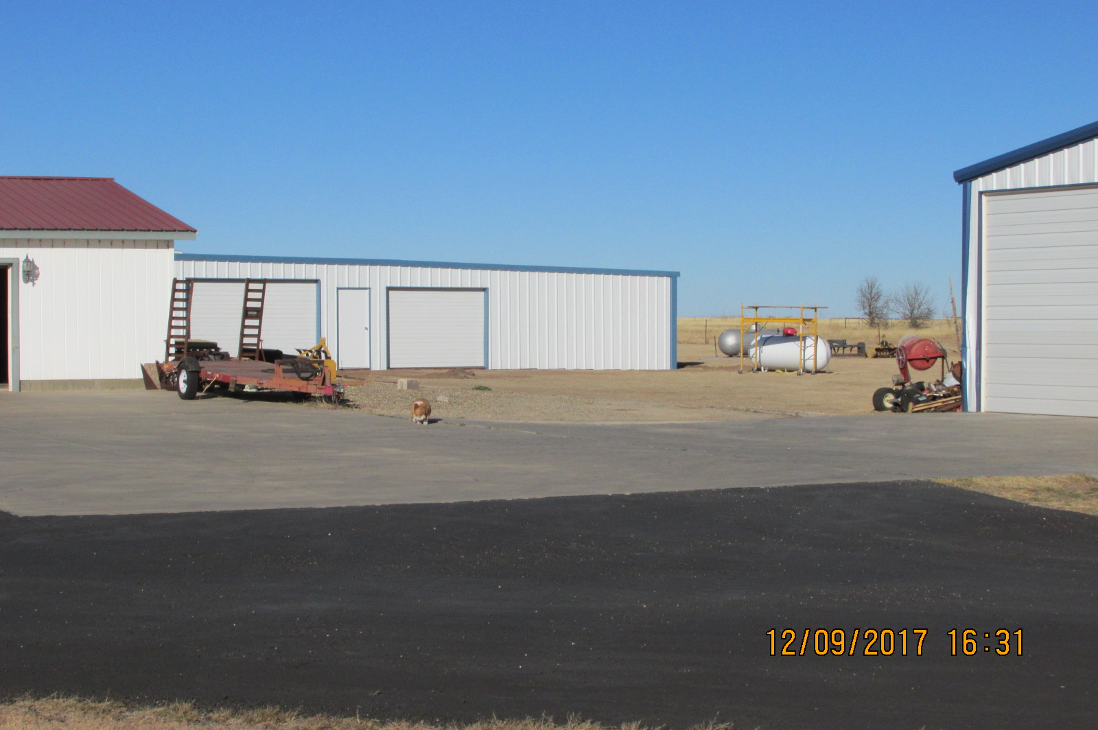

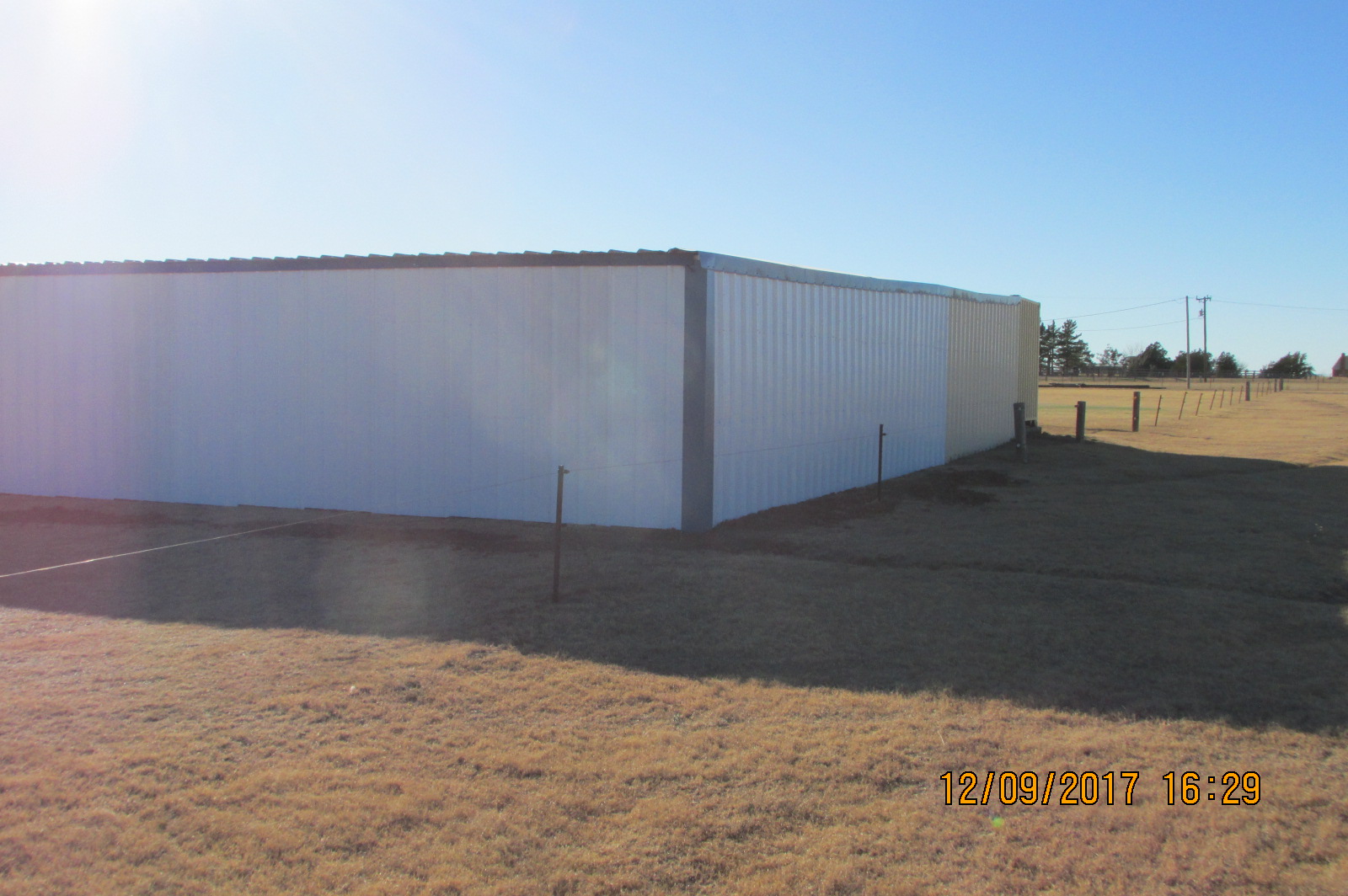

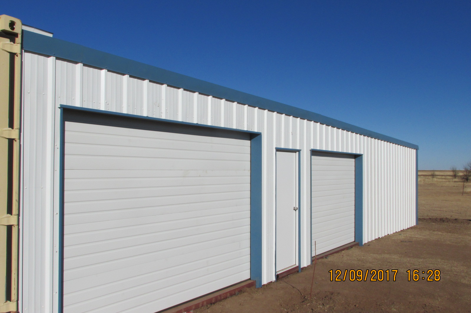

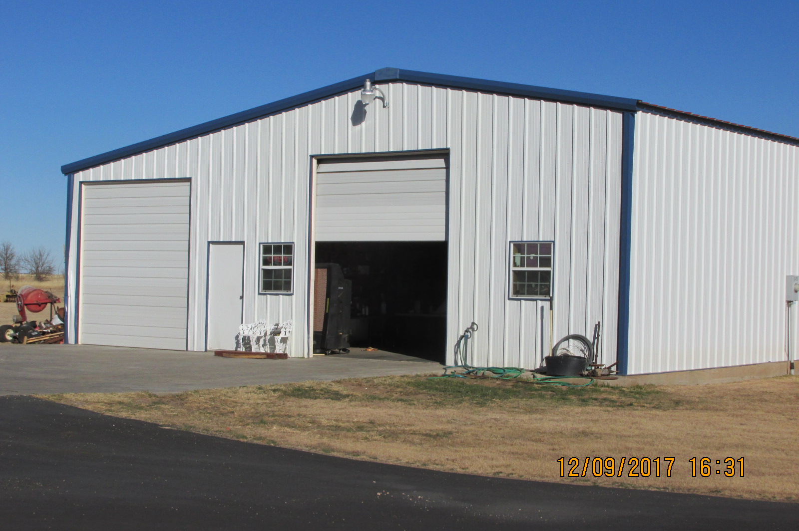

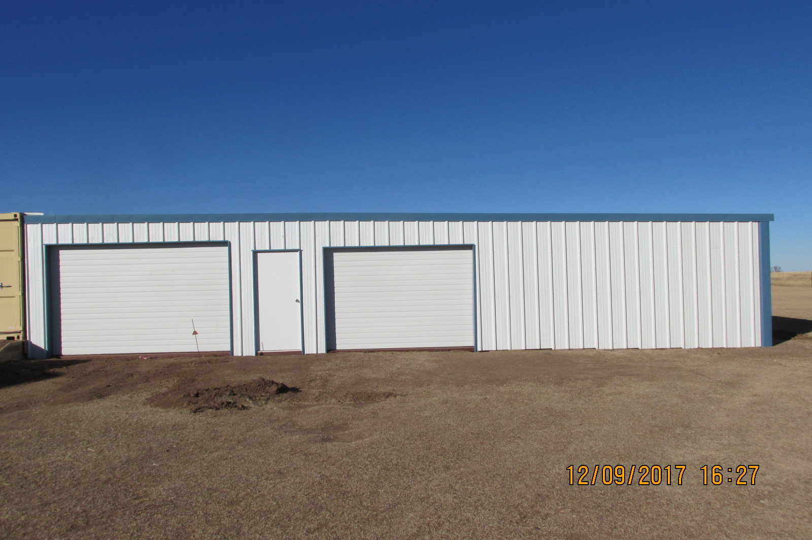

Today I trim out the overhead doors.
My shop building, 40'x50'.
Now I will start the inside work.
1. First will be the wiring.
2. Then I will build a bunch of shelves. The first shelve will be 4' deep and 50' long.
3. Then add as needed.
I started this project on 11/4/2017 and finished to this point on 12/09/2017. I had 1 man help me put the roof metal on.(30'.6") The rest of the project was done by myself with the help of my wife. Not bad for a 78 year old man and a 74 year old woman.
I hope this project has been of interest to my fellow forum members. It has been a great project for me to build.
Thanks
Travis

Nice looking project! Hope you didn't make the same mistake that I did once... Mounted my florescent lights above the overhead doors. That was all fine until I opened the doors and discovered that they blocked almost all of my light!
Next time I installed roll-up doors, although admittedly they were substantially more expensive.

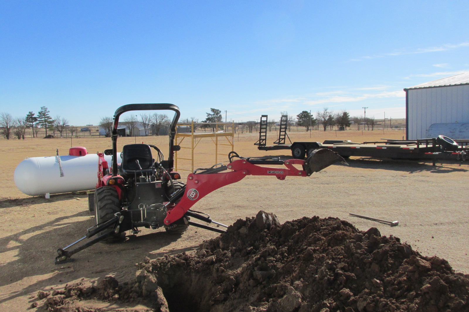

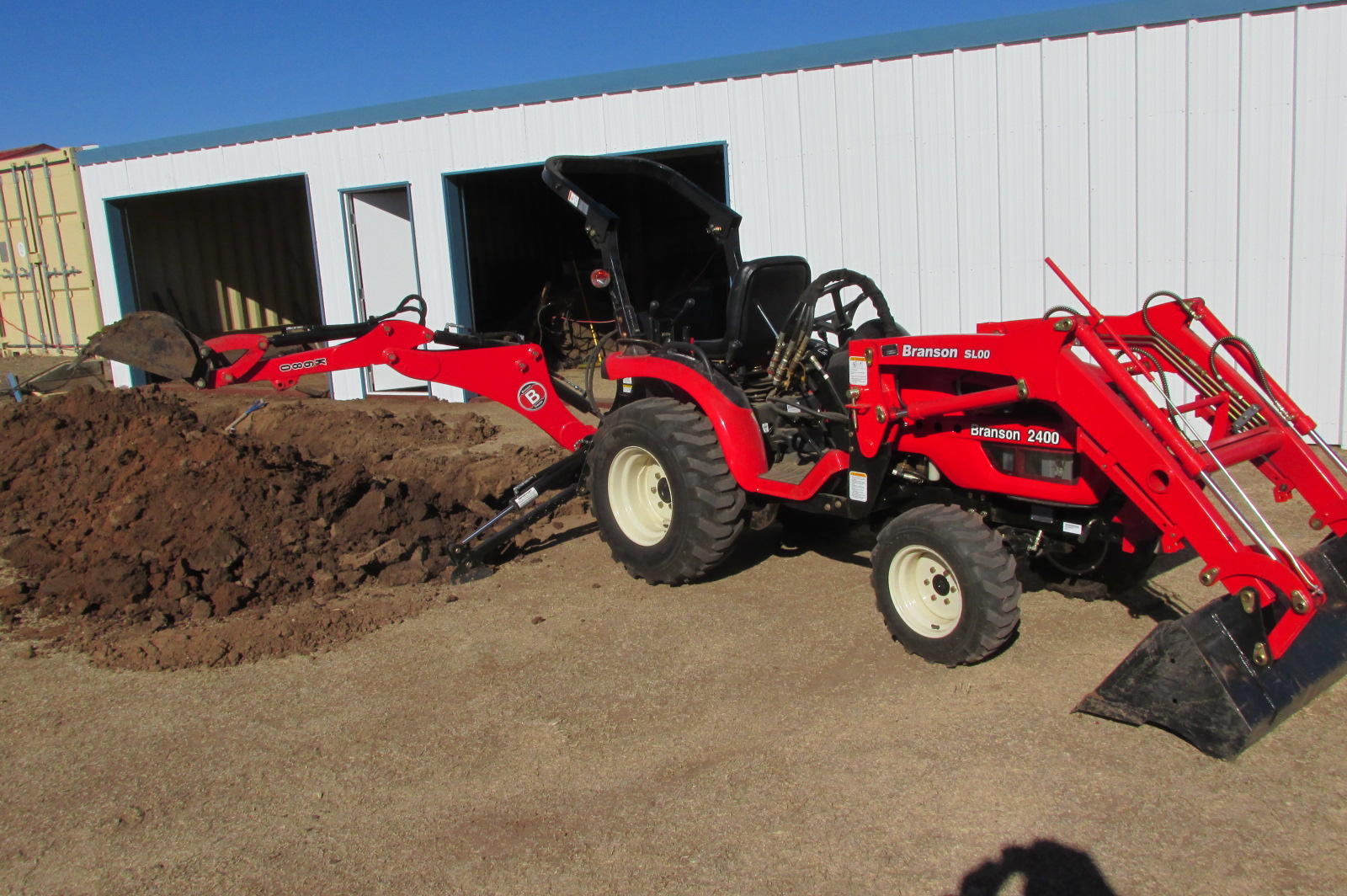

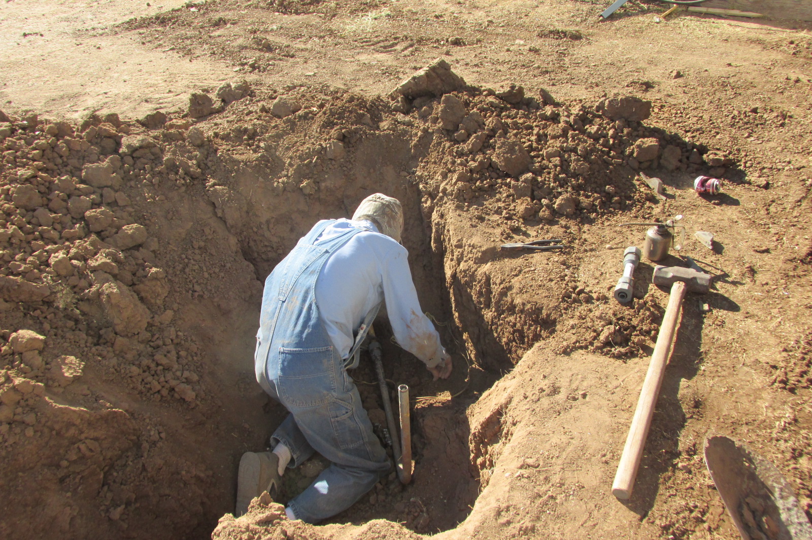

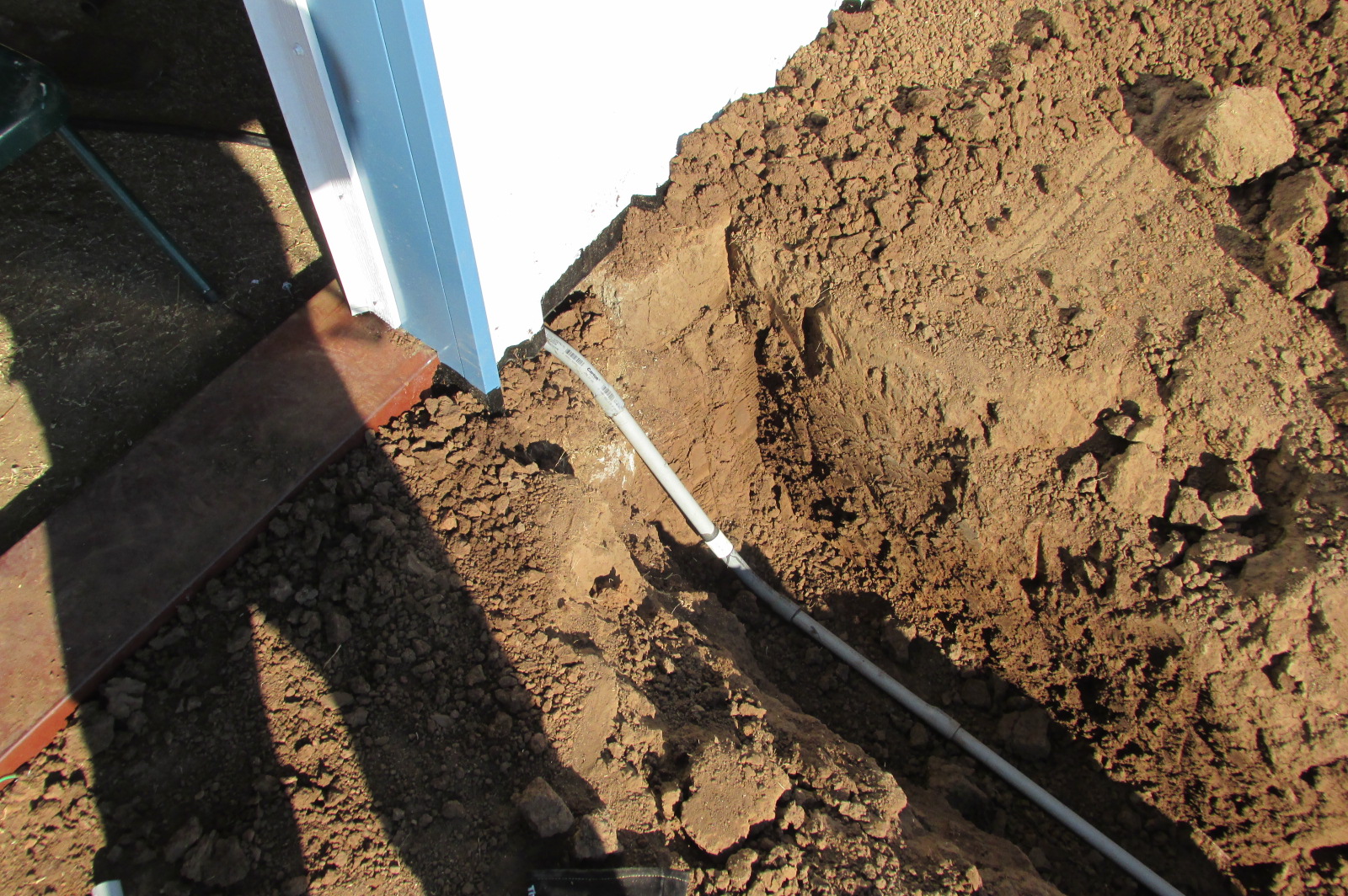

#67

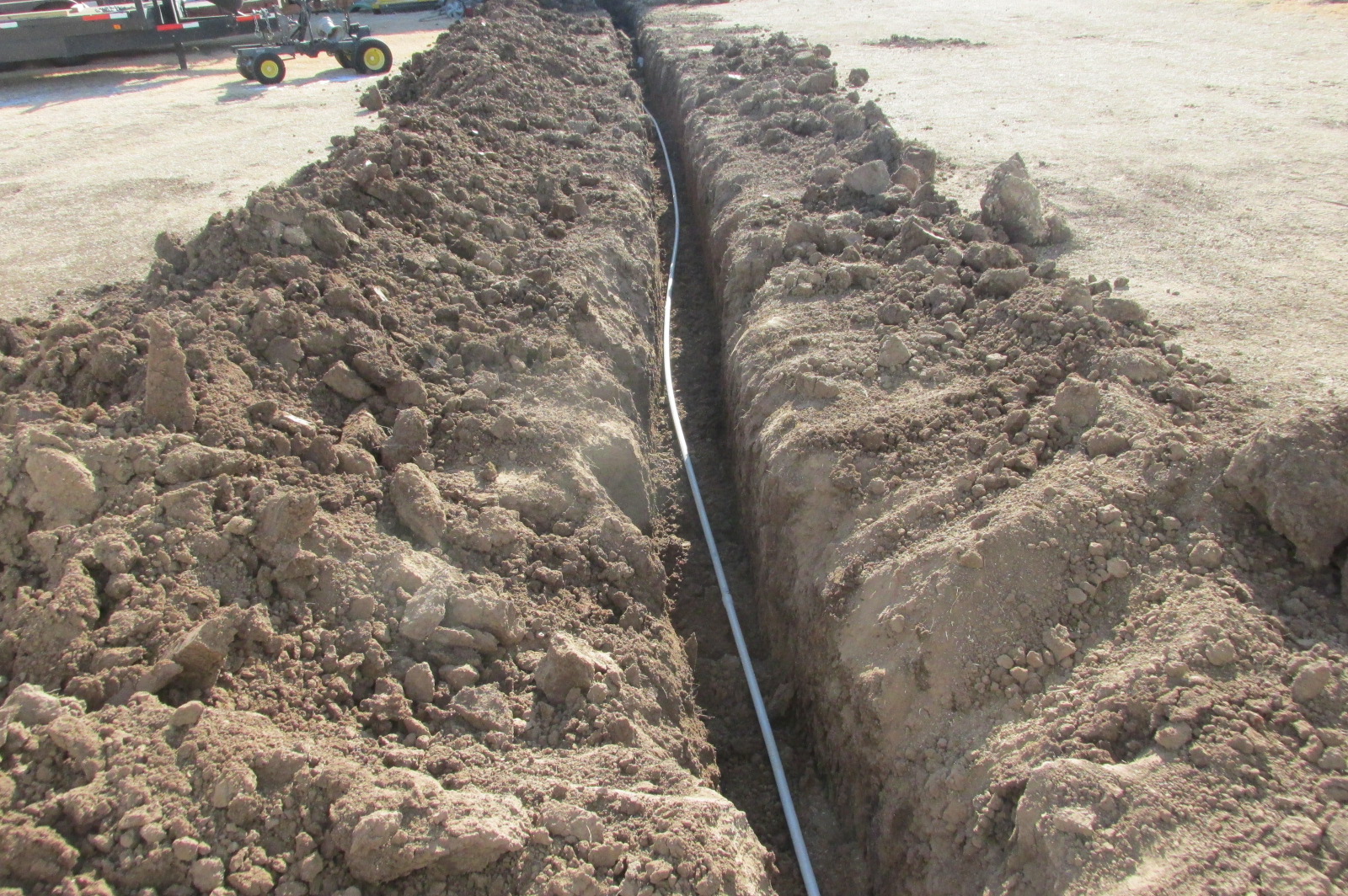

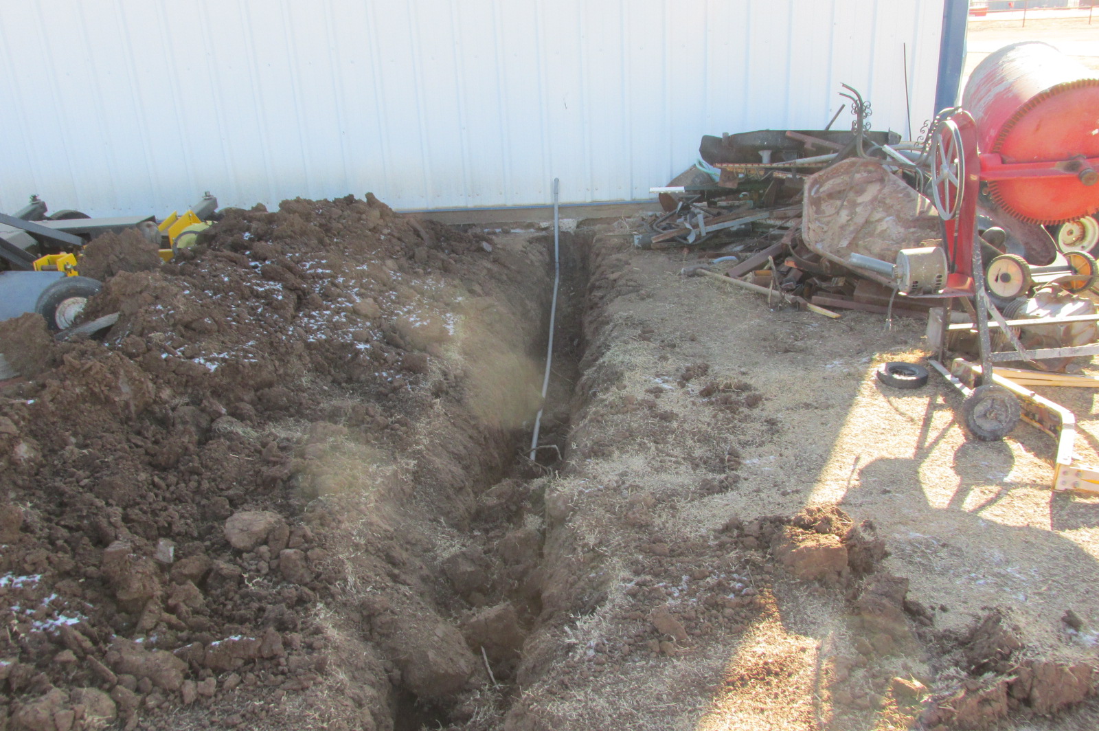

Got the ditch dug and the electric direct burial cable installed. I put the cable in conduit for additional safety.
The cable is 8/3 stranded with a ground. Sure has been cold here the last week or so, around 5* low with around 15* high. Now that I have the cable installed I can work inside where I can have a little heat.
Also had to move my propane tank.
