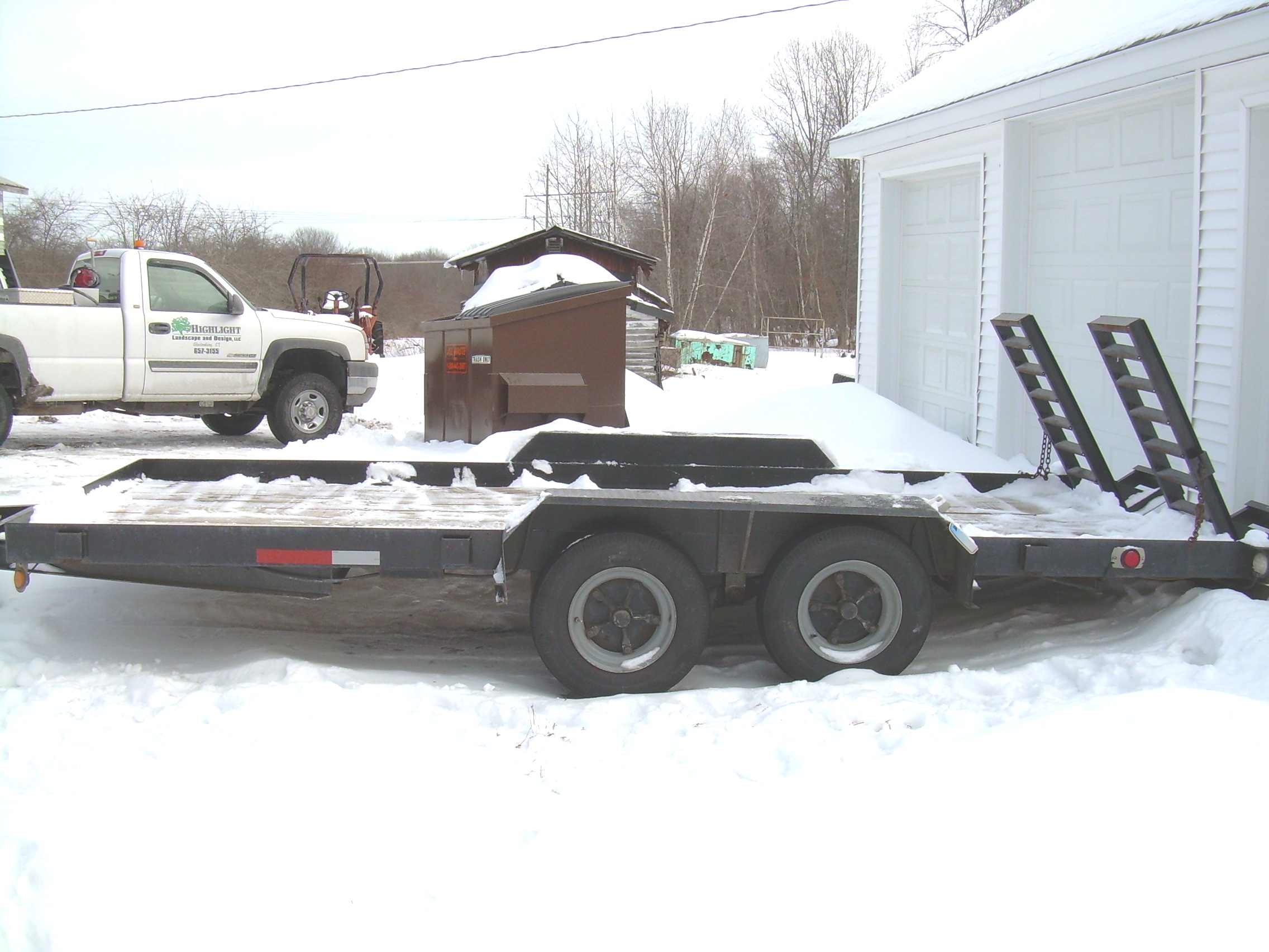

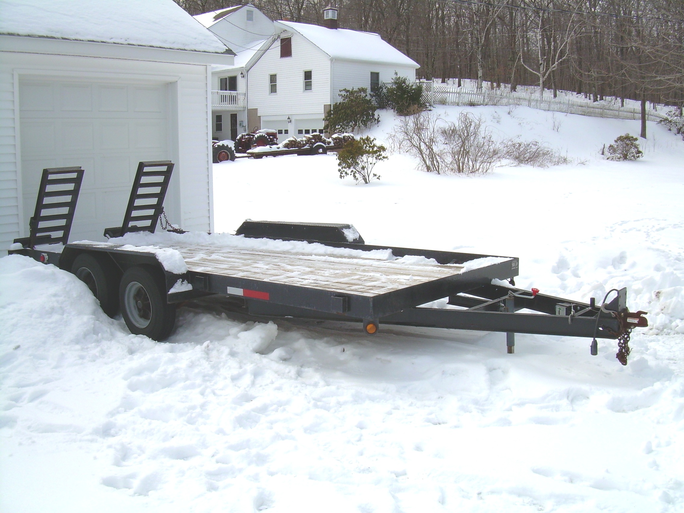

I appreciate everyone's comments, I did go see the trailer, looks decent, didn't climb under it but looks clean, otherwise I probably wouldn't consider it at 10 years old. It has Dexter axles with the older style wheels where the center of the wheel stays on the axle and just the outer rim comes off, any comments on these type wheels compared to the one piece wheels?
I'm concerned about the actual gvw, on the title it says it's a Custom model 4TS00, almost seems like it might be a 4 ton, it is registered for 9900 and the tag says 9900. But I've seen other trailers supposedly rated for 10,000 that did not have 5100# axles. I can't find a web site for "Custom trailer"?
The owner already said he'll go down to $1,500. I may play this like a poker hand, I don't need it so I might wait him out and see if he really wants to sell the thing, I may offer him $1,200.

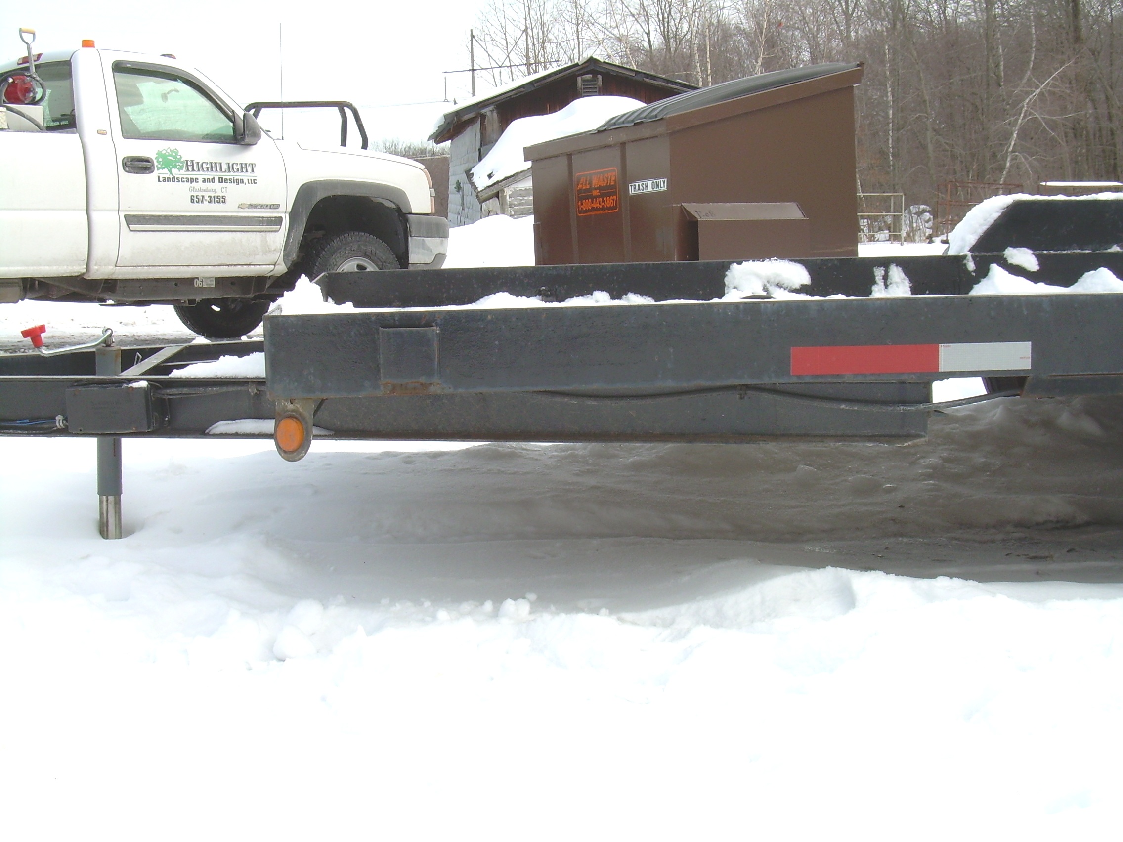

I would stay away from anything with 2 piece wheels, pain to balance. I hate them being in the boat and trailer business. As for the trailer I am sure its fine but one comment on the construction. I will not sell any trailer where the A frame that makes up the tongue does not extend to the front axle area, usually where the spring mounts. Like I said with a used trailer that does not look bent up from your second picture I think it will be ok but when buying new look at this. I would be interested in knowing what he hauled on it?
As for the 9900 GVWR it all has to do with cdl requirements. It probably has 5,200 or 6,000# Dexters under it.

Yeah I didn't like the look of that front frame from the beginning, You say your in the trailer business? Do you know anything about "Custom Trailer" the brand, I can't find anything on the web about a company with that name, just a bunch of generic custom references.
With that model number and frame construction I'm worried it's not a 5 ton but a 4 ton.

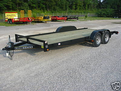

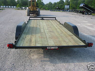

I sell boat and in turn sell trailers. I have only sold 10 or so car hauler type trailers and 2 dumps. Where do you live? I could put you in contact with some top notch dealers. I just priced a 18' car hauler type, low profile, for a guy at $1700. I think the price is very regional. I can get and sell new trailers cheaper than most used. The trailer has brakes, ramps, and a wood deck. 7,000GVWR Here is a pic of it.
The only change I would have them make when manufacturing a trailer for me is to move the tongue jack back 2 feet from the ball coupler so that you can open the lift gate of a SUV or put down the tail gate of a pick-up. I see too many with damage due to the tongue jack.
The ramps store under the trailer from the side. I like removable ramps instead of fold up ones so that if you need to haul something long that hangs over you can.
Chris

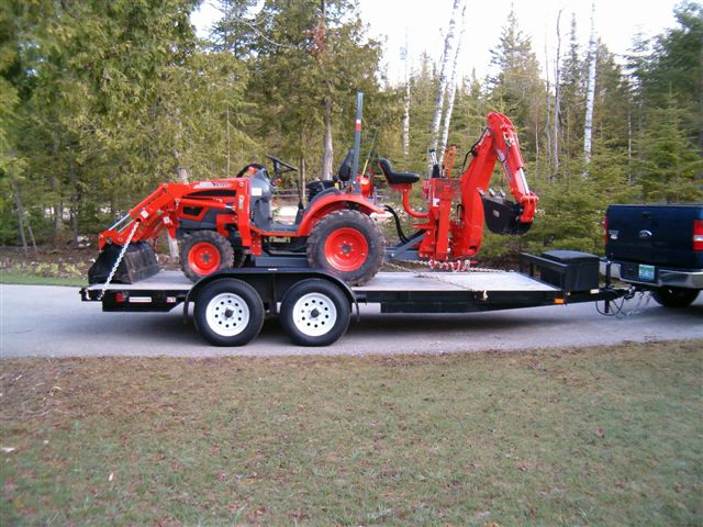

4310JB, that trailer you show is an awfully nice unit. Here's a picture of my rig. With both axles of my CK20 including backhoe & fel on my ramps at the same time, I did not like the way they bowed but it would handle it. I put these stiff legs at the midpoint and just lot the ramps settle a half inch or so when loading and unlooading. This one is 7000lb GVW and it handles the CK20 very well. When I am equipped with snowblower instead of Backhoe the hole thing weighs about 700 lbs less.
DiamondPilot shows a nice trlr also.
Loaded as you see I have about 10% of the payload on the truck (estimate only). your trailer is obviously a much better unit but mine was all I could find at the time. Probably not everybody is going to like it but it has been used and is doing the job well so far as I see. You have got set of great ramps on your rig that you are thinking of buying.
