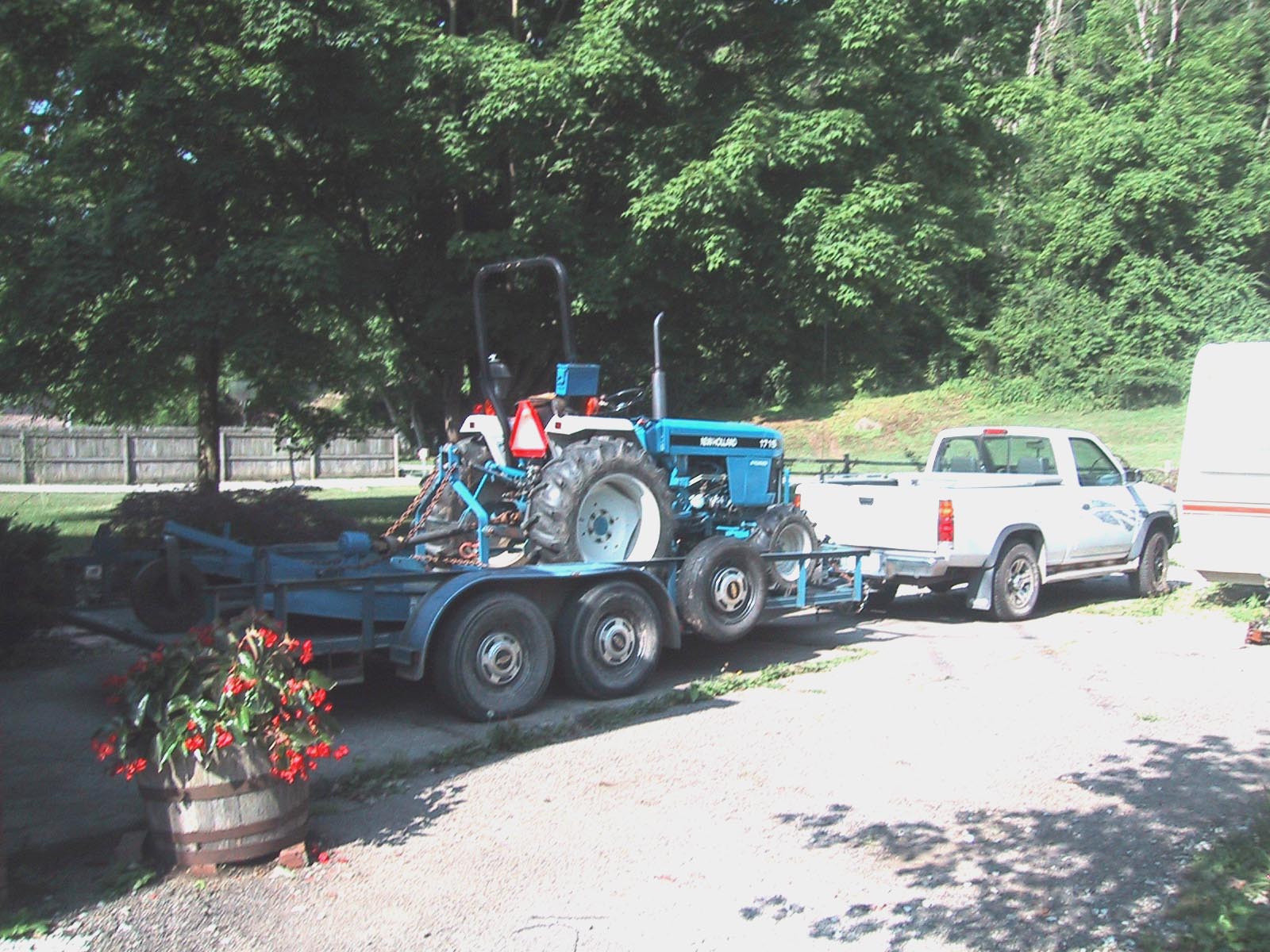

Whatever you decide to buy you will find that and wonder how you ever got along without having a trailer I have had mine 4 years is in constant use. One of the best investments I ever Made. Not only for hauling Tractor but other stuff .
I know what you mean about wondering how you got along with out something, after you get some new tool/equipment.
Is that an 18' in your picture? the machine is full forward, seems like there would be much tongue weight, but the truck's not sagging at all.
Looks good,
JB.

I do not know where to find that info. The best way is to get your tape measure and hit the dealers lot and take notes. I would say you will need a trailer 2' longer than the tractor you are planning to haul for balance purposes.
As for that mini truck not sagging I am sure he is using weight distribution hitch.
