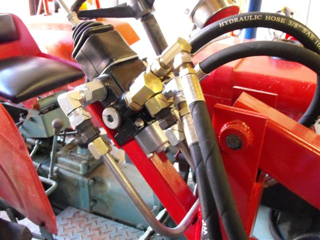

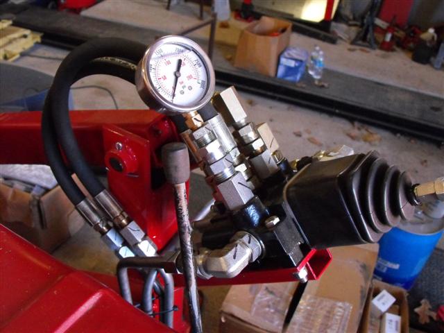

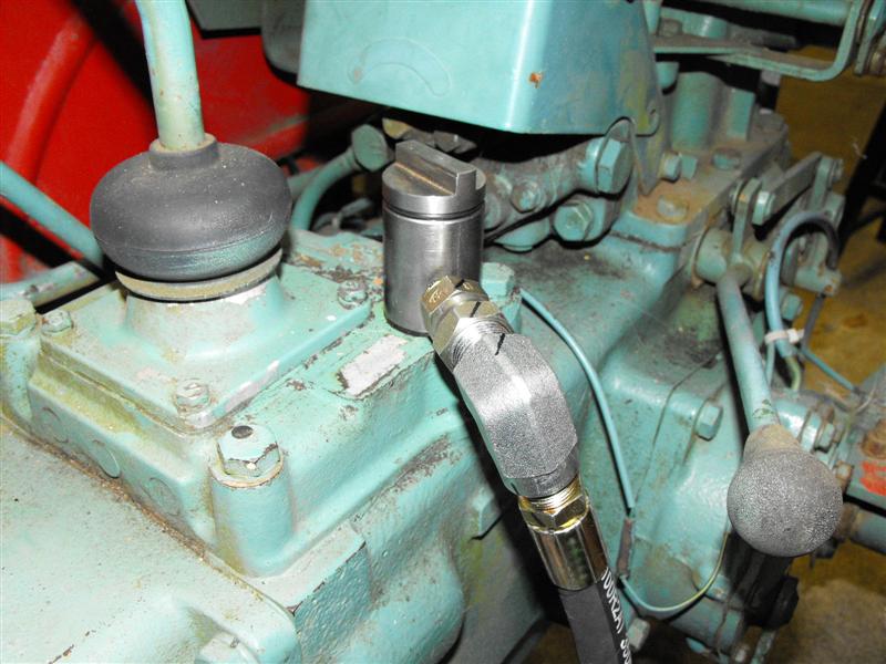

The loader valve has a PB port that goes back to the 3pt and the return line is separate from that line. The return line only flows oil when the loader valve is operated. Otherwise it has no oil flowing in it. I had to make an adapter to use my oil fill hole for the return line.

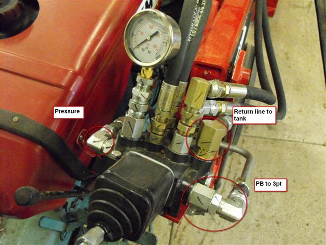

That return line to tank MUST ALWAYS flow oil in your system when valves are in neutral. If this return is the ONLY one, it must flow return oil ALL the time, even when operating. That is part of the "deal"with power beyond. If not, you valves are not plumbed in a true PB series.
I think you need to get a complete hydraulic schematic over YOUR original tractor system. Then we can see how your plumbing fits into that.

If the valve is using PB port for normal flow, then he would only have fluid in the return port when using the cyl.
A gear pump will pump continuously, and the fluid has to flow through something.
Picture of the valve and the hoses marked as to where they are connected would be useful.

Here are the photos of the valve plumbing.
