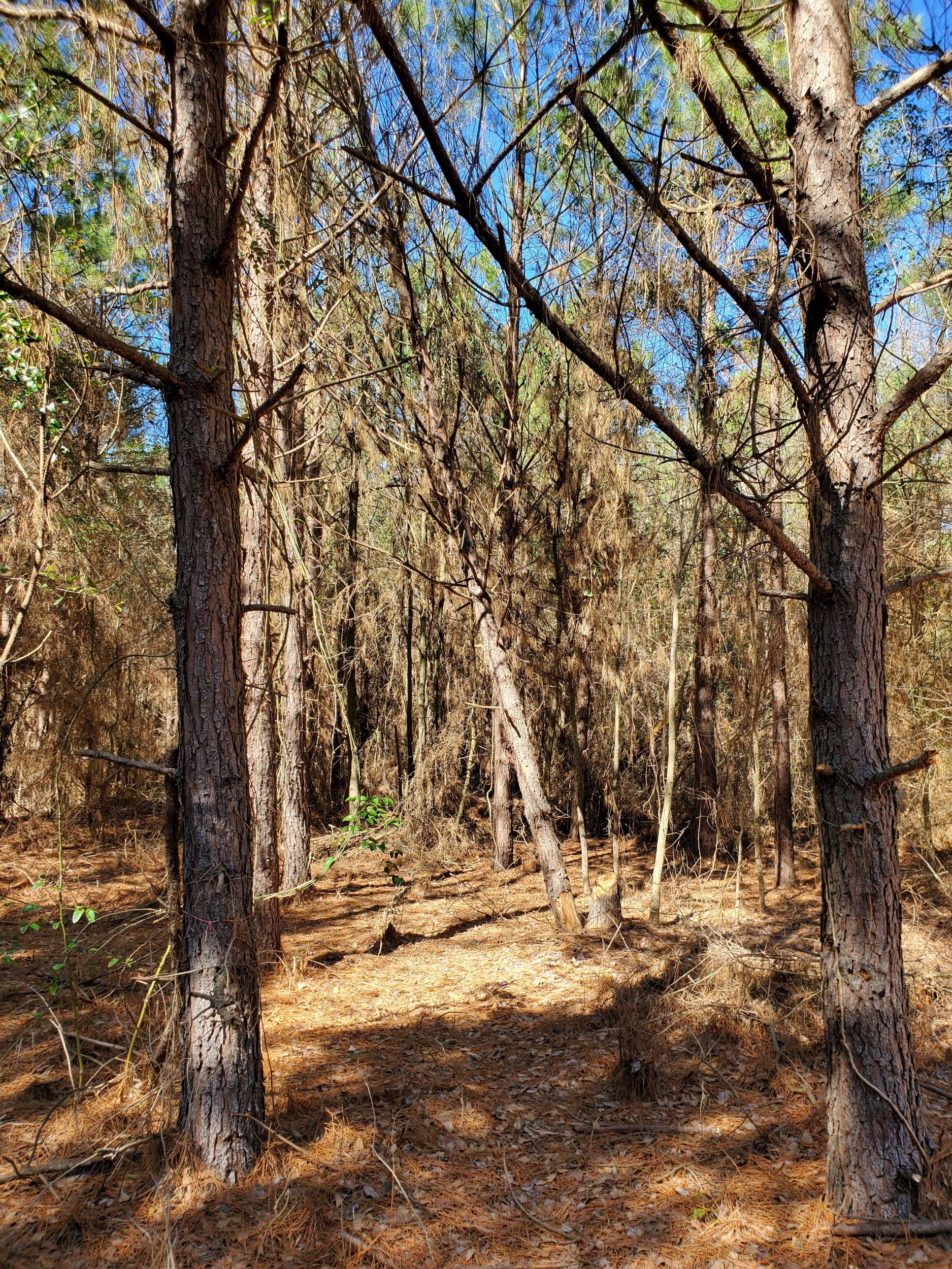

Pulling it away is probably the safest bet... What I always do is I keep cutting it until its ether fall or stands up vertical and I push it the other way... definitely scary with big trees, hard to say the diameter of this one everything looks smaller in a picture.
FYI cutting it in an angle like you did never works to make fall in that direction.

In our areas, some tractor dealers who also supply loggers will have these in stock. The key is the special slip hook, which captures the chain much better than a typical hardware store slip hook. The pin on the other end is handy for threading the chain under a log on the ground. For the size trees shown in your picture (and even a good bit larger) 5/16" grade 70 chain should be fine. Some people prefer 3/8" chain. It's stronger but significantly heavier. (I have both, but use the 5/16" most of the time.

I use a choker cable as well. That tree isn't really that big so rip it out of there with truck or tractor.

I'd want to be farther away from the tree than I'd be if the choker was connected directly to the tractor, for safety. Even though it looks straight forward from the pic there may be branches flying when it finally falls through the canopy.
If you pull from the 3pt you can roll the tractor over backwards. The geometry of the drawbar (with the bar extended!) makes that more difficult.
It looks like those woods need a lot of thinning for fire safety, especially if they're close to a building. It'll look nicer too.

Another suggestion, which I don't recall seeing; I would wrap the choker on the back side in such a manner that the tree will spin, not just drag. I sometimes will wrap it completely around the tree so that it will roll off a stump.
Yes, that is the plan. We'll be out there permanently in a few months. Until then it is a few hours of work sandwiched between 2.5 drives.
