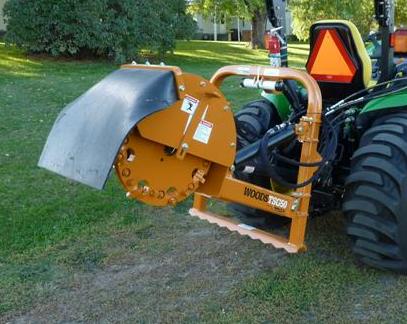

Not snow blower related, but I saved the pic of your stump grinder - I'm wondering about adding a hydraulic extender to one of these so it could advance without moving the "planted" tractor. What do you think?
