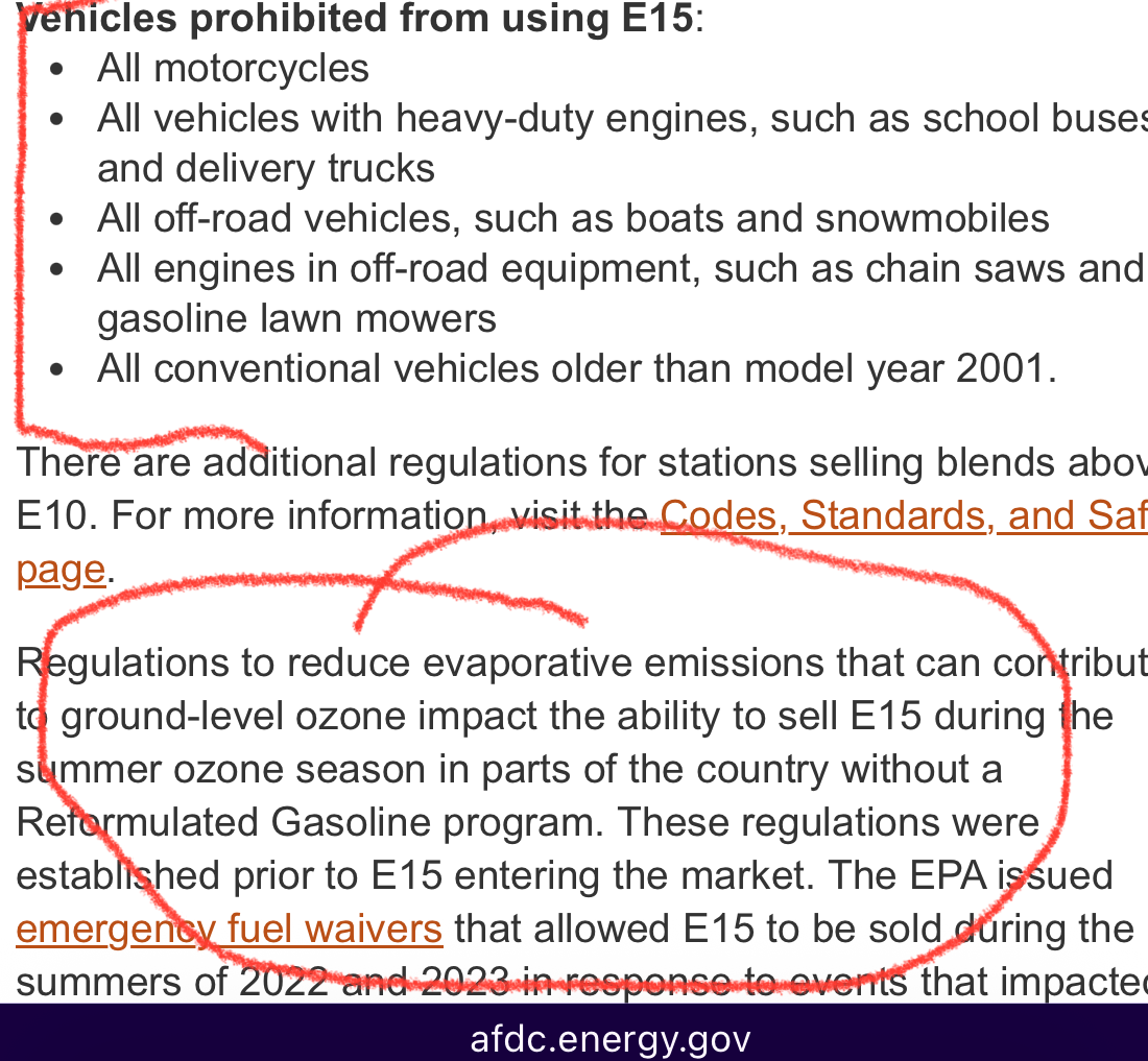

The EPA is allowing Illinois and a bunch of other states to sell E15 year-round now. I'm not happy about it and pumps have new stickers on them. The sticker I read last night said not to run E15 in anything pre-2001.
   / Ethanol Free Gas #173
From DOE themselves
Fun, fun

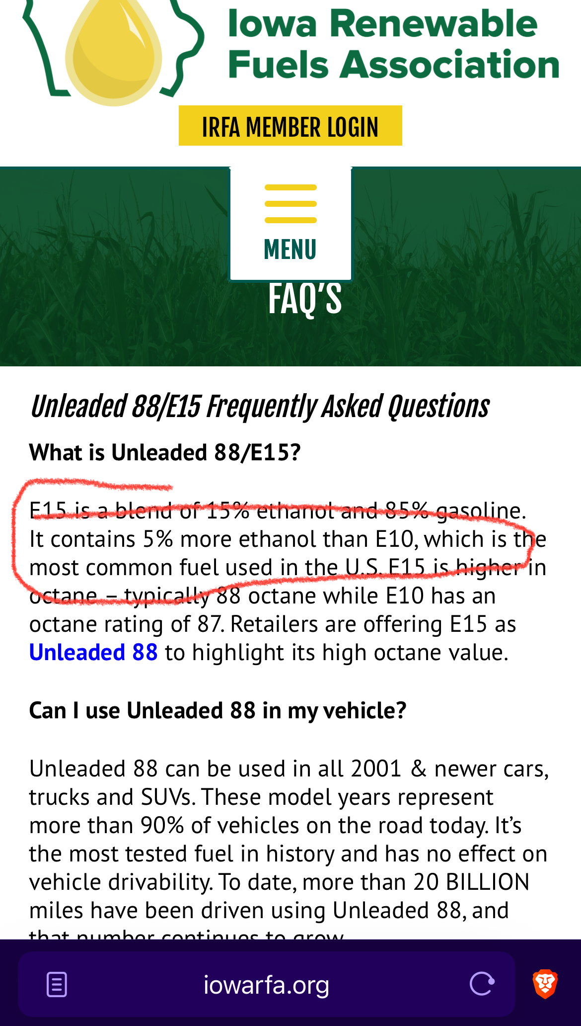

Really intelligent people writing for Iowa. E15 contains 50% more ethanol than E10. Not 5%.
And after all this time, nobody noticed and corrected it? Done on purpose to fool the sheep?
   / Ethanol Free Gas #176
Good point. I think it is more likely ignorance than purposeful. Many people don't understand that a 5 percentage point change is not the same thing as a 5% change.
