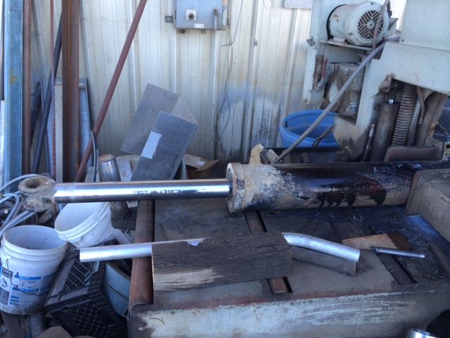

Well the search it continuing. I found a 6"x25' ram at a recycling center/ junkyard. Got it for scrap price…. $45 :drink: Seams to be in decent shape.

Here are some pics of the ram.

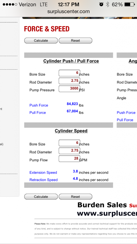

And here is the calc for it capacity.
I guess I'll be beefing up my H beam:D
