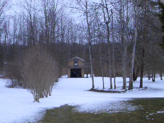

Well, this has turned interesting. The EPOD line in question is a FEMA 100-year flood boundary at 570' topo elevation. On the town EPOD map, it shows the shed location outside the line. However, the topo elevation lines on a 30-year old subdivision map show the line location in a completely different place on the property. Of course, the shed is just within the boundary on that map. Town officials say their town prepared EPOD maps are only an 'approximation'.
Therefore, the issue now becomes one of not whether the shed is grandfathered for building in an EPOD but, rather, whether it can be there at all because long-standing FEMA restrictions are involved. Out of the frying pan into the fire - definitely a turn for the worse. The goods new is that the map has a possibility of questionable accuracy. The topo lines on the subdivision map were not actually shot; apparently it is common practice to simply superimpose the FEMA provided topo lines on subdivision maps as a cost savings measure. And a lot of the FEMA maps date way back and some in the area have been found to be incorrect (I guess I'm not the only guy that has gone down this road!).
So... looks like I'm going to have the surveyor who did the recent instrument survey come back and shoot for the 570' elevation. Hopefully, since I need less than a foot more elevation to be considered out of the FEMA boundary, and the subdivision map shows some site work that changed elevations slightly, I might get lucky. If not, I've got to cut off the posts and skid it about 15-20' straight forward (shed pic attached). Not fun, but sounds easier than applying for a FEMA Letter of Map Amendment (LOMA). Plus, I already saw the TBN 'How-to-move-your-shed' thread. Honestly, there's something for everybody on this site!

Here's a pic of the shed and ground level.
