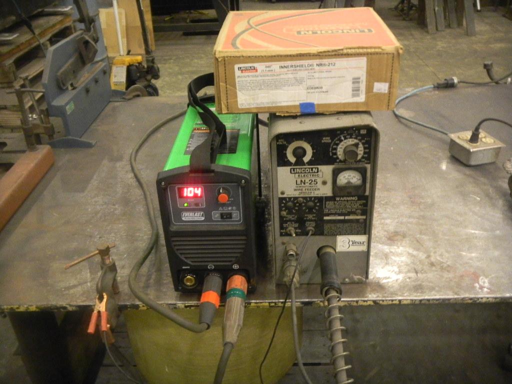

Shovelrider I would see what kind of a deal Mark could make you on a PowerArc 200ST. I' am so impressed with this welder:cool2:! It will stack 6010 just like my Lincoln SA-200 Short hood engine drive welder.

Is the gray device in the upper left hand corner of the photo a lever operated metal shear? If so what's the approximate capacity?

Yes it is a little shear. I don't remember the capacity:eek:, and it doesn't say on it. I think the thickest I've cut with it is 10-GA aluminum. It beats walking over to the tool box and getting out a pair of tin snips:laughing:.

That goes double for me. The PA200ST can burn smaller rods on 120 volt input, handles 6010/6011 easly, and on 220 volt input can handle the larger rods.
And it can be picked up and taken to the work site if needed. Takes standard dinse connectors. It's my favorite stick welder. I also have the PA300, that has adjustable hot start, and adjusable arc force, but the PA200ST seems to have good values for these pre-set in the machine.

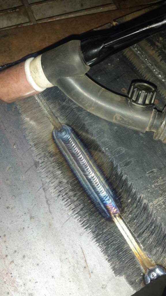

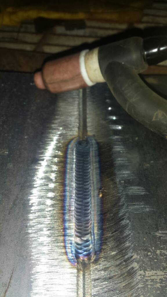

Ok so said I would tig some with this machine but since life has gotten in the way and I just got around to it tonight to do a little artsy project for the wife. Only had some carbon around so I ran two quick passes on it with a bevel. Pretty satisfied with it actually the starts are really nice for a scratch start but I still stuck it plenty due to lack of practice, a foot pedal will ruin you for sure.
3/32 70-s6 130 amps walking the cup.
First pass
Cap pass if you will.

WOW aarolar that is some very nice Tig welding! :thumbsup::thumbsup:
