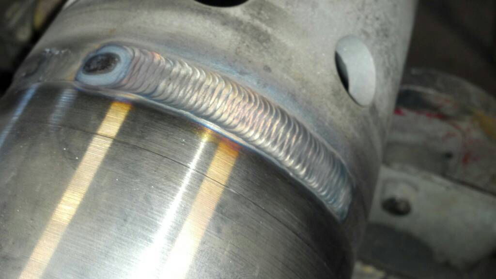

Huh I felt it was pretty mediocre been awhile since I walked a cup.
   / Everlast PowerArc 160 #43
People really don't understand how nice these units are for the price and what you can do with it. Weld quality is professional quality. You won't do that nice with a tombstone I don't think...TIG anyway.
I've only used mine a little bit. So far I'm VERY happy with the smoothness of my welds using E6011 rods. The 1 amp step adjustments are a big change from my tombstone.
   / Everlast PowerArc 160 #46
The 1 amp steps are even more important if you want to do some scratch start TIG with it.
