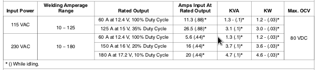

   / Everlast welders, anybody own one? #57
I found this 180 AMP Tig spec on a manufactures website; look promising.
Screenshot at 2012-10-21 09:11:12.png
   / Everlast welders, anybody own one? #58
That's not listing the I1max...just the operating amps. Our units perform similarly on TIG...but with a MUCH higher duty cycle. That looks like a Miller Diversion spec for duty cycle its so low.

   / Everlast welders, anybody own one? #60
Do you have those inrush specs for your product line?
