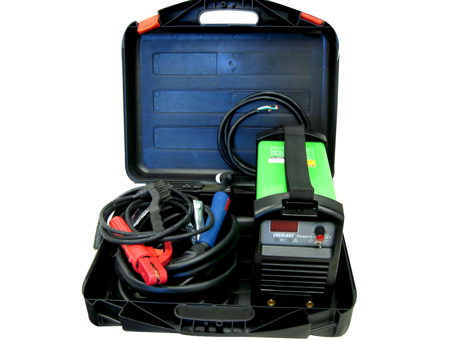

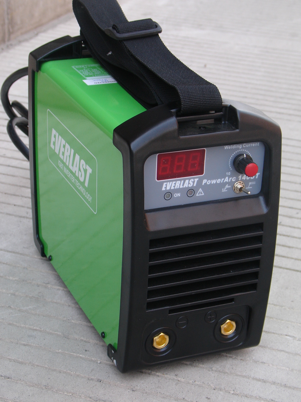

Meant to post this the other day,
But forgot to do so.
We have a new 120/240 V stick/tig welder available now. Its the new Everlast 140 ST. It features 35% duty cycle at 140 amps on 240, and 35% duty cycle at 100 amps on 120 V. It has arc force control and hot start. Tig is DC, LIFT start. And yes, comes with a tig torch and welding cables. To run Tig, you'll need to purchase a regulator, argon and tungsten. It comes in a plastic case along with a bonus welding brush.
Price 229.00

   / Everlast Welders - Welders and Plasma Cutters by Everlast #166
Hey, you're back to the clamp type electrode holder. Nice.
Why the reduced duty cycle?
Ian
#167
Because this unit is tiny, and it is 110V capable. Your not going to get high duty cycle units on 110V.
