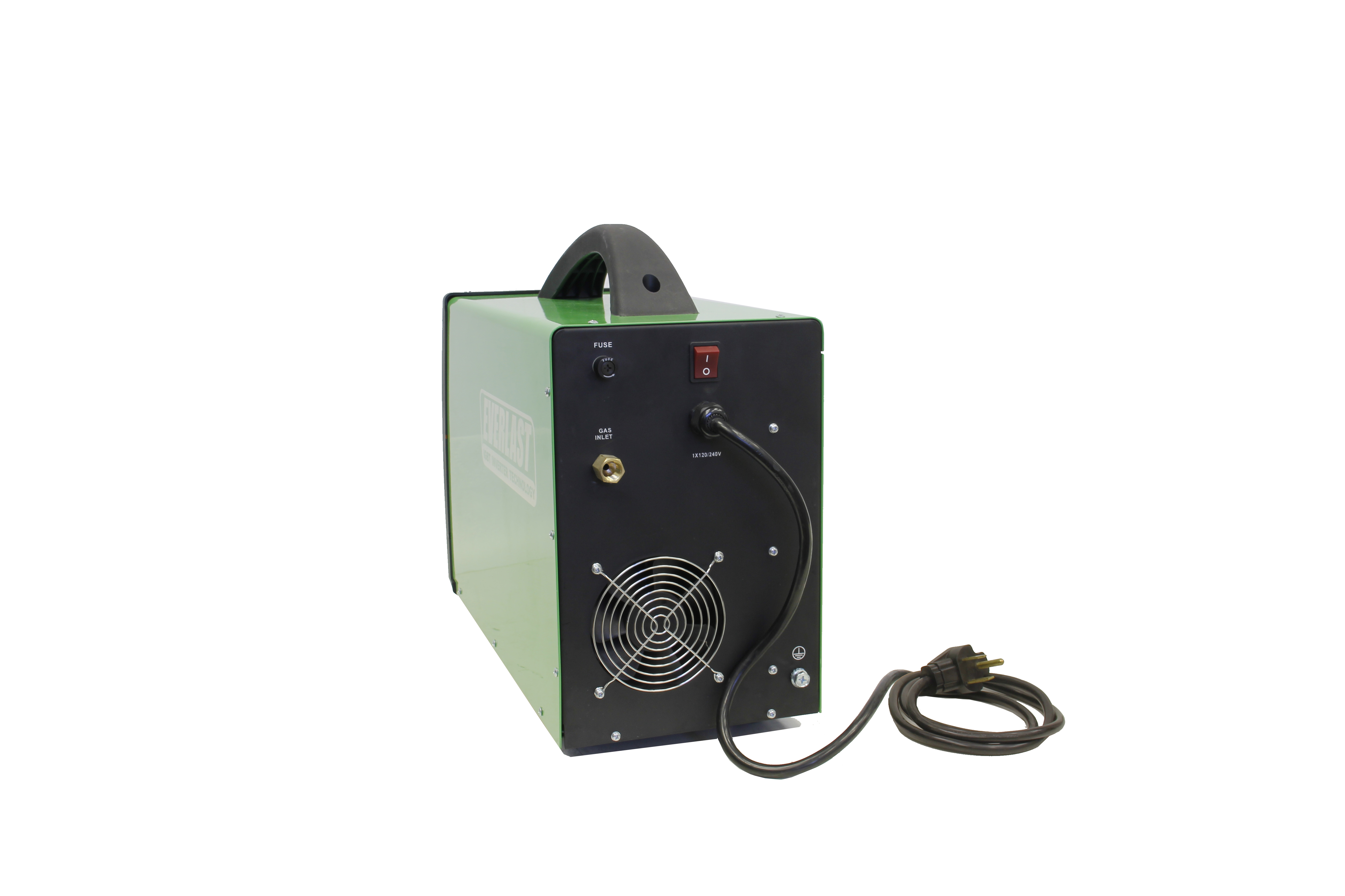

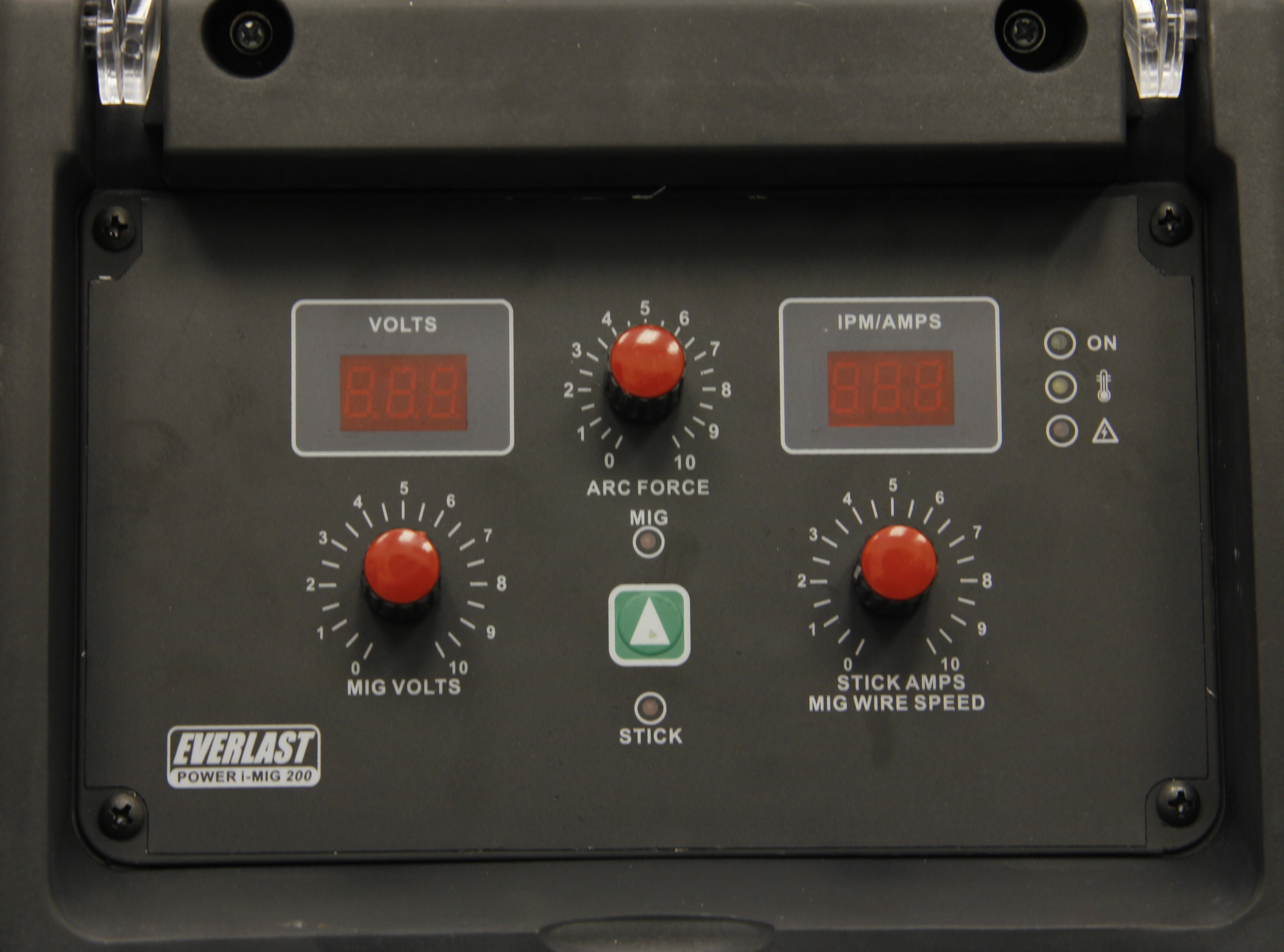

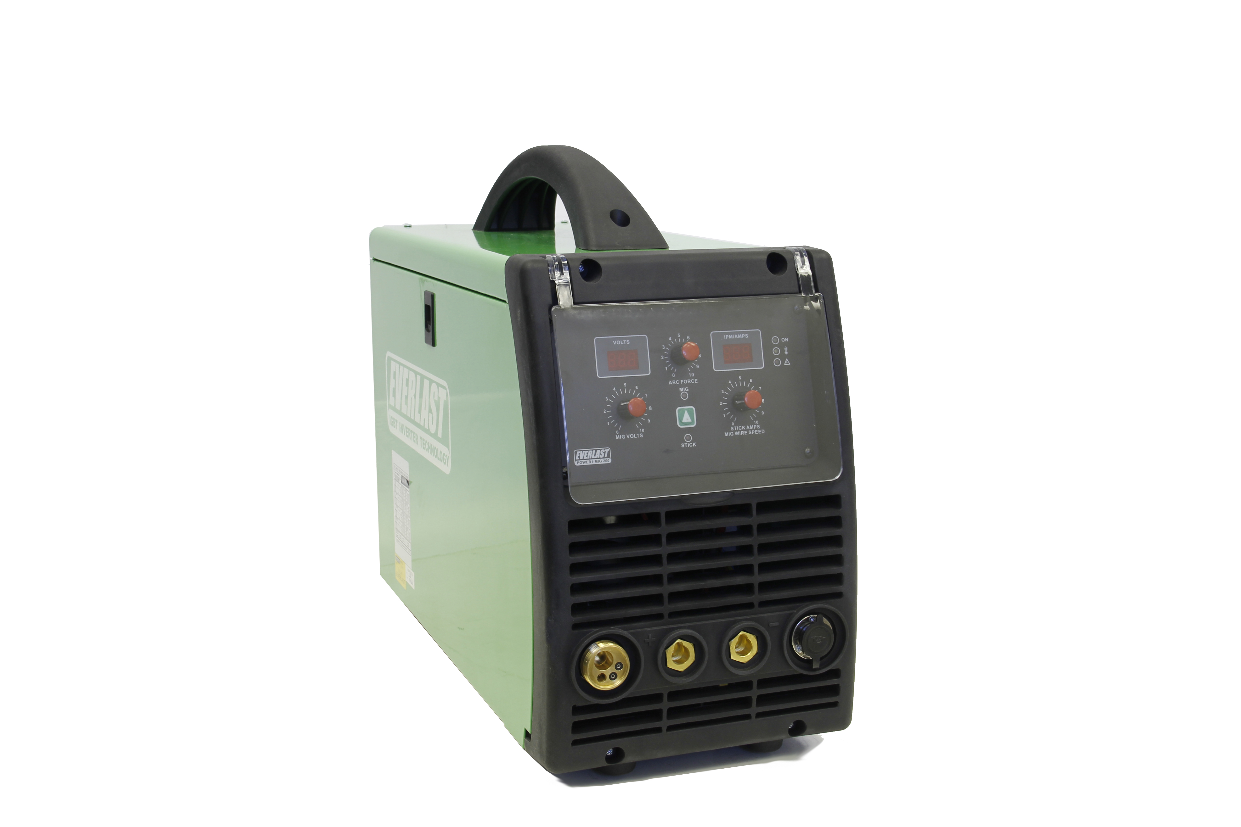

The first one is the MTS unit. That is an old MTS 200. The middle picture is the Power i MIG 200, old version. The last picture is the current version.
If you go to the website page, you will see the actual images of the unit below where you see the MTS image. The MTS picture was used as a place holder until the new product images from the comprehensive photoshoot came out. It is confusing I admit. No idea why HD has the old image. I think since the new product images just came back from the photographer, the images will be corrected all across the board. It'll take a few days.
If you want MIG TIG stick processes (keep in mind that it is DC TIG only with HF start), the PowerMTS 211Si is the new product.
To clear up confusion, I'll put the uncorrected photo shoot images up here.
The first is the Power i MIG 200 images.
Both units support spool gun. Operation is different as spool gun speed is controlled on the panel with the Power i MIG 200 and on the MTS it is controlled on the gun.

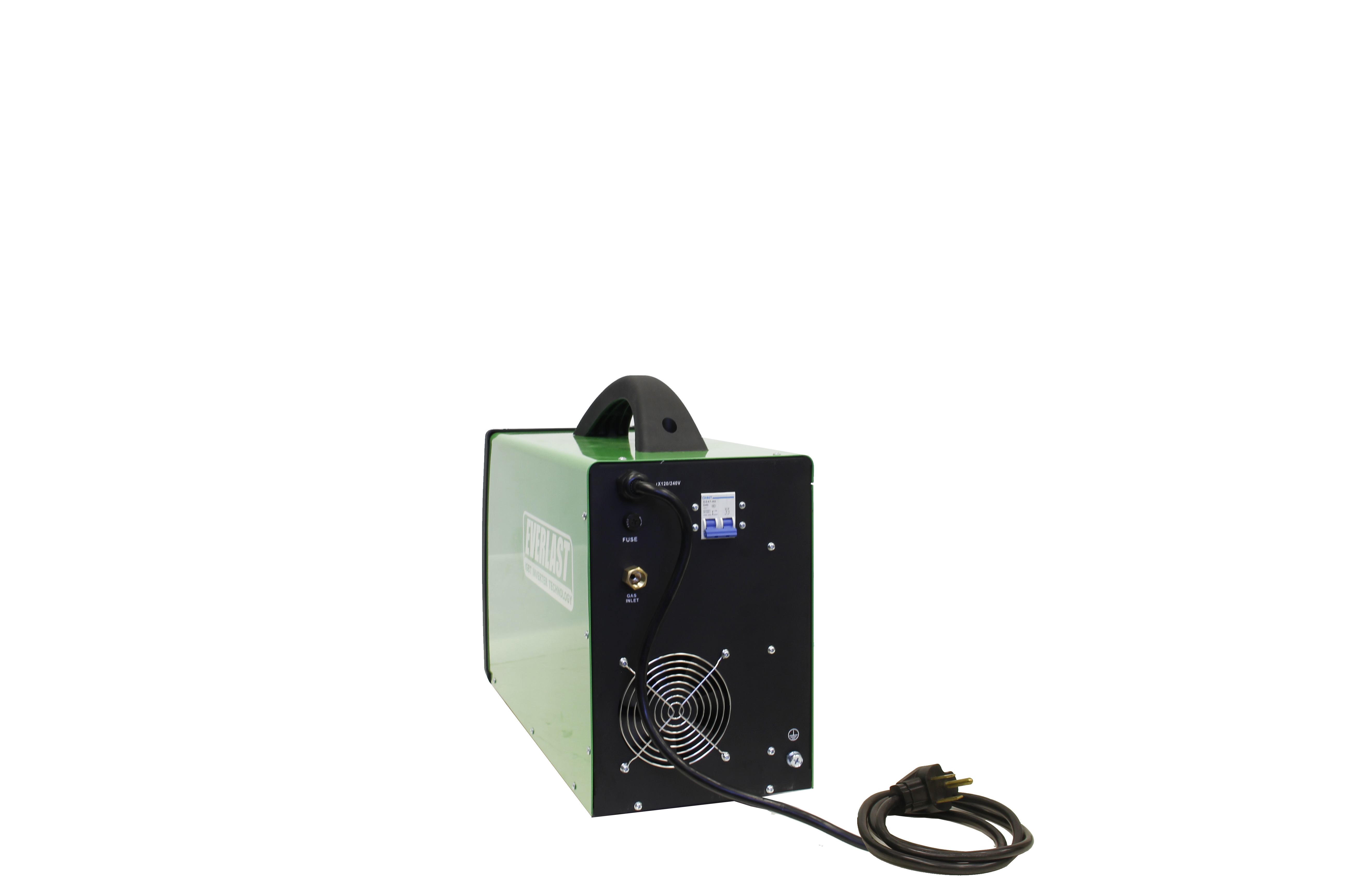

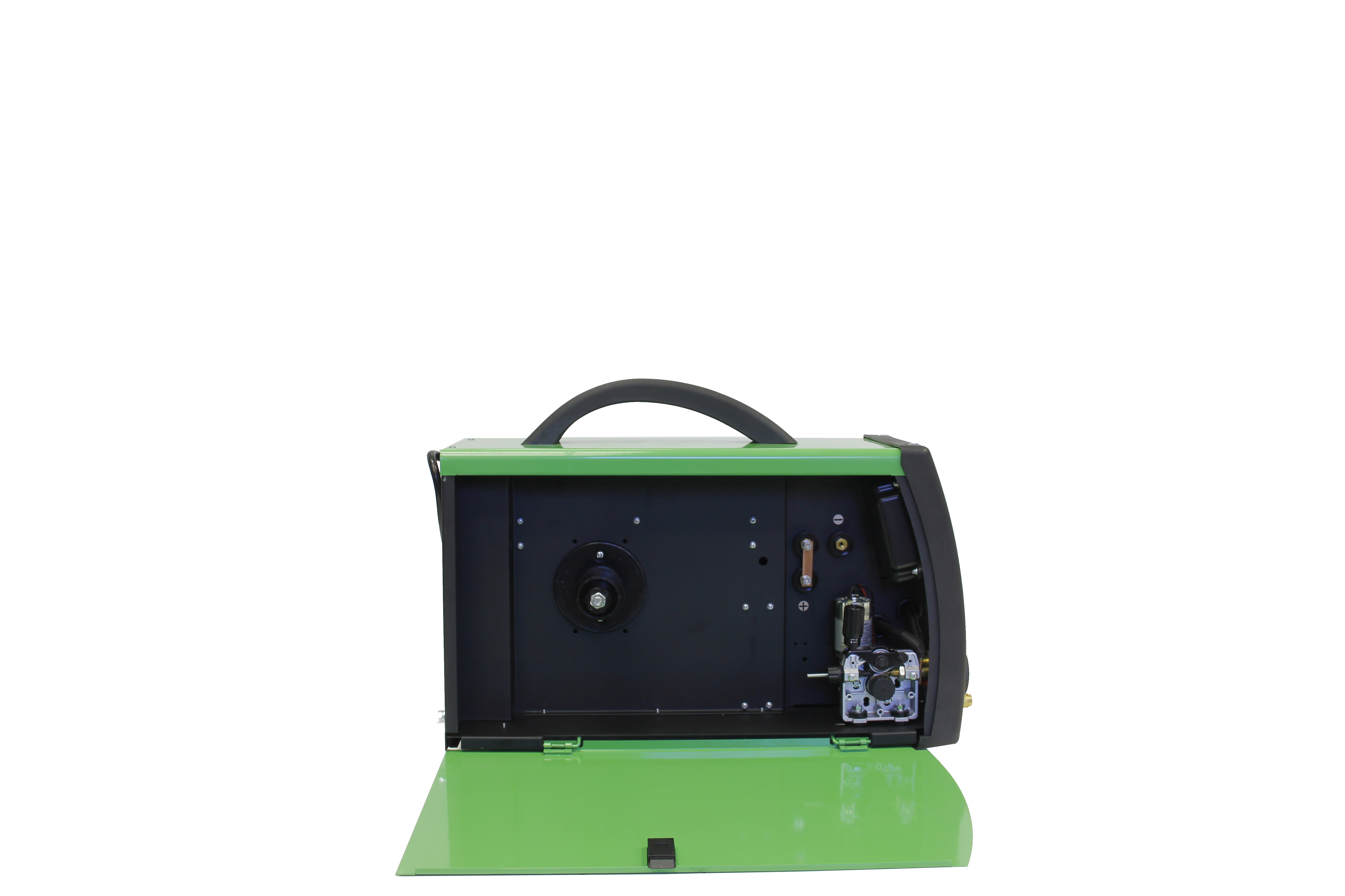

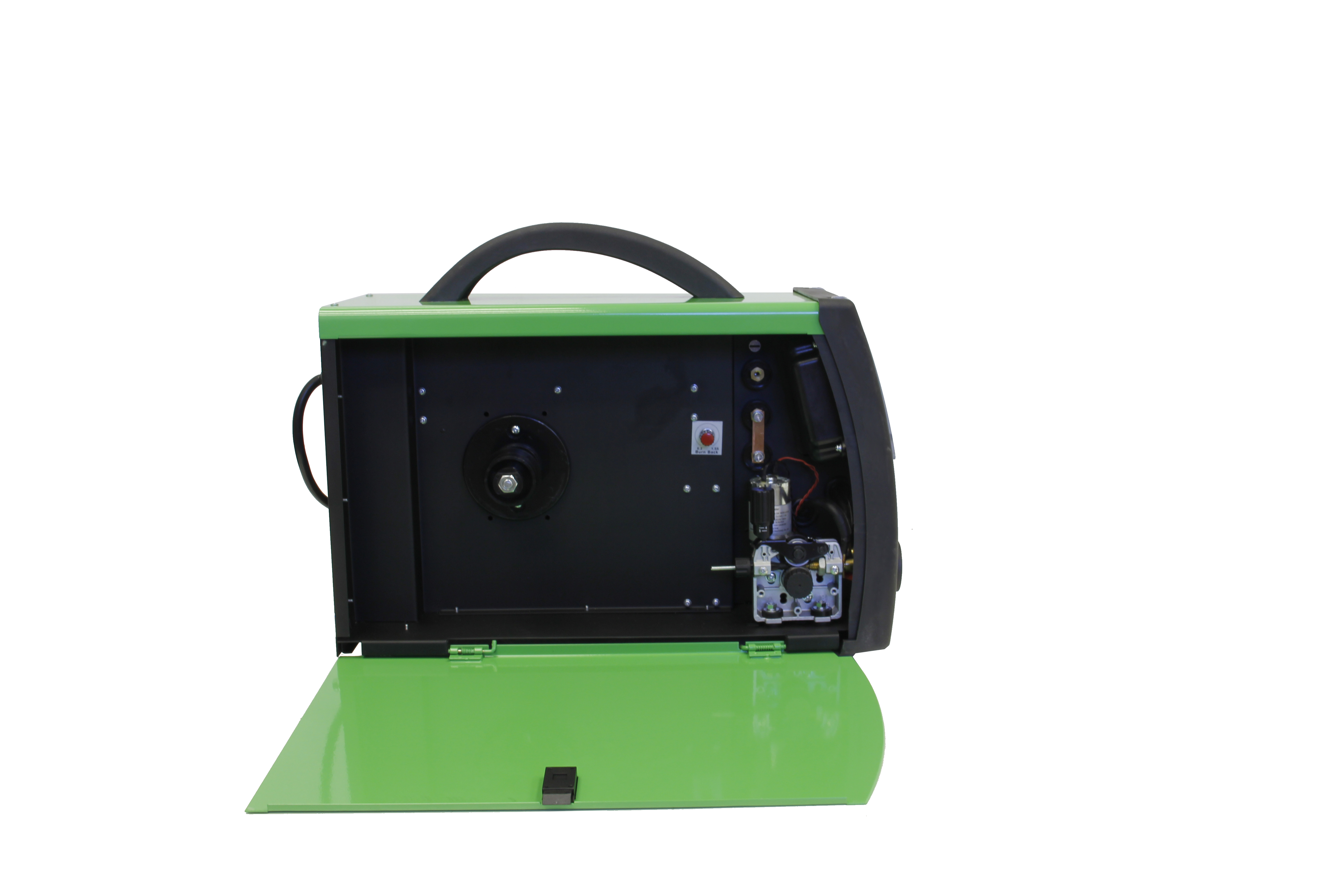

This is the new PowerMTS 211Si
