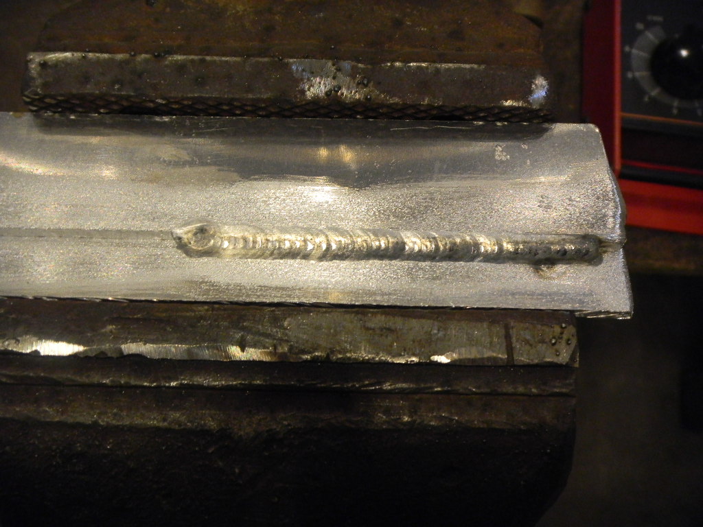

Remember now, you can Tig weld aluminum on DC. Just need a bottle of helium.
This weld was done on DC with 100% helium.
Yep. Absolutely. But you are a "hobby" master of TIG:thumbsup:. No way I am going to promote that to people though through official channels as an acceptable method of welding Aluminum. I've had enough people call trying to weld aluminum with DC and get sore for not being able to do the job. Mentioning that from an official point of view brings me all kinds of grief. Been there done that...We've had to take units back because people thought this was a "way" to escape buying a more expensive AC/DC unit and found out it was not fun or economical... but they heard someone say it could be done and expected it to just be easy as pie.
Very Sexy. Was that DC+ or -? And did you have to do a bunch of cleanup? I have a cheap TIG that can only do DC and directions said "can't do aluminium" but I've read the very first TIG machines were DC and so it's possible.
   / Everlast Welders - Welders and Plasma Cutters by Everlast #764
That was DC electrode negative -. On DC you don't get the same cleaning as on AC. So you need to run a stainless steel brush over the weld zone just before welding. See the little black spot above, and below the weld? That is a sure sign of DC welding on aluminum.
When using DC and helium, it takes about 1/2 the amount of amps, as welding on AC.

I have Tig welded aluminum with my Tig rig, and my Everlast SMAW welders. Problem when welding aluminum without a foot pedal, you can only make short welds. Once the base metal heats up, no way to back off the power.
Don't hold me to this, but I think I used 100% argon with this weld.

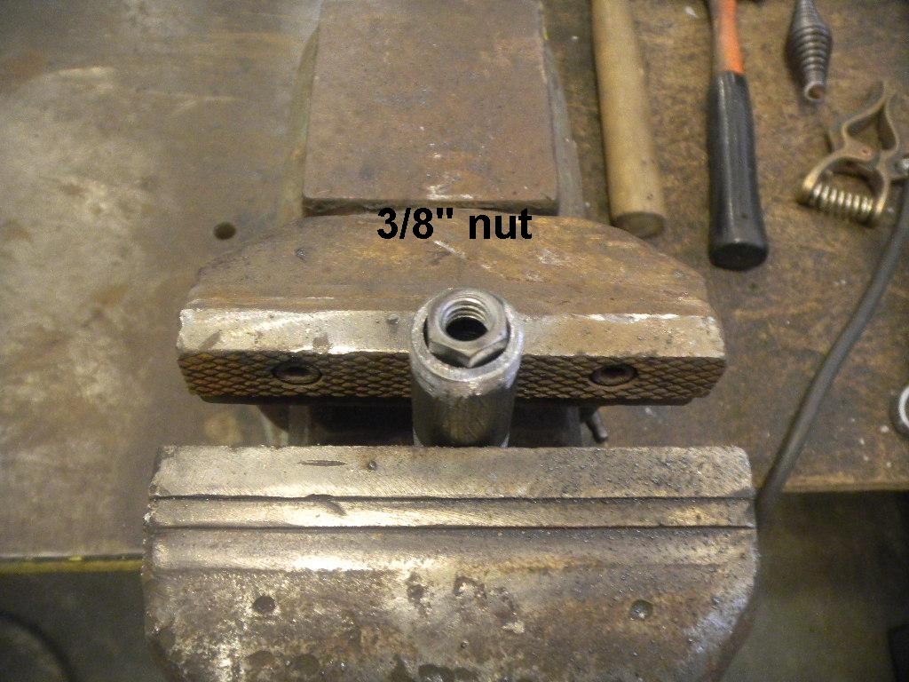

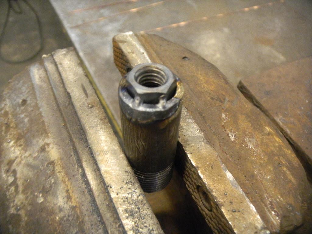

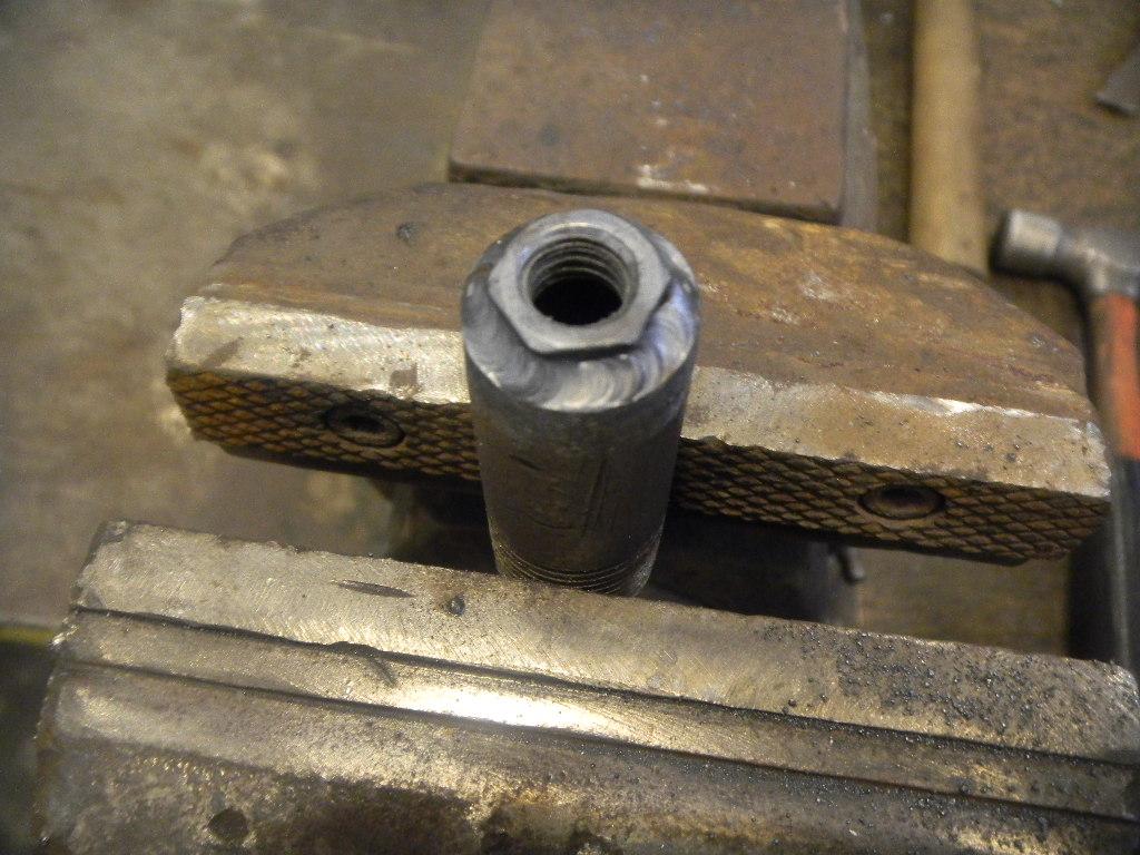

No it doesn't. But a scratch start Tig rig is handy to have around for welding thin mild steel, and stainless steel. Or small objects.
