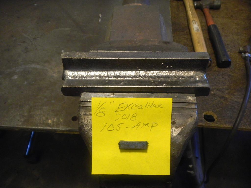

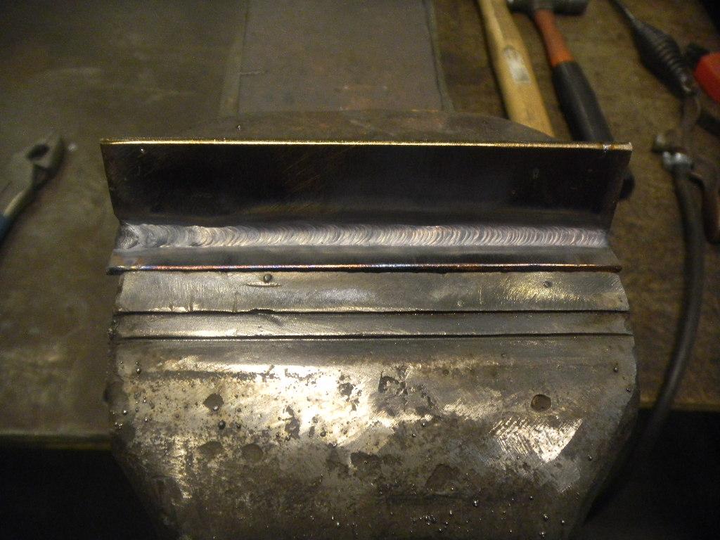

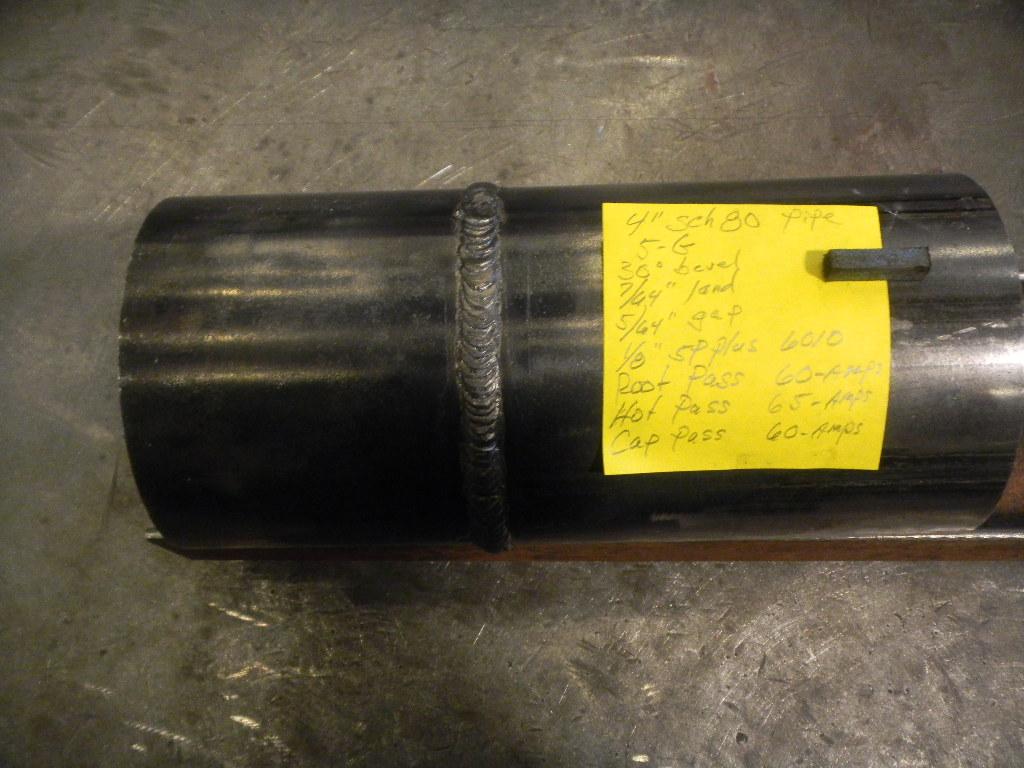

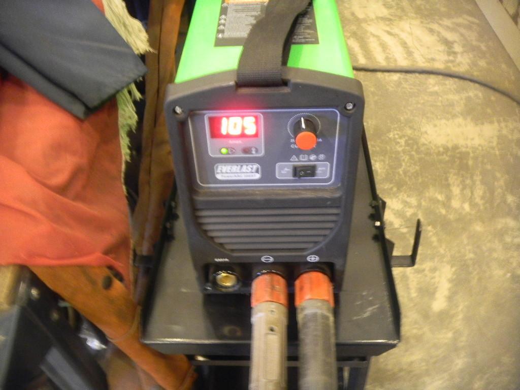

I'm so impressed!:cool2:
Last spring my brother-n-law bought a PowerArc-200ST from Mark. Last week I was at his place, he said he was having a hard time with the lift arc Tig start. Personally I never liked that method. I prefer high frequency, or scratch start. My brother-n-law is a retired very high end Tig welder. Worked on some of the space shuttles, even welded on nuclear bombs. But he can't say what he was welding on nuclear bombs! I took my PowerArc 300 to his place. Until next spring we traded welders. I brought his PowerArc 200 ST home with me. I was playing with it this morning. I'm so impressed with the way it runs 6010. You control the puddle with arc length!
Remember now I'm no pipe welder, (a union thing).
This little welder runs very hot! With my Lincoln V350-Pro I run 1/8 5P-Plus 6010 around 75-amps. With this welder 60-amps does the same thing.:cool:

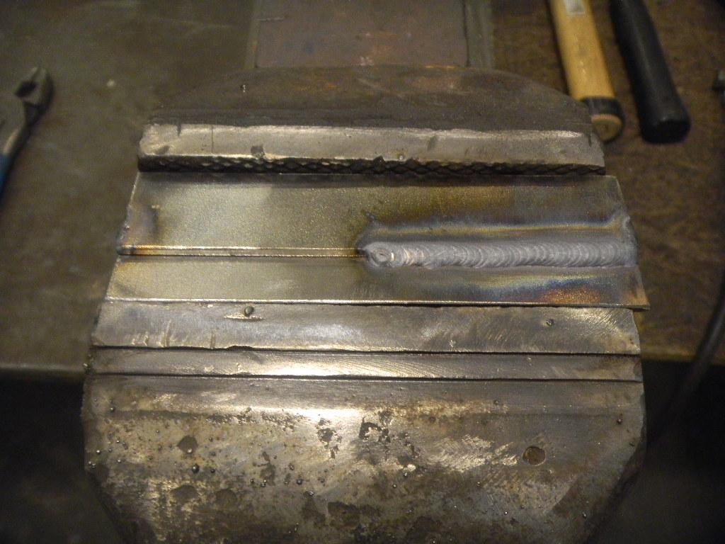

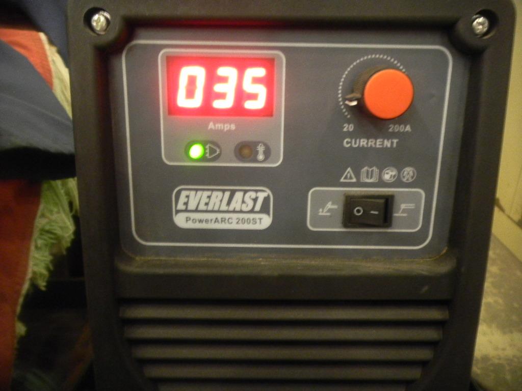

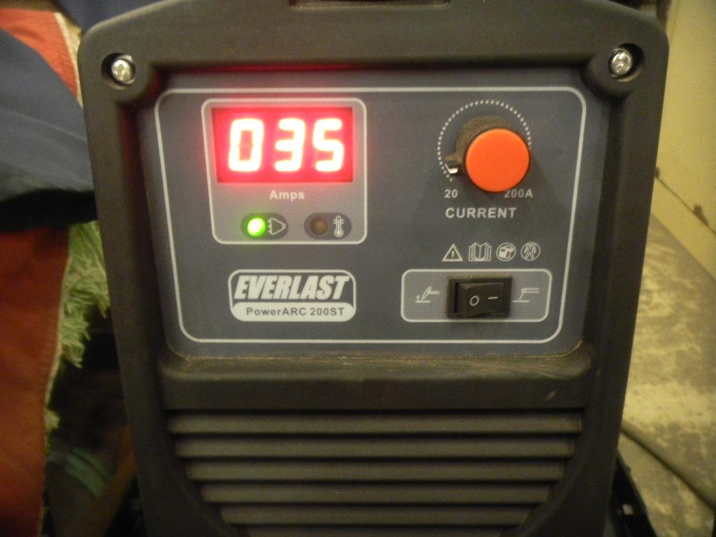

Well I couldn't wait until tomorrow!:D I went out to the shop, hooked up my Tig rig. Left the toggle switch in SMAW mode. Using the scratch start method, the welder started just like any welder I've ever used. Then I switched the toggle switch to lift arc. Don't know what I'm doing different now. But I didn't have an once of trouble starting the arc in lift arc mode!:confused: Same 10-GA stainless steel. Same size and type of tungsten. Just a different Tig rig is all.:confused3:

So thoughts on why your BIL was struggling?
And can you explain what you mean by different TIG rig?

I did a quick video a few years ago for a couple of customers how to lift start with our units...just silent where I make repeated starts...I'll post it here for the technique. Someone told me that's not the way to lift start on a Miller. That's the way I lift start on a Miller anyway and it works for our units. Keep in mind, the lift start drops the voltage (or is it current...can't remember as I am writing this) when it senses the continuity and then reapplies it as it detects a break in continuity, there by initiating the arc. It should be done briskly, but lightly. On our units, there are particularly sensitive to a "double" tap, when the tungsten bounces quickly on the metal due to an aggresive start technique, and will stick the tungsten. I use a rocking motion on the cup as you will see as it tightly controls everything as the arc is started.
In the video you can see what works and what doesn't...even though it is not a "talkie".
