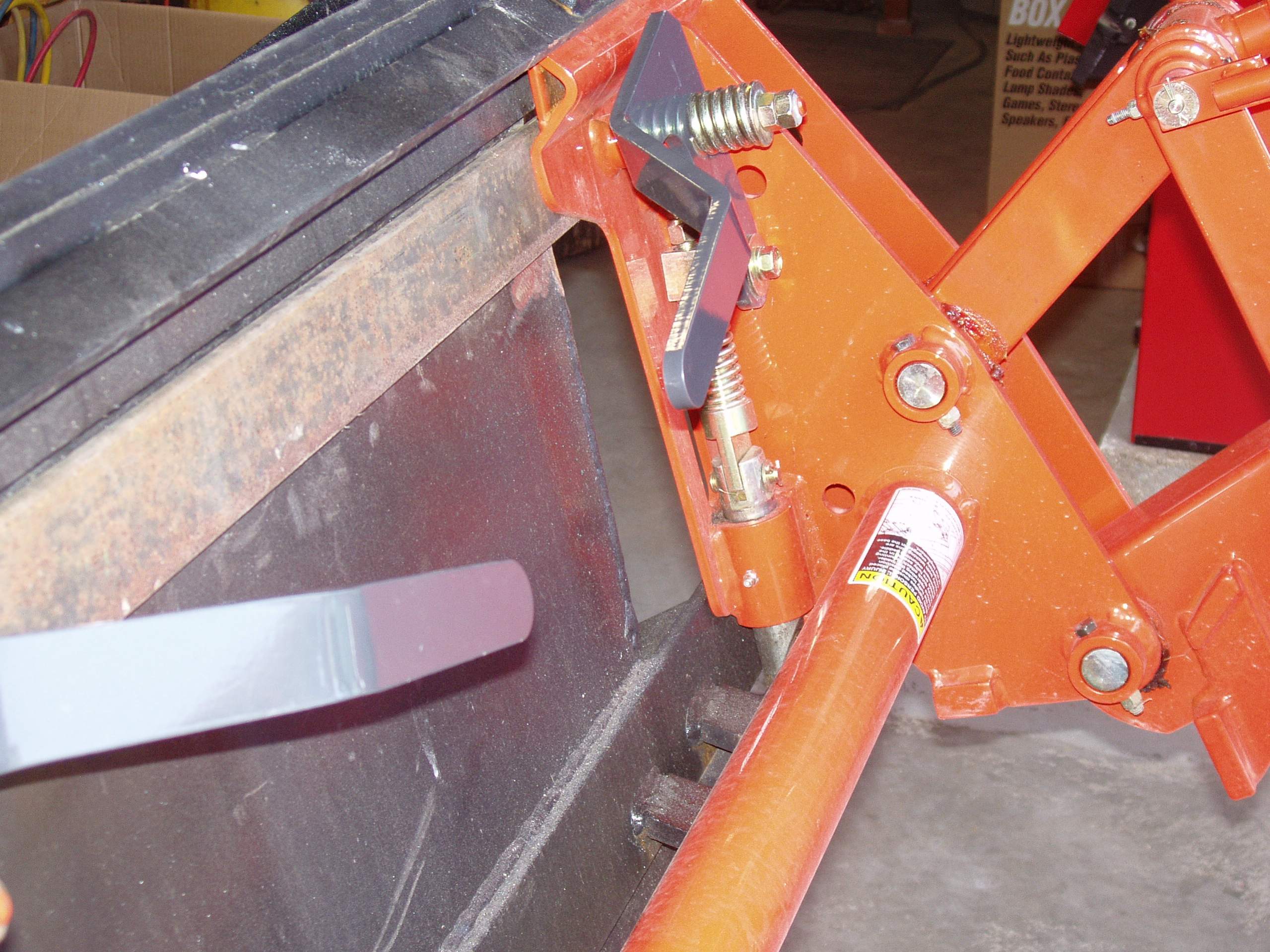

It is hard to see, but you must be referring to the plate that appears just above the top of the threaded rod extending through the spring. So, that plate is close enough to the top of the rod to keep it from lifting?
My L4330 (2007?) does not have it.
There were many complaints about this a few years ago, and Kubota made a kit like my home made one to fix it. Now I see the permanent fix.
   / Everybody loves a guessing game #23
Kevin:
Yep, it can only lift about 1/8" and it hits the plate over the threaded rod.

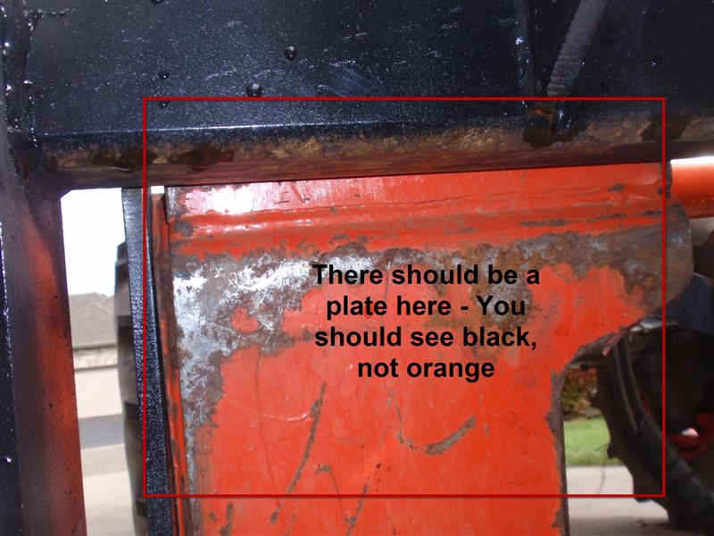

You need to check your grapple fit. It should not come off on one side.
I have a Markham bucket that was made "to skid steer spec" per Markham.
That may be true but it does not work right on Kubota due to the rebated top of the QA device.
Compare the fit to you bucket, look at the top and the bottom by the beveled pins.
Also the pins should have stops above them when latched
When hooked there was 1/2" open on the bottom by the beveled pin
I had to weld in a piece of steel to shim the top where it belonged, no problems since.
The pic should show the issue that I had.

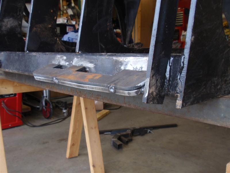

Wow. Where were you when I was fighting this issue last fall? :) Post #64 and on... http://www.tractorbynet.com/forums/attachments/179052-grapple-width-7.html
Another Gator/Markham grapple falling off victim... What I did - based on what Gator told me to do - was to weld on a second plate they sent me to the lower pin attachment bracket that essentially made it double thick. This did NOT solve the problem but it improved it. I was thinking about adding some blocking below that top tube for the QA top to hit against similar to what you showed, kevin. You have any more close-ups of your fix? This just reinforces the fact that I need to do that this year. Modifying brand new equipment to make it work as intended is not my idea of a good product...
I know a lot of people like these grapples, and they sure are pretty handy (when not falling off), but this one has a serious design flaw. They also told me I was "the only one" they had ever heard about with this issue. I doubted it then, and I really doubt it now.
I need to look into the pin stop issue also.
Jay - I wouldn't blame yourself. I think you are another victim of this design flaw.
Completed pic on top. During tack welding on the bottom for clarity.
attachment.php
attachment.php
Edit: Thinking about this more, this relates to a concern I had about the space behind the QA plates being open. I didn't realize that the Kubota plate's upper edge being recessed like that was quite the issue it is. I thought the plate needed to be there for other reasons (ease of mounting and stopping the plate from pushing through when stressed). If you are saying it is keeping the QA mount out of place, then it all adds up. Man I'm glad I saw this thread...

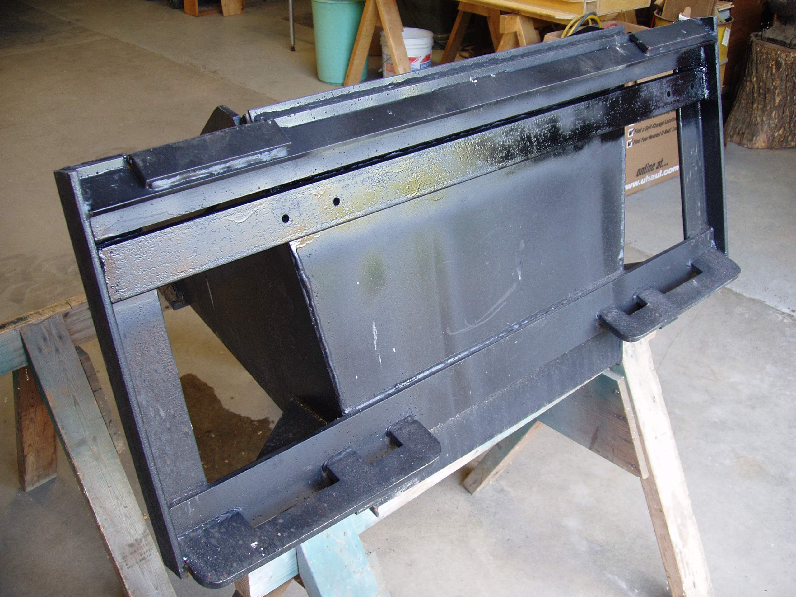

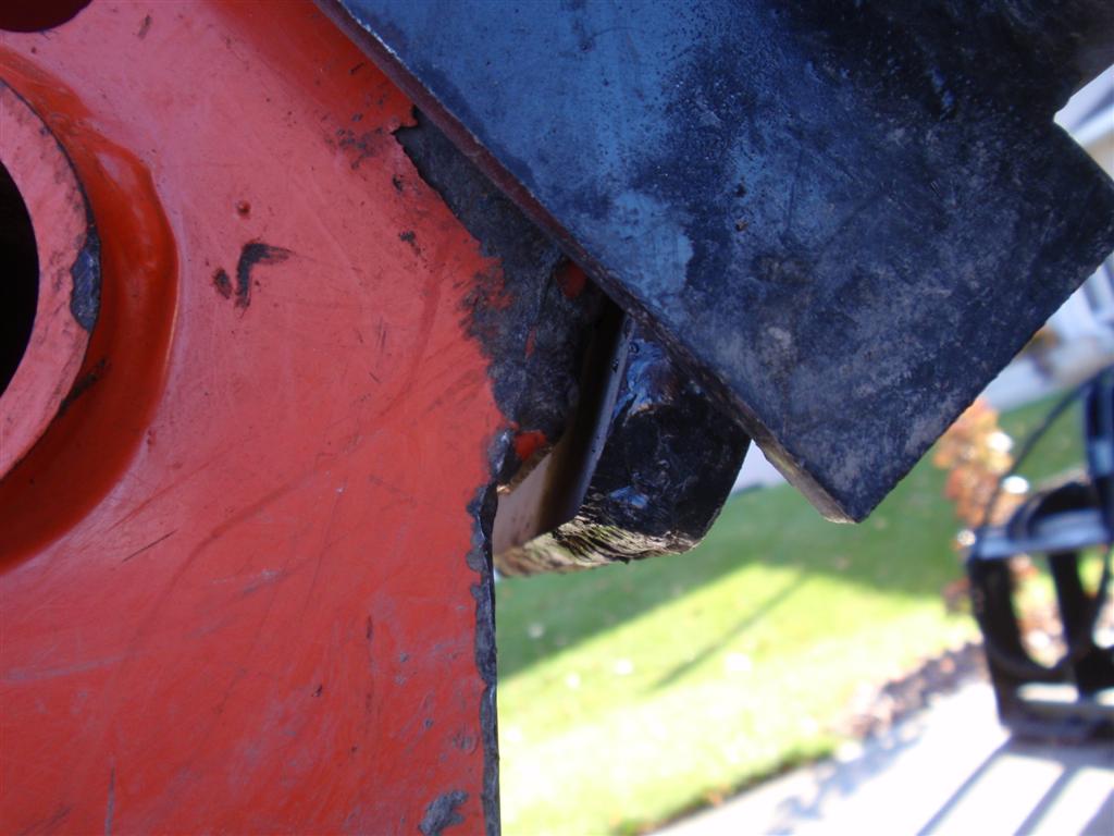

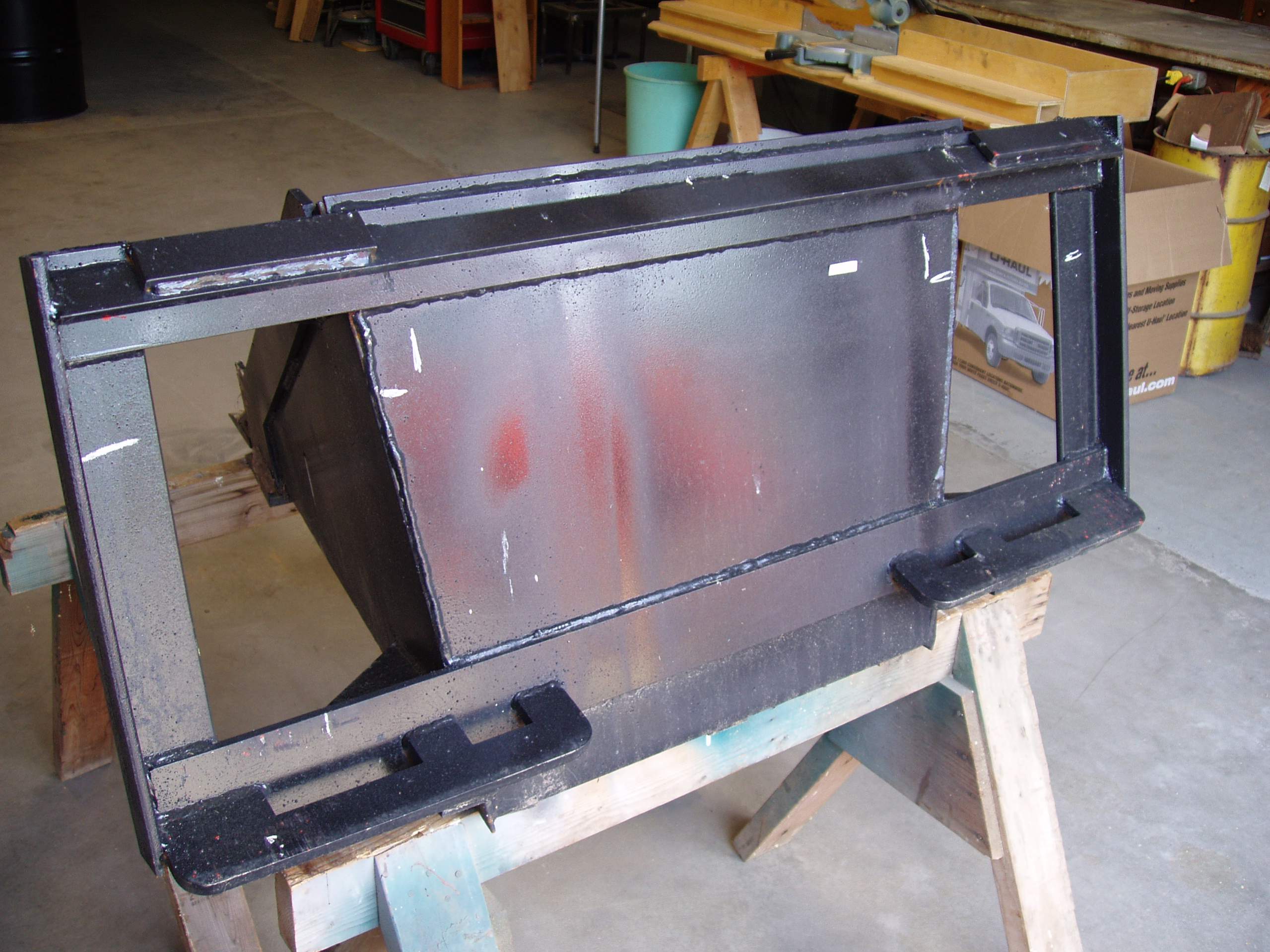

I posted a bunch of this a couple years back and most did not seem to get it so I do not post it unless I can clearly see the posters issues.
Markham was not at all helpful for me. They claimed any fit issues were Kubotas fault. All they were doing is saving a small amount of steel on every item they sold. I will never buy from that outfit again!!!.
It is easy to see the fit issues when you study it. As you can see in your pic you are not bearing in the correct spot and the attachment slides down and lets the it get loose on the pins.
The shim on the bottom is the wrong way to fix it. Cut that out and put steel in to get bearing like your bucket has. That recess is 1/2" on mine so use 1/2" stock to fix it, a bar of flat stock will weigh less than a full plate.
All Markham had to do was use a 6" bar rather than the 3" at the top and no one would be having these issues.
