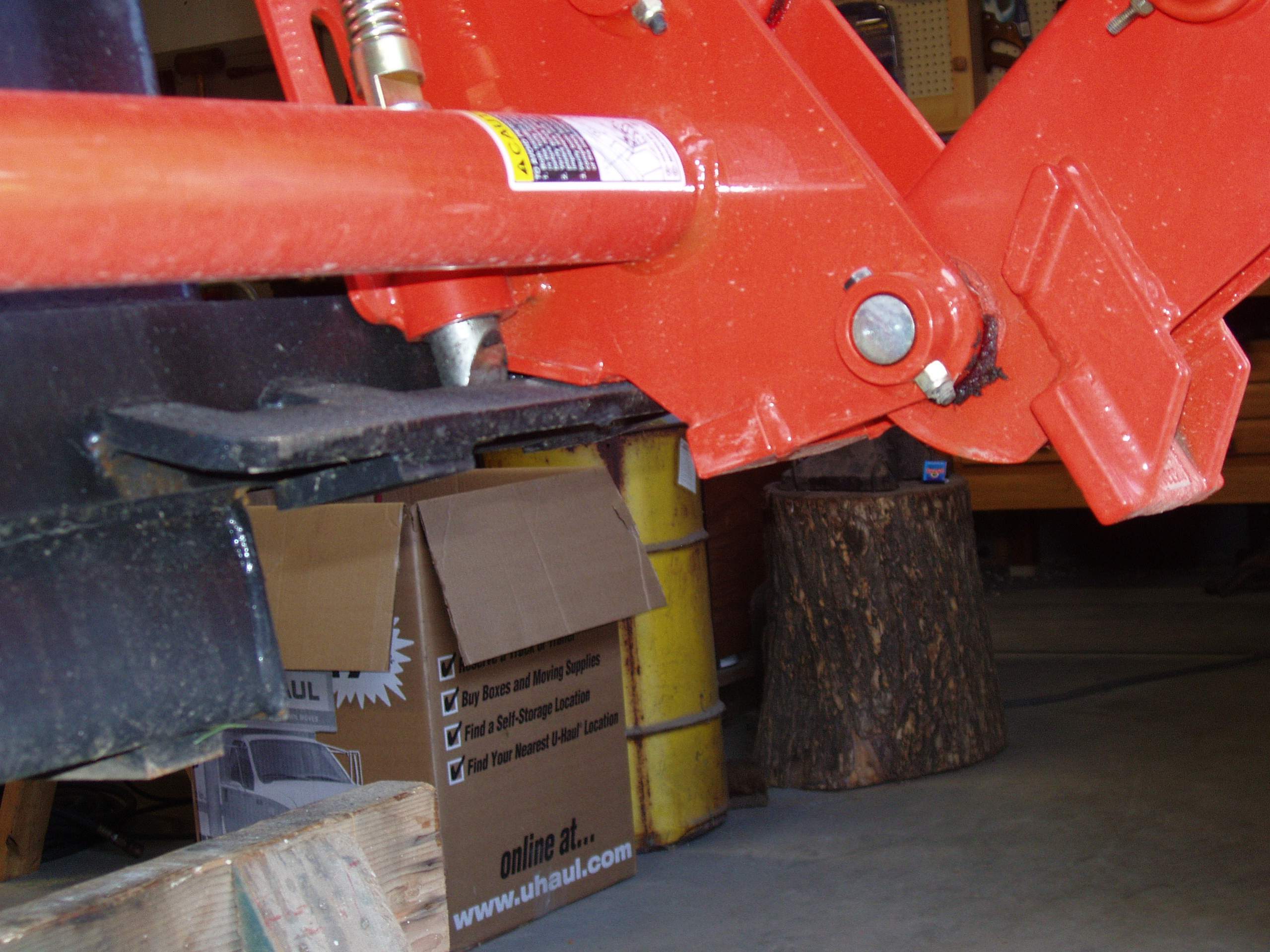

Called two dealers today to get the price of a new QA assembly. One quoted $630 plus tax, the other $657 plus tax.
Time to get out the saw.
I'm gonna attempt to repair it myself using 638's and Ductape's advice. Cut the tube in two, then attach to bucket to ensure proper vertical and rotational alignment of the QA plates. Once connected this way, the displacement of the tube ends at the cutoff point should tell me which direction things need to be moved.
   / Everybody loves a guessing game #25
I do not know about your area, but here we have several large welding shops which have nice presses.
When I bend stuff I start with the press route, usually cheap & effective, even if they only get it real close you have a lot less work to finish the job.
You may get by with just some final heating of the tube rather than cutting or you could just blow the welds and put in a new tube.
20 to 50 bucks and a half hour will get stuff fixed with the ol' 60 ton press at my local shop:thumbsup:

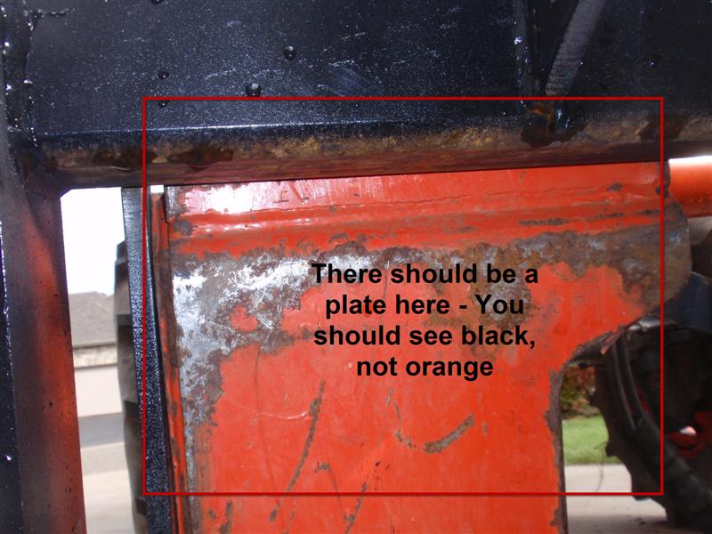

You need to check your grapple fit. It should not come off on one side.
I have a Markham bucket that was made "to skid steer spec" per Markham.
That may be true but it does not work right on Kubota due to the rebated top of the QA device.
Compare the fit to you bucket, look at the top and the bottom by the beveled pins.
Also the pins should have stops above them when latched
When hooked there was 1/2" open on the bottom by the beveled pin
I had to weld in a piece of steel to shim the top where it belonged, no problems since.
The pic should show the issue that I had.
Wow. Where were you when I was fighting this issue last fall? :) Post #64 and on... http://www.tractorbynet.com/forums/attachments/179052-grapple-width-7.html
Another Gator/Markham grapple falling off victim... What I did - based on what Gator told me to do - was to weld on a second plate they sent me to the lower pin attachment bracket that essentially made it double thick. This did NOT solve the problem but it improved it. I was thinking about adding some blocking below that top tube for the QA top to hit against similar to what you showed, kevin. You have any more close-ups of your fix? This just reinforces the fact that I need to do that this year. Modifying brand new equipment to make it work as intended is not my idea of a good product...
I know a lot of people like these grapples, and they sure are pretty handy (when not falling off), but this one has a serious design flaw. They also told me I was "the only one" they had ever heard about with this issue. I doubted it then, and I really doubt it now.
I need to look into the pin stop issue also.
Jay - I wouldn't blame yourself. I think you are another victim of this design flaw.

I posted a bunch of this a couple years back and most did not seem to get it so I do not post it unless I can clearly see the posters issues.
Markham was not at all helpful for me. They claimed any fit issues were Kubotas fault. All they were doing is saving a small amount of steel on every item they sold. I will never buy from that outfit again!!!.
It is easy to see the fit issues when you study it. As you can see in your pic you are not bearing in the correct spot and the attachment slides down and lets the it get loose on the pins.
The shim on the bottom is the wrong way to fix it. Cut that out and put steel in to get bearing like your bucket has. That recess is 1/2" on mine so use 1/2" stock to fix it, a bar of flat stock will weigh less than a full plate.
All Markham had to do was use a 6" bar rather than the 3" at the top and no one would be having these issues.

Alrighty... I have an update on my grapple detachment saga. Finally got a chance to work on it this weekend.
I fixed the twisted and bent SSQA frame that was damaged when one side of my grapple detached while in operation. The frame ain't all that pretty anymore, but it works.
After repairing the SSQA frame, I attached the offending grapple and took a close look at the fit, expecting to find something horribly obvious that would explain why it detached.
I found nothing amiss. Sigh.
Kevin, the tractor SSQA plate foot shows no gap between it and the grapple's latch slot tab at the bottom of the implement. And the latch tongue fits in the slot like a glove. (pic 1)
The spine of the grapple's strut fits flush against the SSQA plate's face just like it ought to. Each of the two struts line up perfectly with their respective SSQA plates. (pic 2, 3)
The angled top of the SSQA plate fits snugly in the implement's receiver. (pic 4)
So Kevin, I don't *think* I have the same issue you had with your bucket.
On the other hand, there isn't ANYTHING contacting the SSQA plates except that edge of the grapple's vertical strut. (indicated by the green arrow in pic 5) Do you folks think adding some metal plate on the grapple to provide more surface contact with the face of the SSQA would help?
Thanks,
Jay

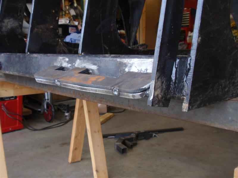

I spent the morning adding 3.5" wide, 3/8" thick plates to both sides of each vertical, from top to bottom. The grapple now has 7" wide pads instead of skinny verticals to mate with the SSQA pads.
Will send pics later.
Jay
#40
First pic is of the plates I added this morning (from scrap). Each one covers pretty much all the SSQA pad behind it.
Second pic is of the bottom of the SSQA frame where it mates with the latch slot. Kevin, there may an sixteenth or an eighth of an inch gap, but not much more.
I sure hope this grapple-detachment-while-operating thing won't ever happen again. What a pita.
Jay
