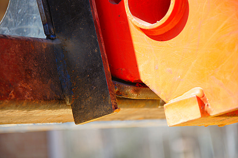

Alrighty... I have an update on my grapple detachment saga. Finally got a chance to work on it this weekend.
I fixed the twisted and bent SSQA frame that was damaged when one side of my grapple detached while in operation. The frame ain't all that pretty anymore, but it works.
After repairing the SSQA frame, I attached the offending grapple and took a close look at the fit, expecting to find something horribly obvious that would explain why it detached.
I found nothing amiss. Sigh.
Kevin, the tractor SSQA plate foot shows no gap between it and the grapple's latch slot tab at the bottom of the implement. And the latch tongue fits in the slot like a glove. (pic 1)

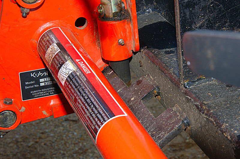

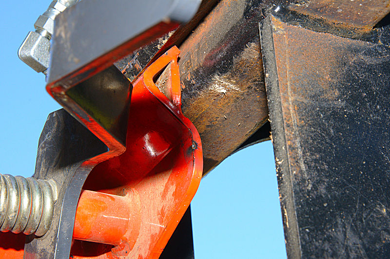

The spine of the grapple's strut fits flush against the SSQA plate's face just like it ought to. Each of the two struts line up perfectly with their respective SSQA plates. (pic 2, 3)

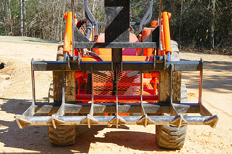

The angled top of the SSQA plate fits snugly in the implement's receiver. (pic 4)

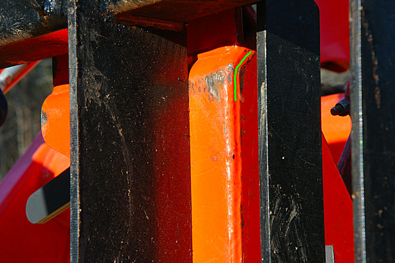

On the other hand, there isn't ANYTHING contacting the SSQA plates except that edge of the grapple's vertical strut. (indicated by the green arrow in pic 5) Do you folks think adding some metal plate on the grapple to provide more surface contact with the face of the SSQA would help?

Can you get a pic of the bottom??? It looks like you have a gap at the bottom of the frame.
If so the grapple can ride up and unhook.
Maybe you forgot to latch one side or it only partly locked and was not under the block allowing the pin to rise up.
I would add one more vertical on each side so that 2 are in contact as opposed to 1. That would insure that the QA can't twist under load.
I spent the morning adding 3.5" wide, 3/8" thick plates to both sides of each vertical, from top to bottom. The grapple now has 7" wide pads instead of skinny verticals to mate with the SSQA pads.

First pic is of the plates I added this morning (from scrap). Each one covers pretty much all the SSQA pad behind it.
