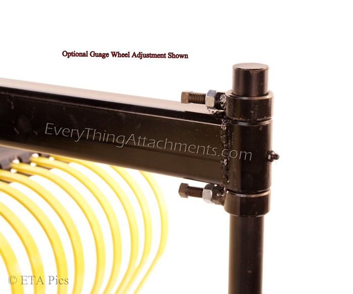

Looks pretty nice, especially for the price I would have liked to see a stronger main beam though. That S-shaped piece just doesn't look that beefy. I'd have prefered a box true angle beam rather that a bent piece. Workmanship looks pretty good except for the atrociously bad welds on the wheel spindle - see photo attached. Hopefully, the rest was put together better.

Lol on that weld. Presumably that one got by them and it was a test rig for the photos. Urgly!
