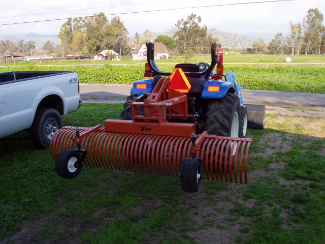

Looks pretty nice, especially for the price I would have liked to see a stronger main beam though. That S-shaped piece just doesn't look that beefy. I'd have prefered a box true angle beam rather that a bent piece. Workmanship looks pretty good except for the atrociously bad welds on the wheel spindle - see photo attached. Hopefully, the rest was put together better.
I called ET and talked to Ted. He's gonna check out this thread and the turkey welds.:laughing:

We have been looking at our stock of this item(over 100 pieces), and aren't sure exactly where this pic came from. None of the other items have welds of this quality, they are the professional quality you would expect. We can assure that this type of weld does not leave our facility

I trust ya Ted. I ordered your rake today. Thanks
