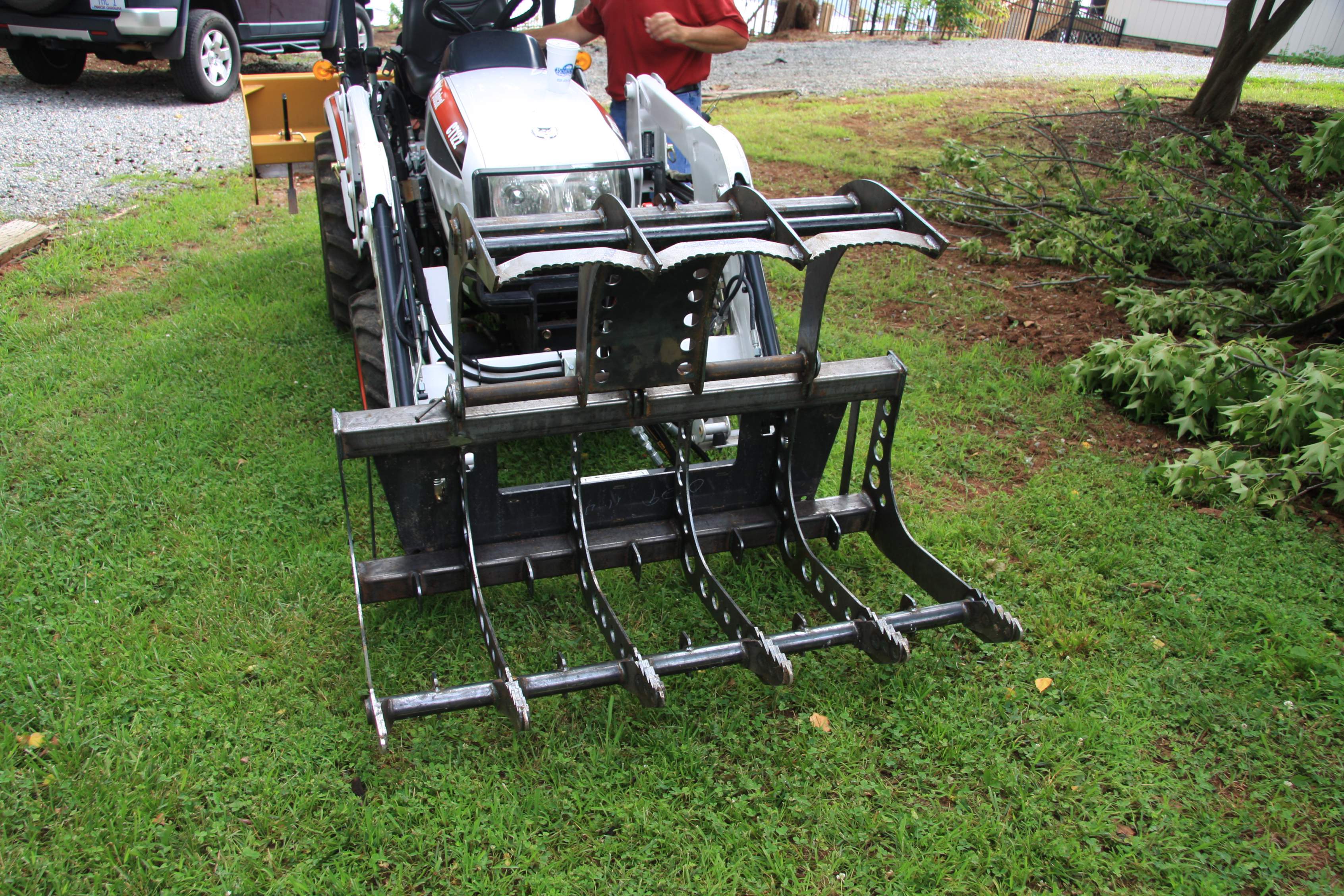

I can't see why anyone would need a compact grapple to open any wider than this:
<img src="http://www.tractorbynet.com/forums/attachment.php?attachmentid=325977"/><img src="http://www.tractorbynet.com/forums/attachment.php?attachmentid=325978"/>
I said this in another thread, the larger the opening is , means that more than likely the lower tines will be longer which will reduce your breakout force.
The 30" opening has worked fine for me. I think it is a good size for a COMPACT tractor. If it was bigger people would be trying to lift stuff their tractor was not capable of.
Then why do other manufacturers make them open wider than EA? Even your largest models only open to 30". I seem to have touched a sore spot with EA? Very defensive.
