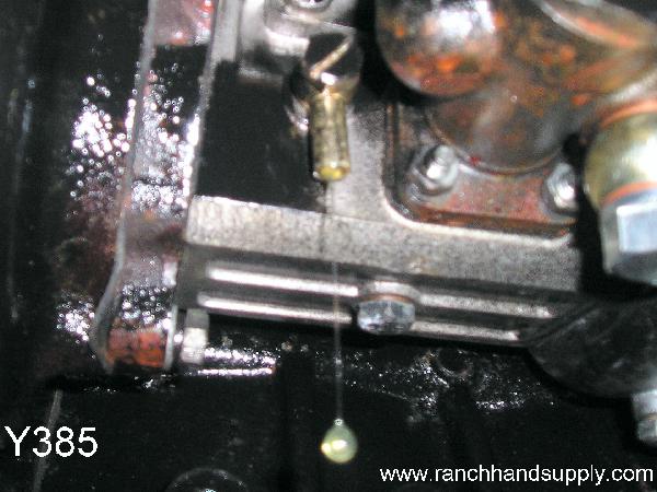

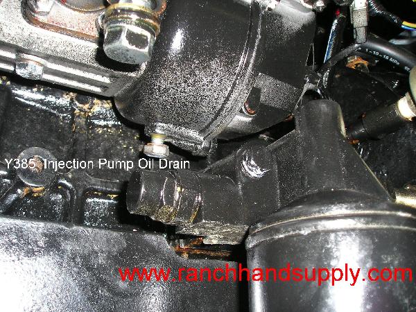

Here are a few pics courtesy of Ranch Hand Supply.
The first one shows the drain plugs. There are 2 but you can also just drain it via the lower one. I like to open both.

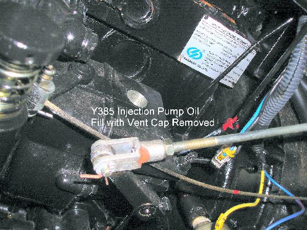

The third pic shows the fill via the mushroom cap/vent.
The next shows the level drain. Mine has a rubber cap/plug over it for dirt protection. I have also seen some with a hose on them.
You should service you pump every other oil change as a minimum.
I like to pour in about 20 oz of oil and let it sit overnight to find level. Make sure to put a catch pan under the tractor and park it on a level spot.
