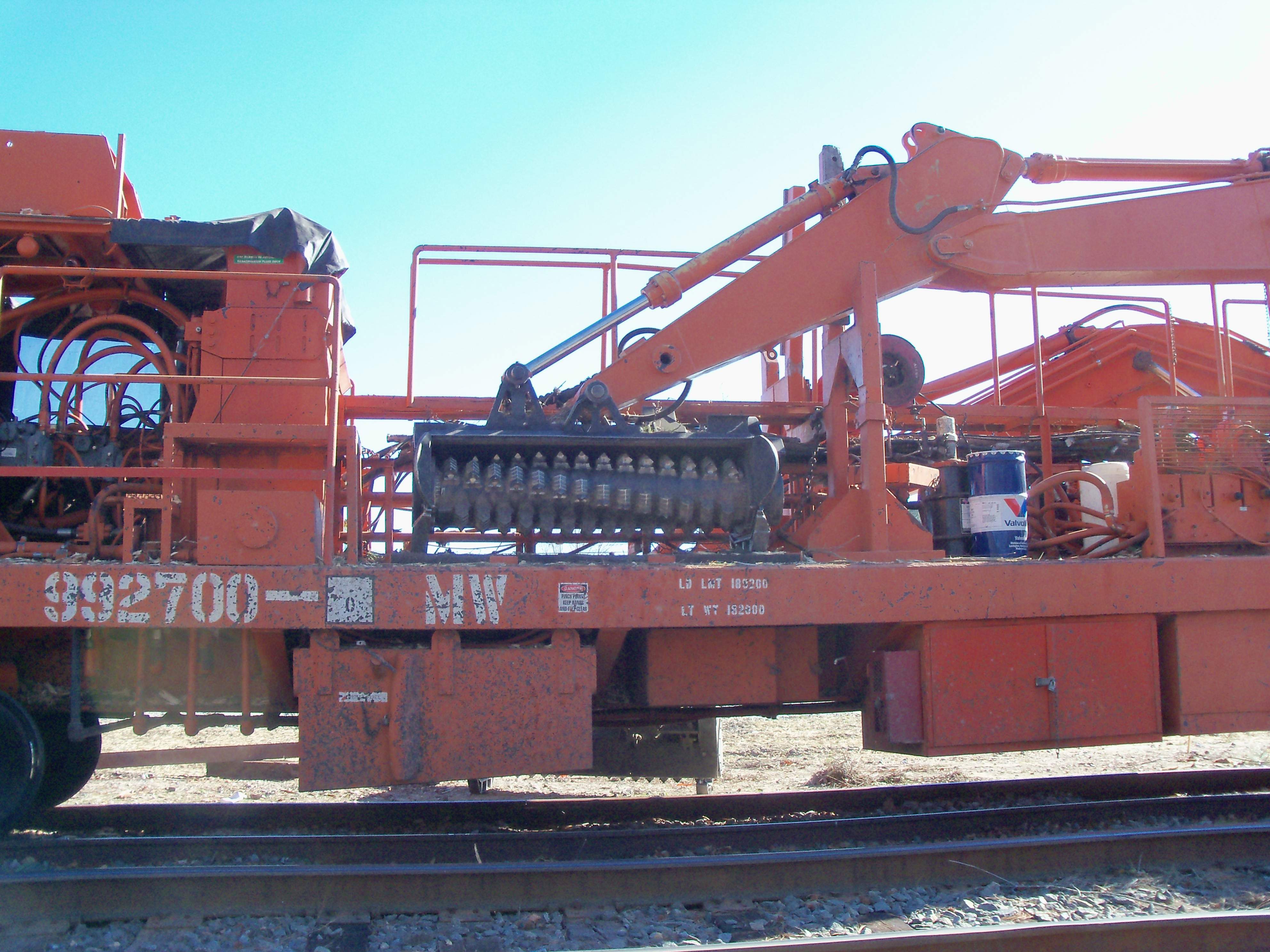

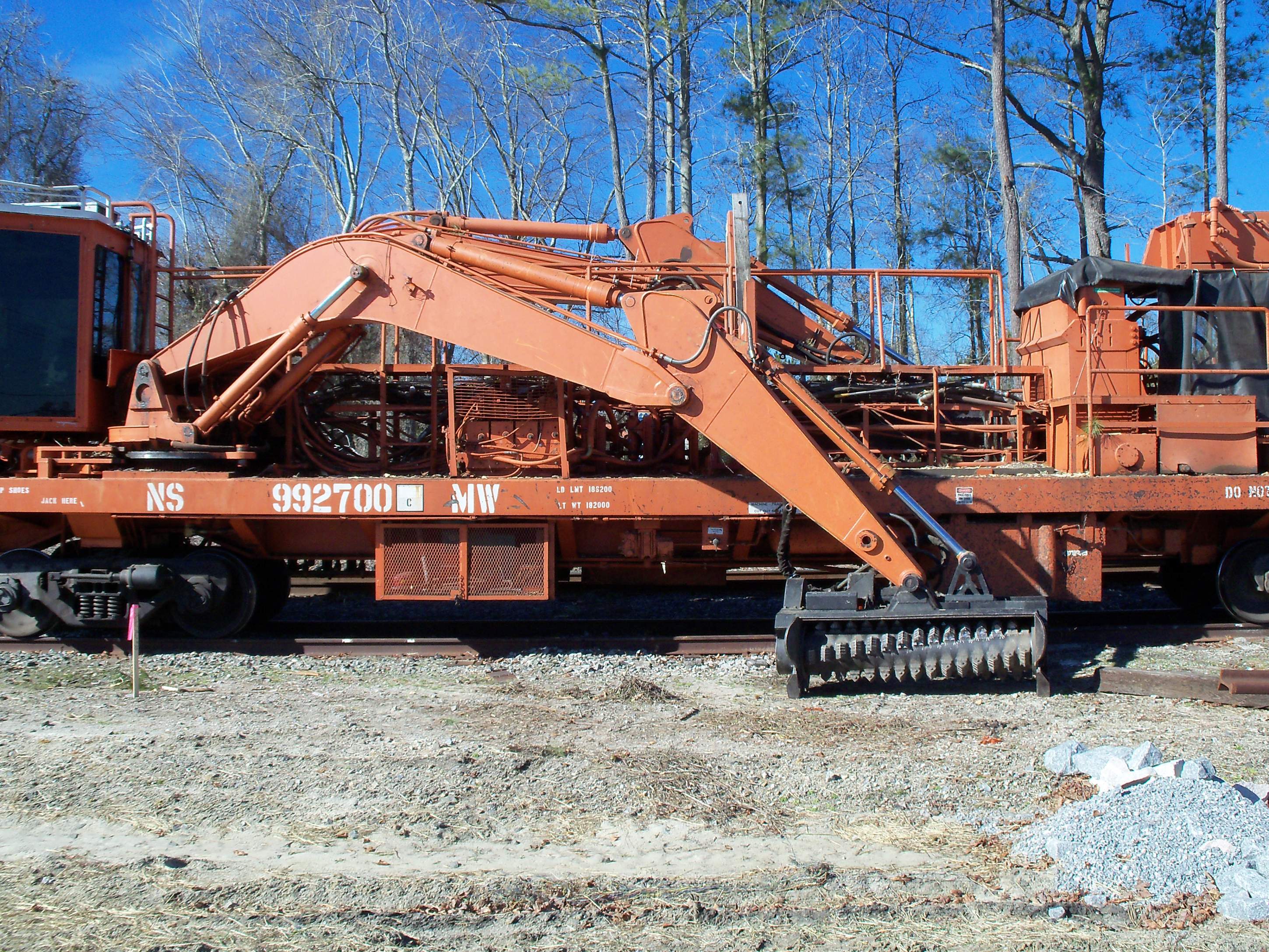

What about this setup? You could clear both sides at once.:thumbsup:
