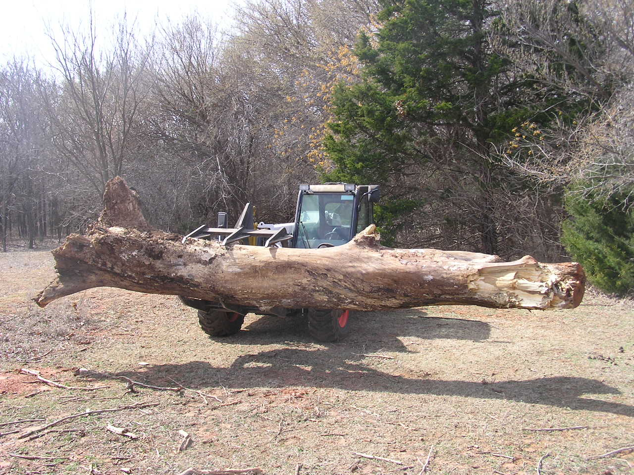

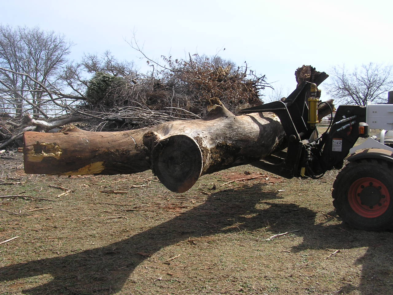

One compact telehandler is all you need. There are many brands to choose from.

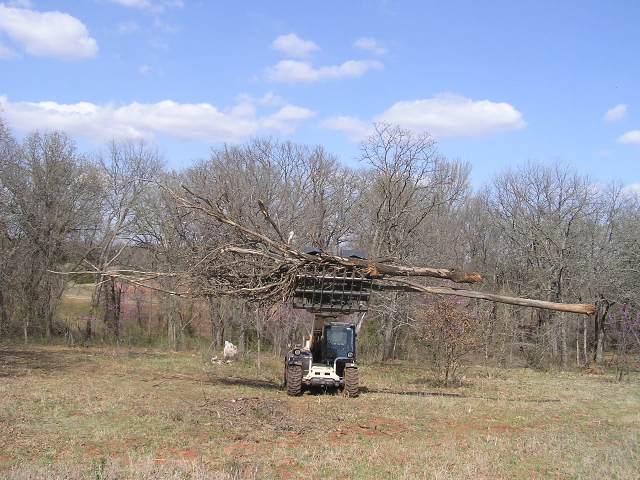

The Kubota is fine for moving logs,
This big?

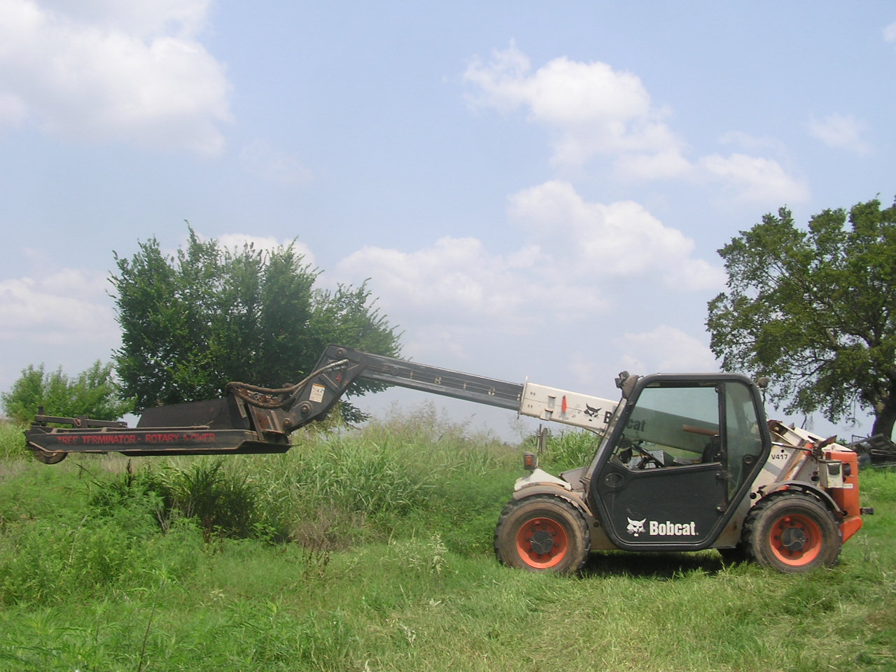

bush hogging,
This is a 7' brush hog, so much better out front:

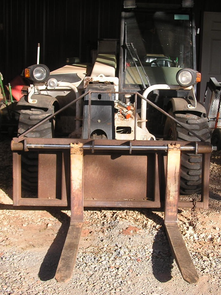

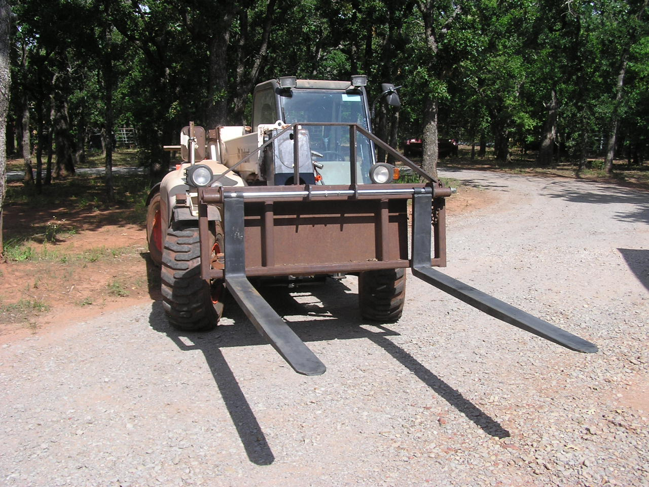

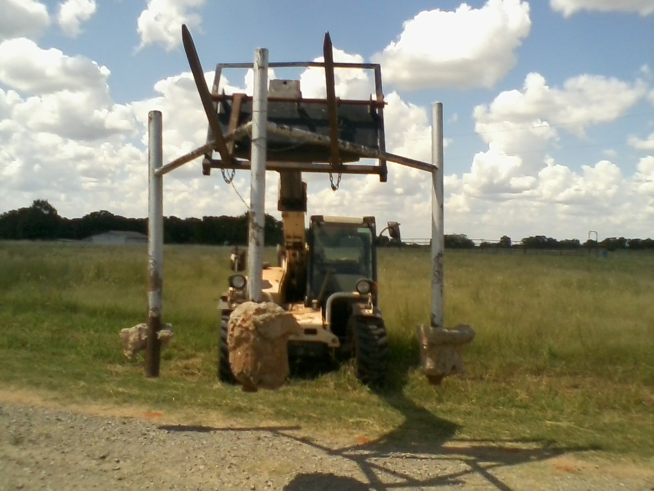

and doing little forklift jobs.
42 inch pin top forks:
48 inch block forks:
6' heavy duty forks:

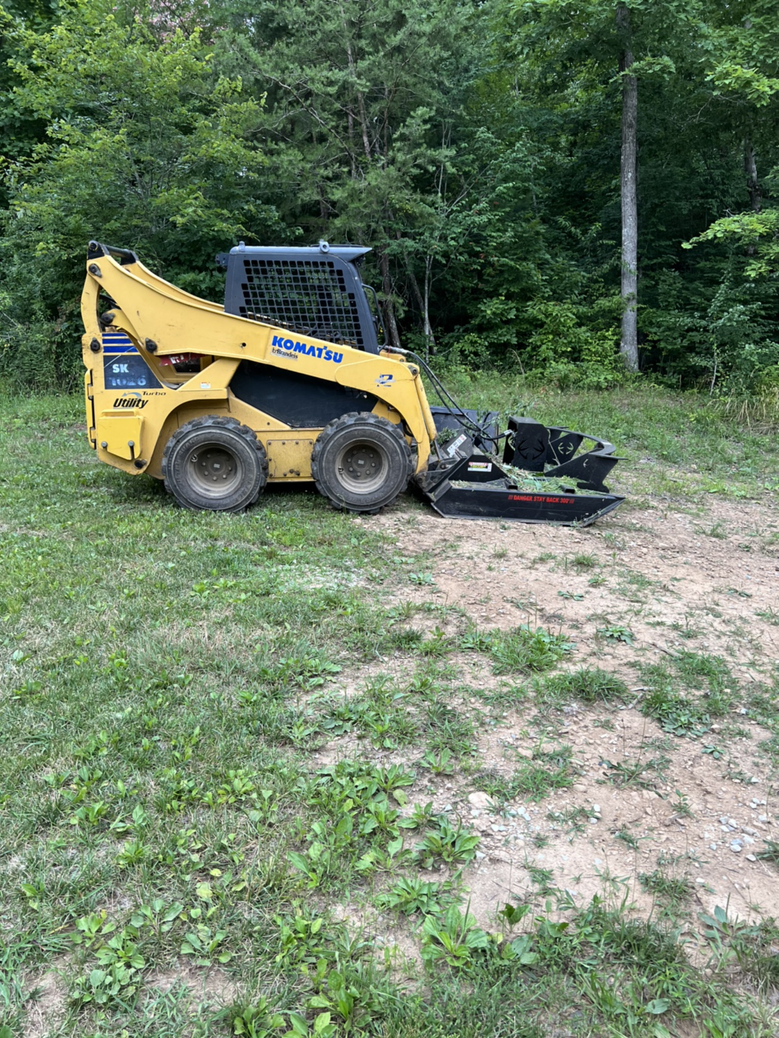

I like my skid steer mower you can really wreak some brush with it but for just regular grass cutting a tractor does a good job while using a cheaper machine. And a tractor of the same hp could pull at least a 10’ mower probably more.

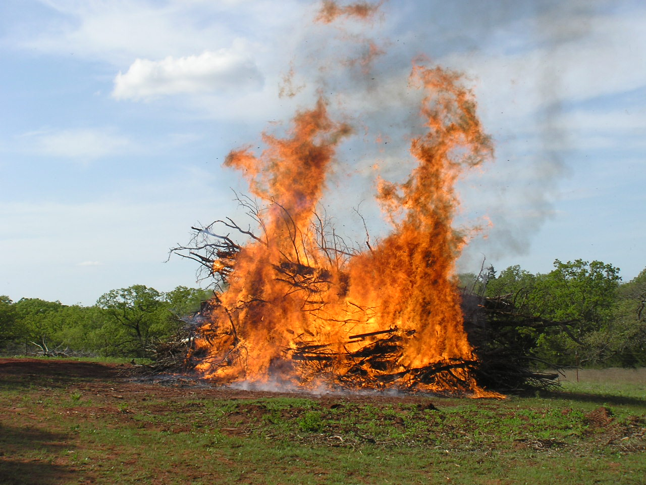

The fattest logs I have to move are under two feet at the base. I always cut them up and take a few pieces to the burn pile at a time. I suppose I could save myself a lot of sawing if I could move bigger pieces, but I don't know how well they would burn.

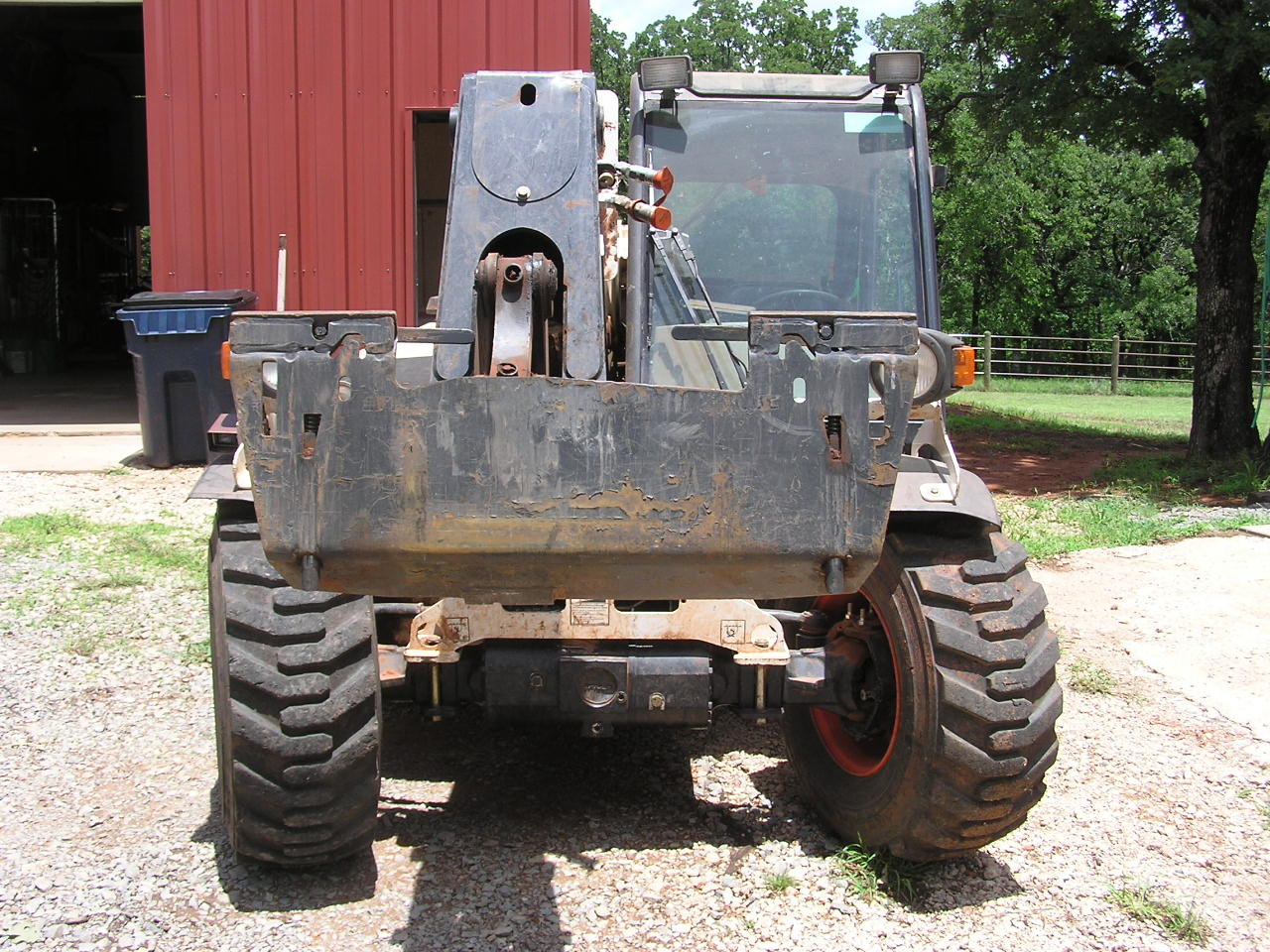

I don't like grapples. When I bought my Kubota, it had four forks attached to the bucket, and I got used to them. They hold lots of brush, and you can force them under things. I have seen a lot of tractors with grapples, and it seems like they always held less stuff than my forks, weighed more, and cost more money.

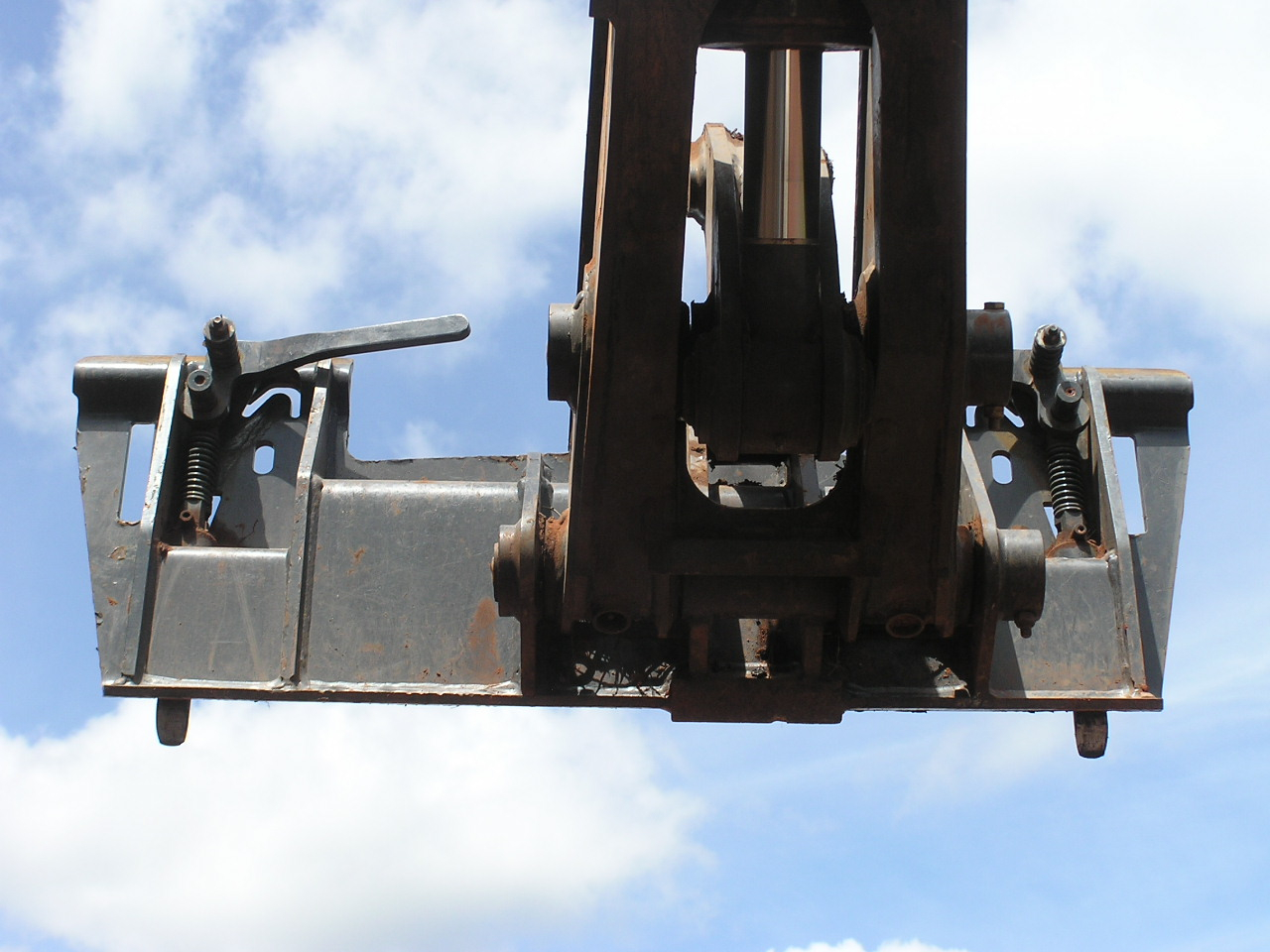

How do things attach to a telehandler? Do they comply with the SSQA standard?
Yes, especially Bobcat models since they originated it.
And stronger than tractor versions:
