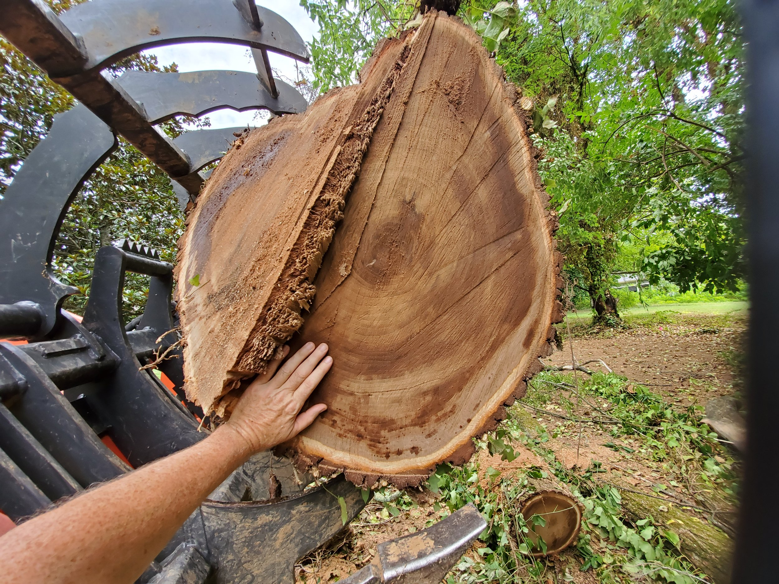

I would never undermine a tree of any size over 30-40 feet tall and then attempt to pull it over. Trees are top heavy and if you undermine it may choose to go where you don't want to to go. I have seen a light breeze act on a fully leafed out tree and push it uphill. A tree in full leaf is a big sail.
My preferred course of tree removal depends upon tree location relative to things that could be damaged.
If near house or other expensive things then tie tree off by placing strong rope ( capable of at least 1000 Lbs WLL tension) high in tree for leverage and placing some tension on tree so it now has a pre-determined direction to fall in when notched and cut with chainsaw at 4 feet.
If away from expensive stuff then notch, cut, fell, and dig out stump.
I have attached pic of Siberian Elm. My hand is 8 inches from finger tip to wrist. The long dim on this tree, 4 feet off ground, was over 40 inches. 8 feet of trunk was over 3,000 Lbs. Total weight on tree was 18,000 Lbs.
ps. I have also seen the tops of trees snap and come down on top of person / equipment when the tree top or branches are weakened or dead and they snap due to pushing and pulling. Instant widow maker.

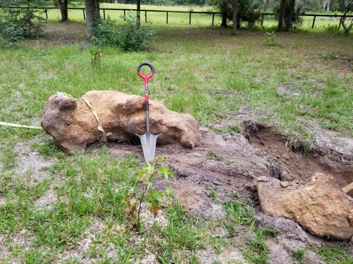

The Kubota has been marginal for moving rocks because it has a low lift capacity. It can't dig narrow holes, so removing dirt around rocks and stumps is not practical. It would be neat to have a machine that would dig around these things in a hurry.

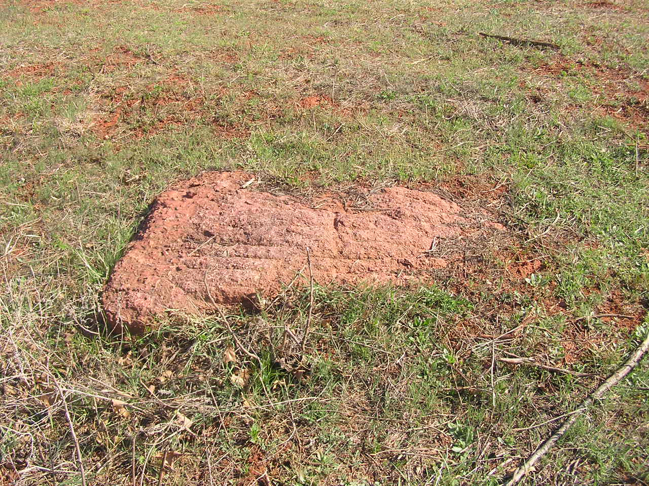

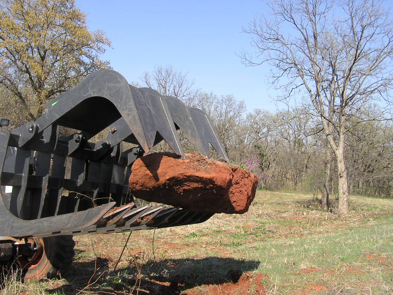

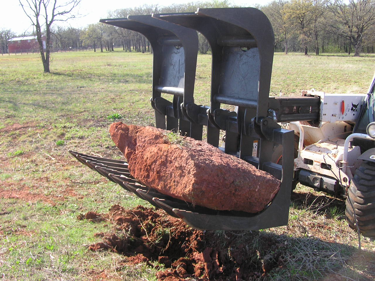

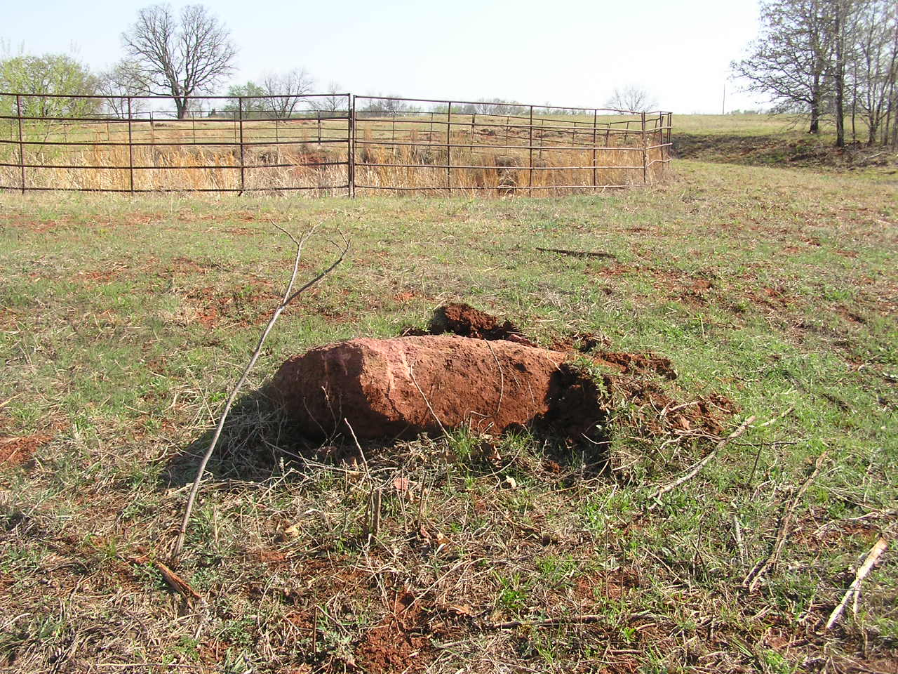

How big are the rocks?
I popped this rock out without digging around it:
   / Excavator v. Skid Steer for Hobby Farmer?
#37
I'll repost a photo I put up in another thread.

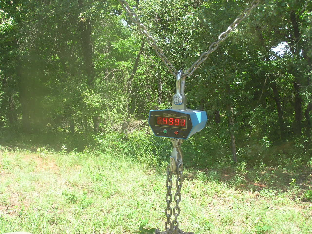

I am guessing that is about half the size of the one above.

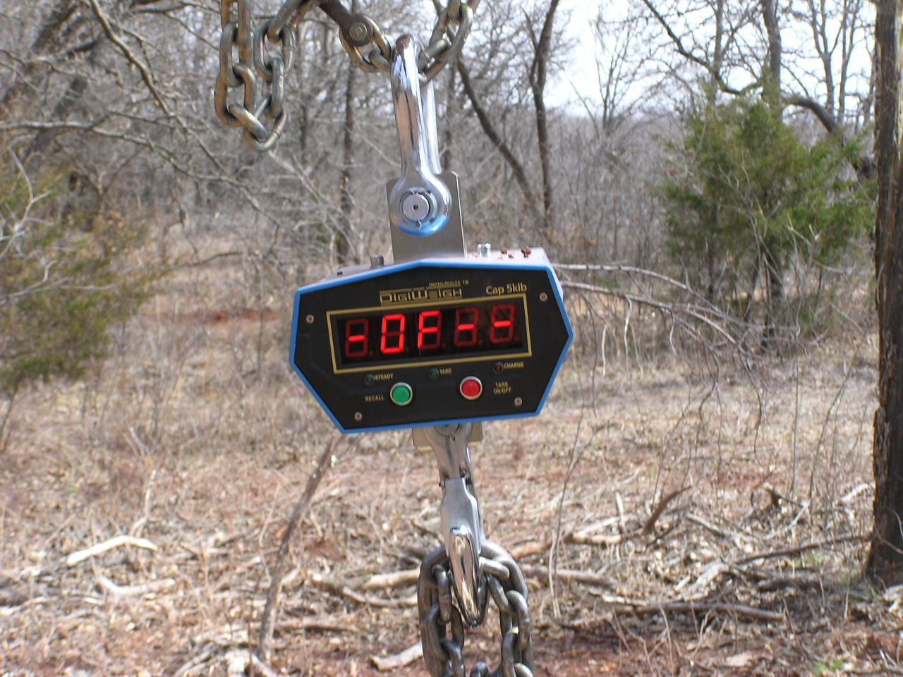

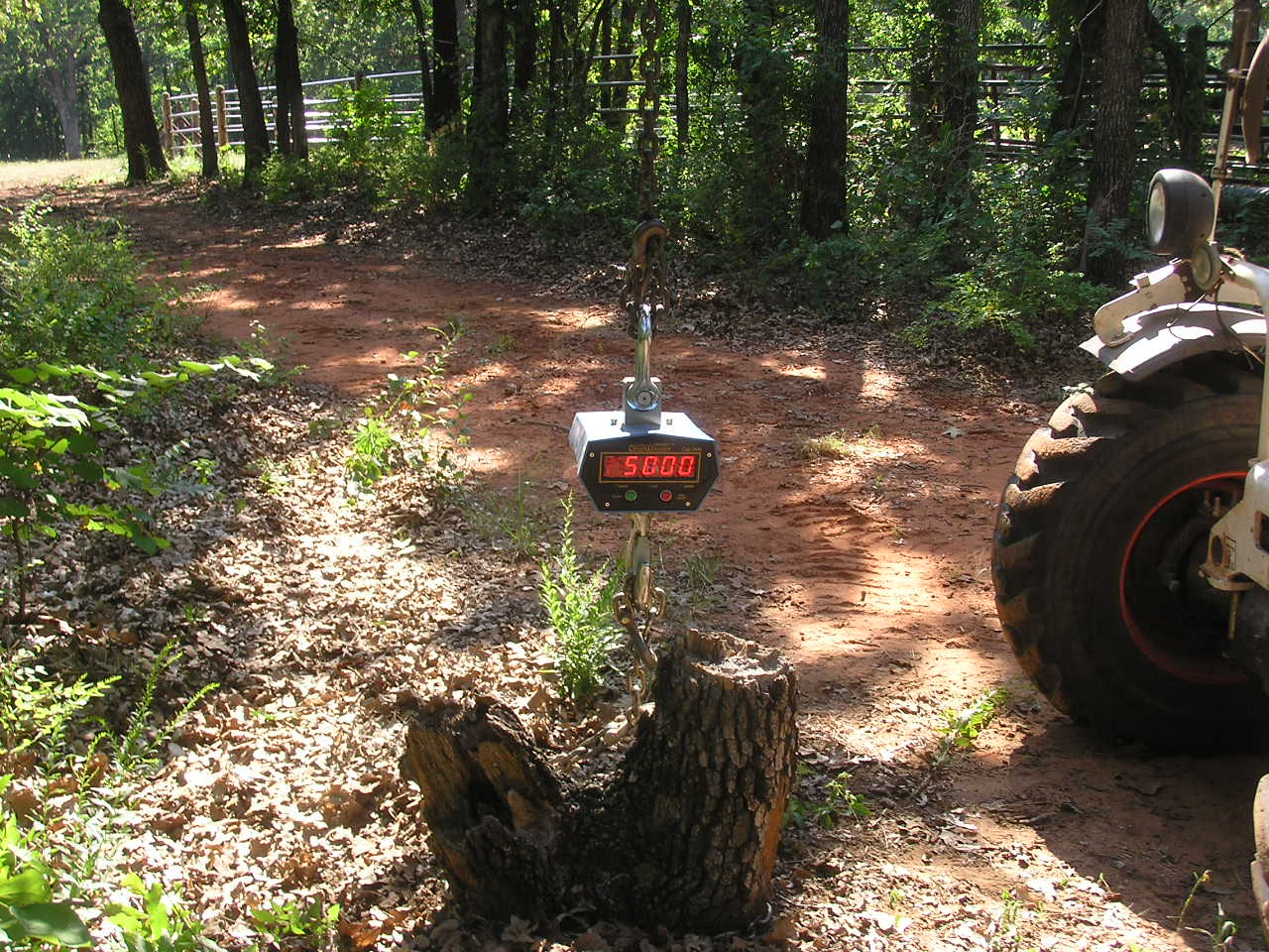

I have a 5k crane scale. Tried to measure lift power, but the scale goes to overflow if over 5001 pounds:

xfaxman,
Thanks for the pic of the crane scale. You just provided an answer to a problem I have been trying to solve.
