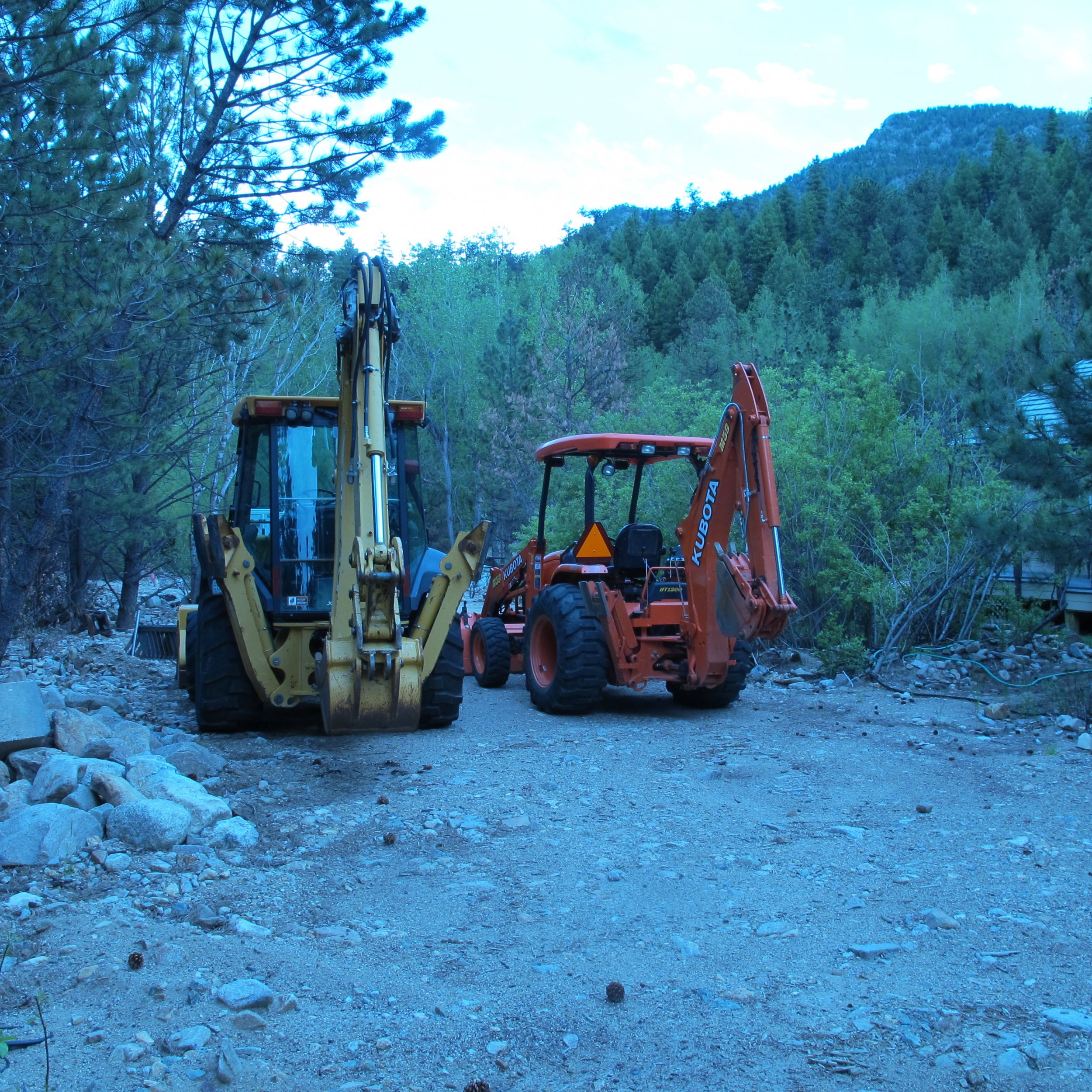

So what's the better second machine for a gentleman farmer who doesn't grow anything but needs to dig and move stuff?

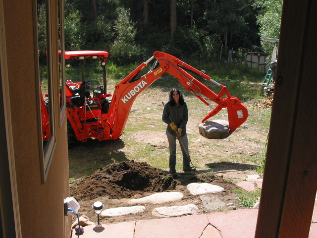

THe question you ask is one we hear a lot. Like a lot of TBNers we find ourself doing more land maintenance and landscaping and little traditional farming. For us, lifting and digging - and especially a hoe with a thumb - are what we want.
It might be a telehandler, excavator, or skid steer.... or it might be a mid-size TLB. The TLB is the solution several of us have come up with but they aren't as well known as tractors. A TLB is a purpose built machine and made much heavier than a tractor with BH & FEL accessories. On a TLB the 3pt hitch is the accessory, not the FEL or BH.
Construction companies are well aware of TLBs, it's the common yellow "backhoe" you see on every work site.
Kubota is the only company making a homeowner type mid-size TLB, but luckily they make a good one in 3 sizes.
rScotty

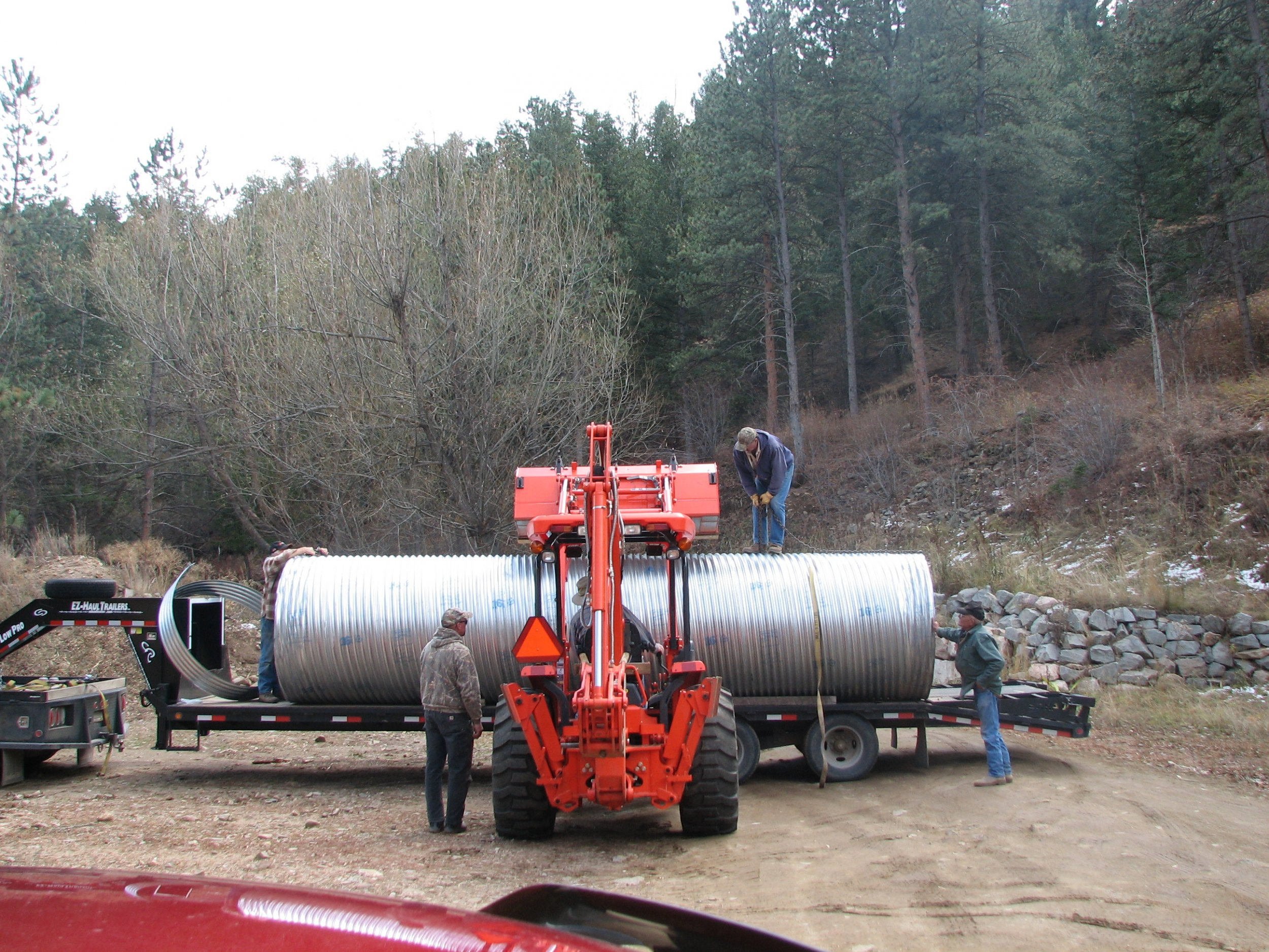

   / Excavator v. Skid Steer for Hobby Farmer? #25

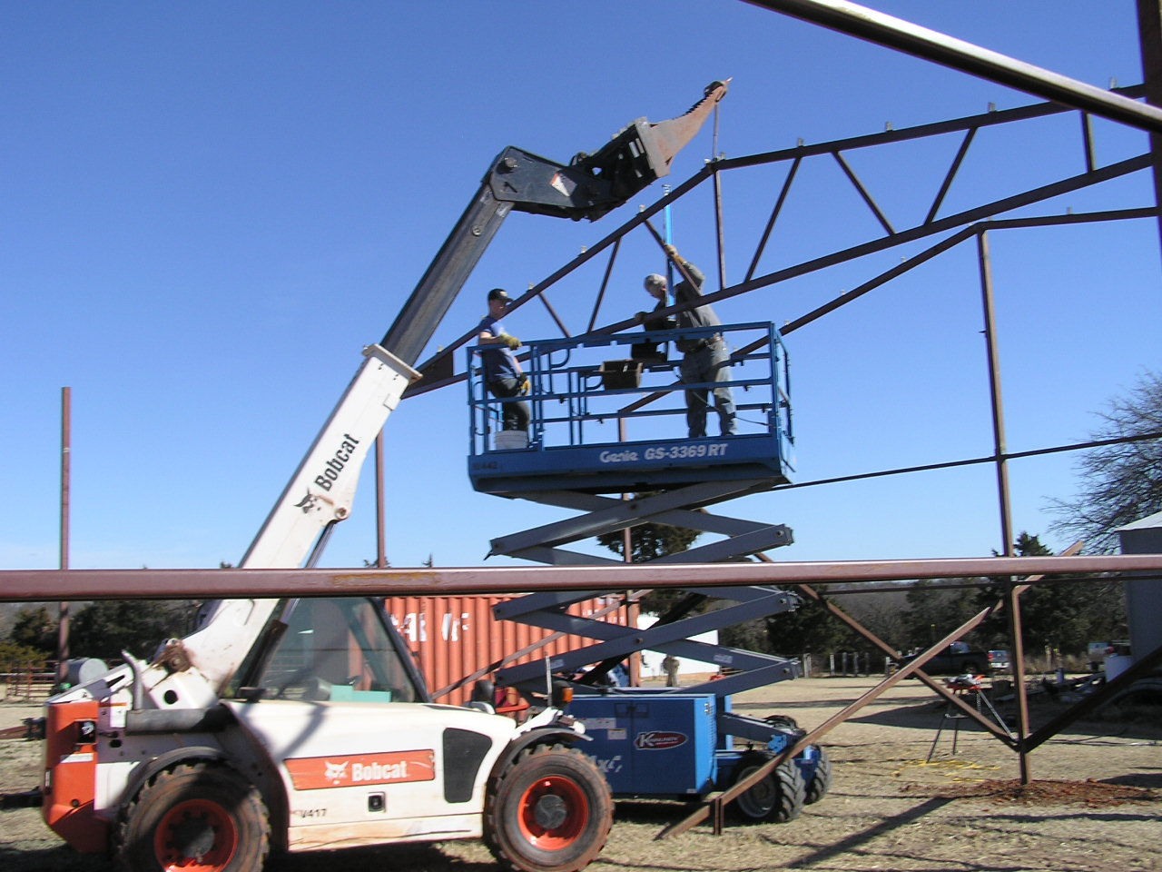

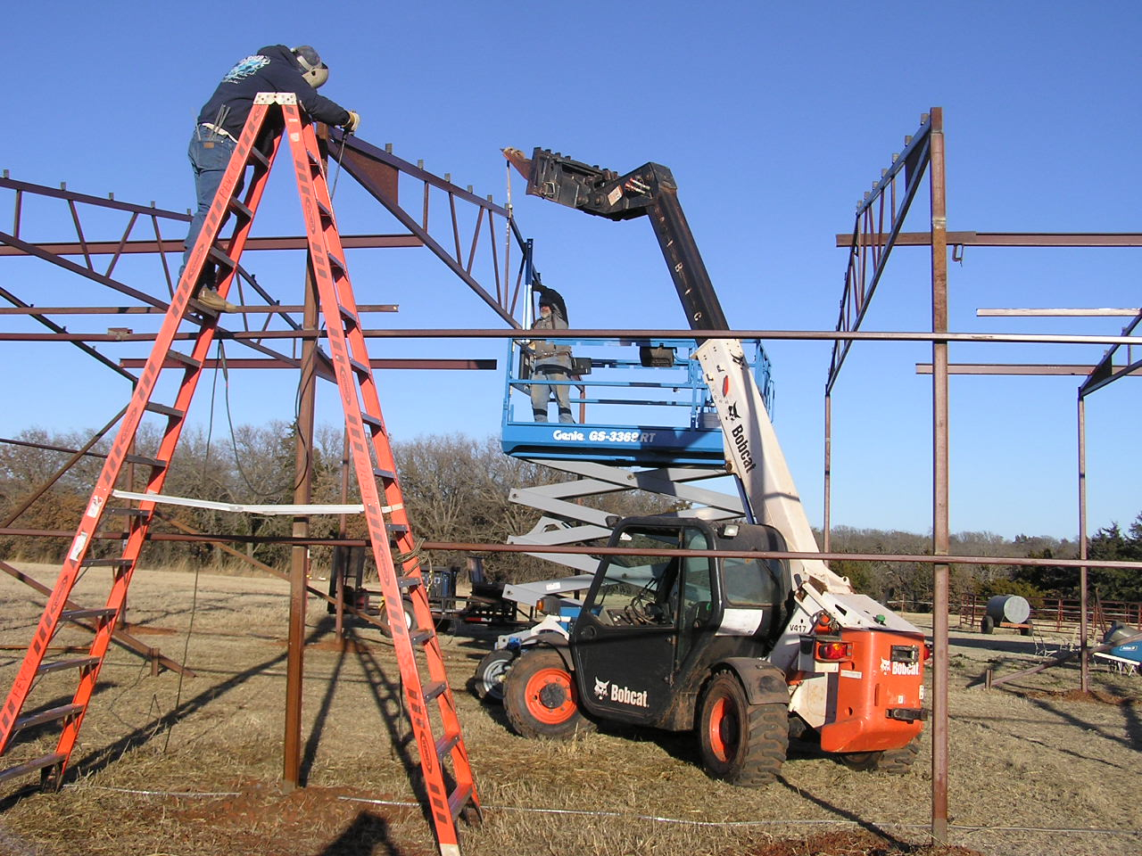

The compact telehandler looks like a great option if you are into house construction and need high lift.

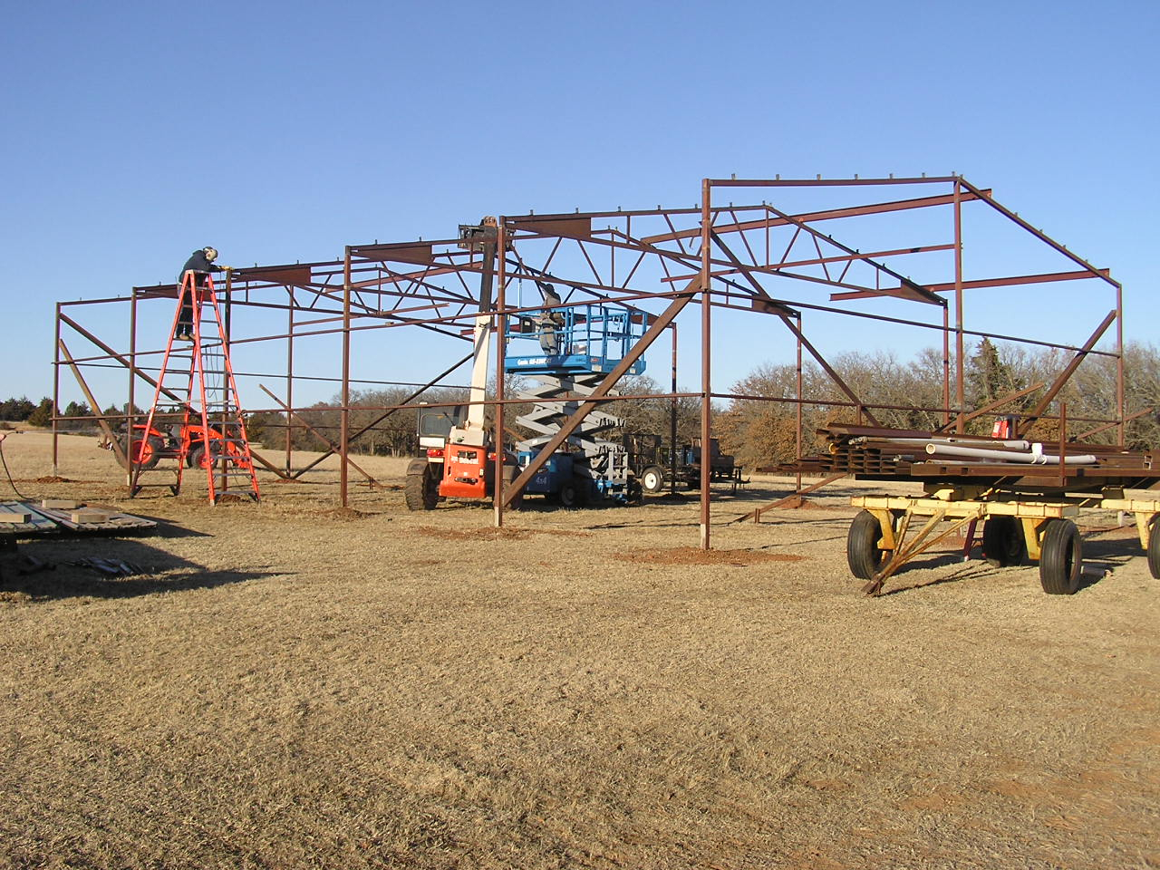

Not into house construction, but lifted the 40' long steel trusses for a friend's 40x60x14 equipment shed:

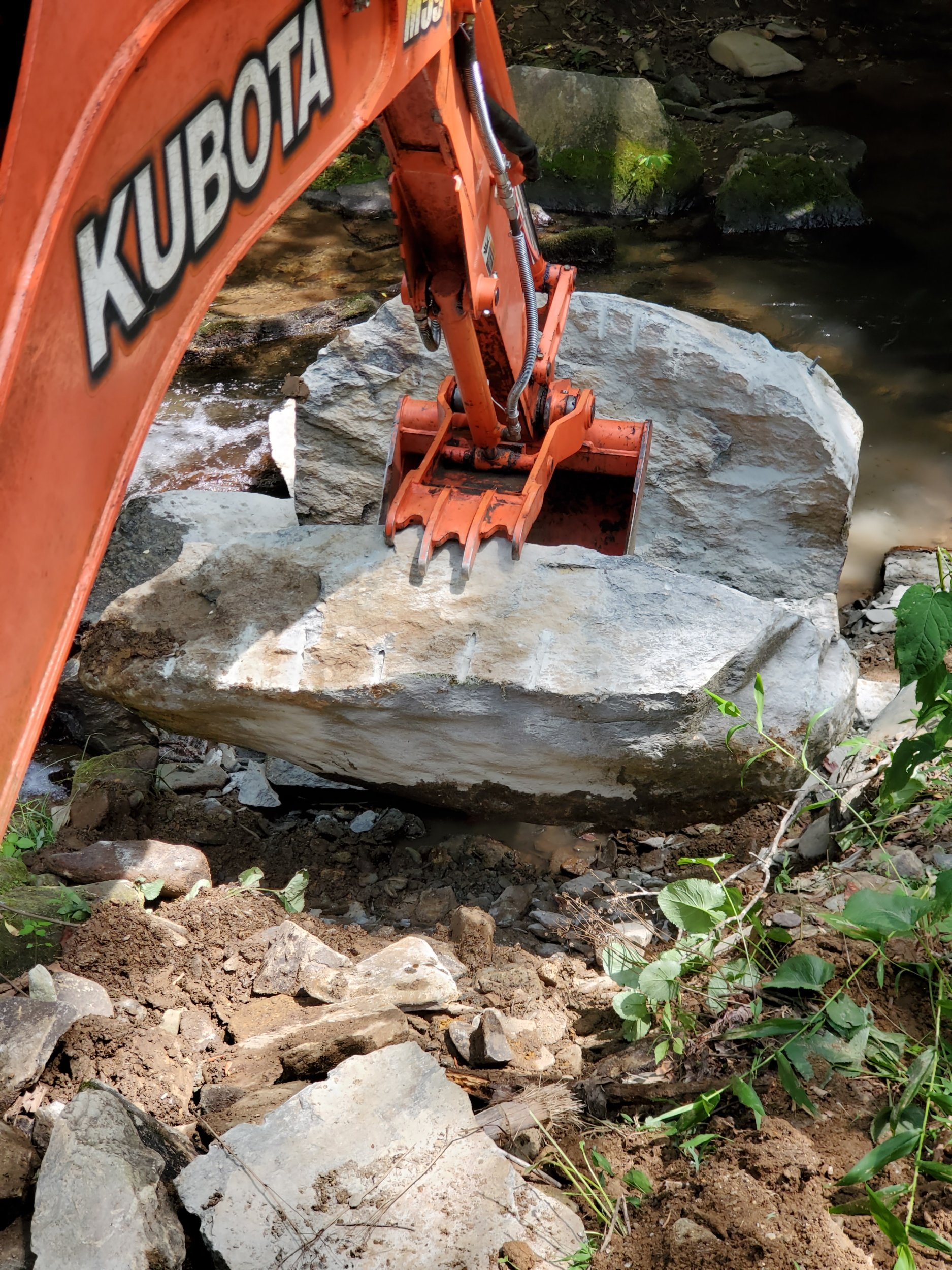

If you plan on breaking rock, like below pic, with wedges and feathers then plan on buying twice as many as you expect to need and have 2-3 wood splitting wedges handy to really widen the cracks since the rock splitting wedges wont create big enough seam to get hoe teeth into.
Also plan on a rotary hammer with a few spare carbide tipped bits because bits do twist off near the cutting head. You will also ned a generator to power the drill unless you have a 4/0 power cord because the 1255 draws a lot of amps. Attached pic is a 15 ton rock split into 2 ton parts and moved out of creek bed to provide for less turbulent water flow.
This was 6 hour job.
