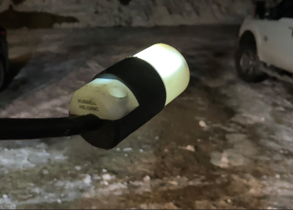

the heater cord jacket got weathered and cracked on my old truck and combo of wet and road salt would sometimes cause the GFCI in my garage to trip. I eventually replaced the block heater cord but I also wired a light into the connector so I would see power at the truck. They sell cords this way too, but I'm too cheap
